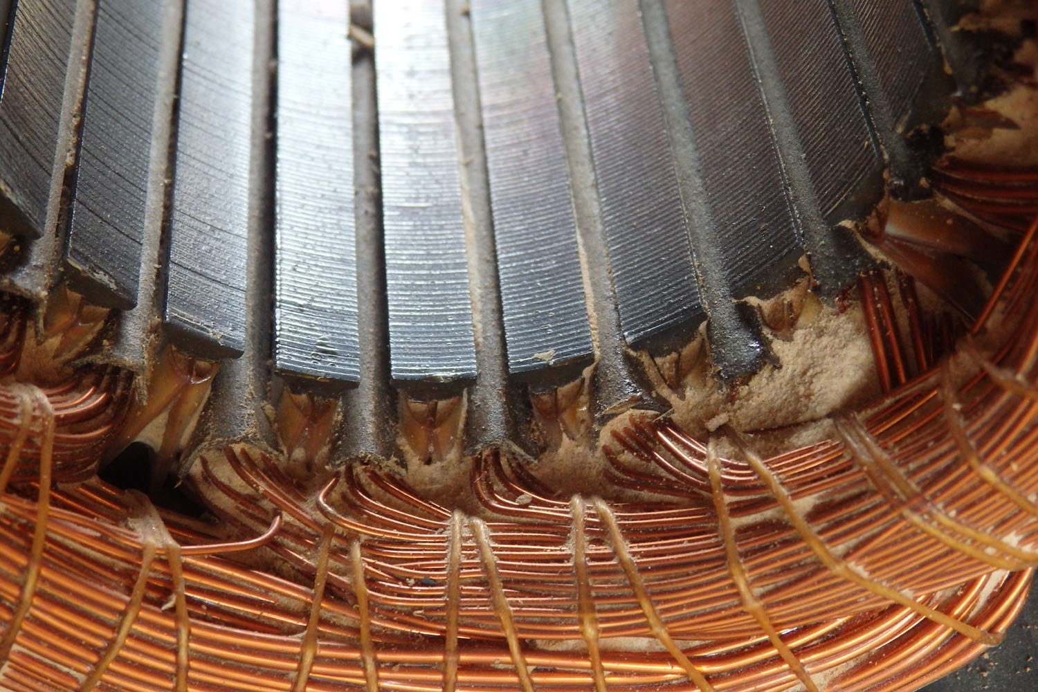

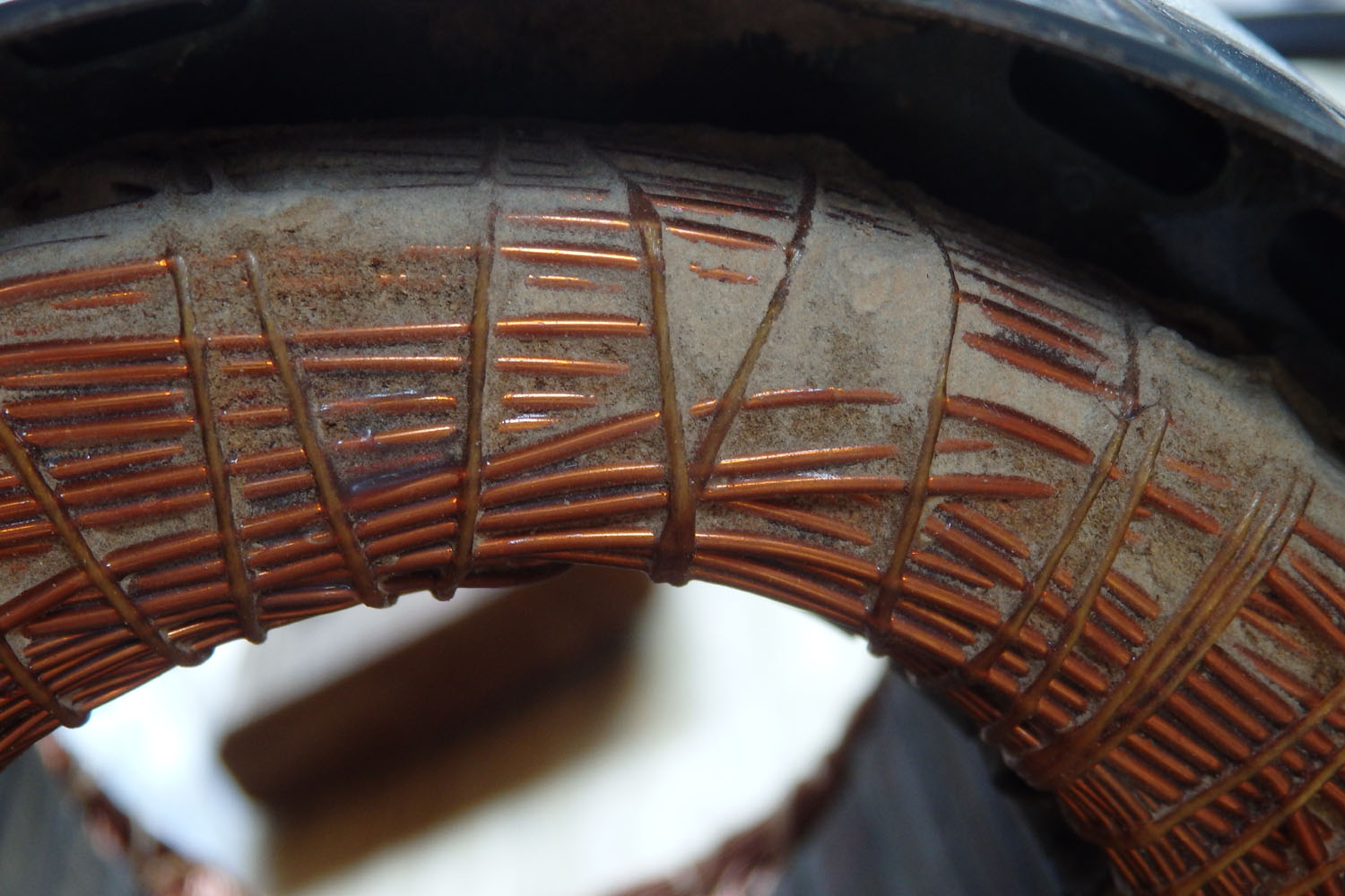

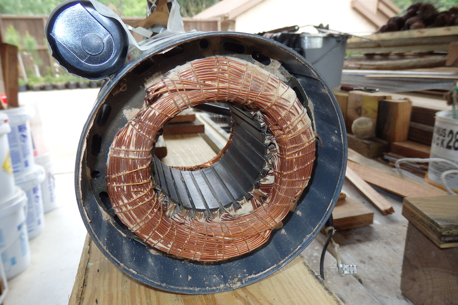

A good blowing out with compressed air and some careful brushing with an old toothbrush is what I have done several times over the years, usually after the motor fails to start. I usually just access the easy end, but if you have already removed the fan sheave then you can attack it from both ends. Just be careful and don't let the armature slide out unexpectedly and damage the centrifugal starting switch (if yours has one like mine). Attached are some before pictures of the last time I had mine apart for cleaning.Ericthet wrote:While the motor pieces are apart any good suggestions on what to clean? There is a decent amount of dust build up on the windings so I am thinking a spray of air and vacuum to clean.

The windings look to be in excellent shape. I would replace the control sheave as the most expedient thing to do. Clean the centrifugal switch and put a VERY small amount of light weight oil on the pivots. As long as you have it open replace the bearings. (cheap) If some of the parts are on back order check with Bill Mayo on this forum he may have what you need.
Bill V
PS You will have to replace the porkchop on the speed control. The arms of the speed control do not look too bad from what I can see of it.
