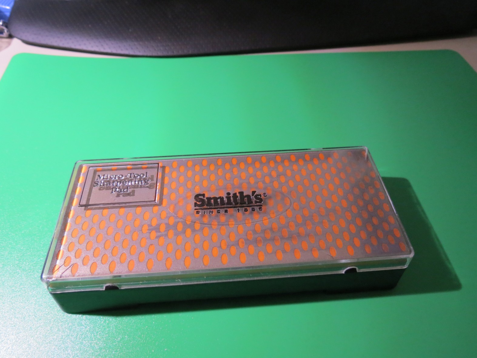

I wish I was having a love affair with my diamond stone. I got the Smith's orange one which is 750 grit. I did try it here but it is to fine to remove things fast. I guess I should get a couple of other grits to be fair. Better move them up the list so I'll get to try them on the next sharpening event. No use having the tools if you can't sharpen them.
I have some diamond paddles which I do like for doing touch ups on everything from drills and router bits to pen end mills. Got a set of 3 in a package deal but they are only for touch ups.
