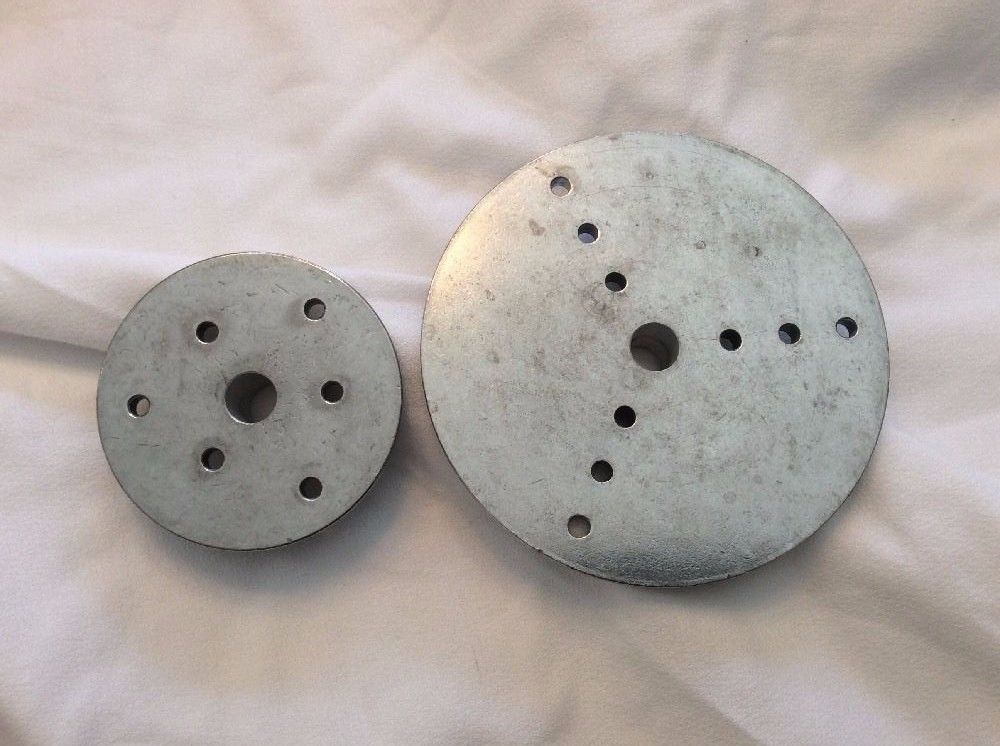

Based on what you said you have, you will need the drive center which you drive into the wood (off the machine) and a center for the tailstock.
Also you may wish to have a faceplate for faceplate turning for bowls.
Lathe FacePlates.jpg (99.68 KiB) Viewed 4648 times

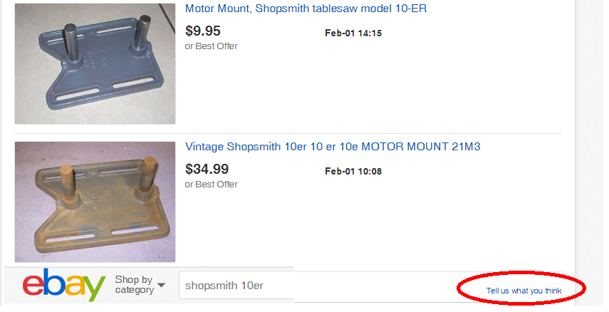

But like everything on eBay.... prices vary widely.
Trivago for eBay... anyone
Everett
You want to watch pricing on eBay.png (165.78 KiB) Viewed 4646 times

"Tell us what you think". Hmmm, One is a rip off and the other is priced just about right. Do you think they would like that???
