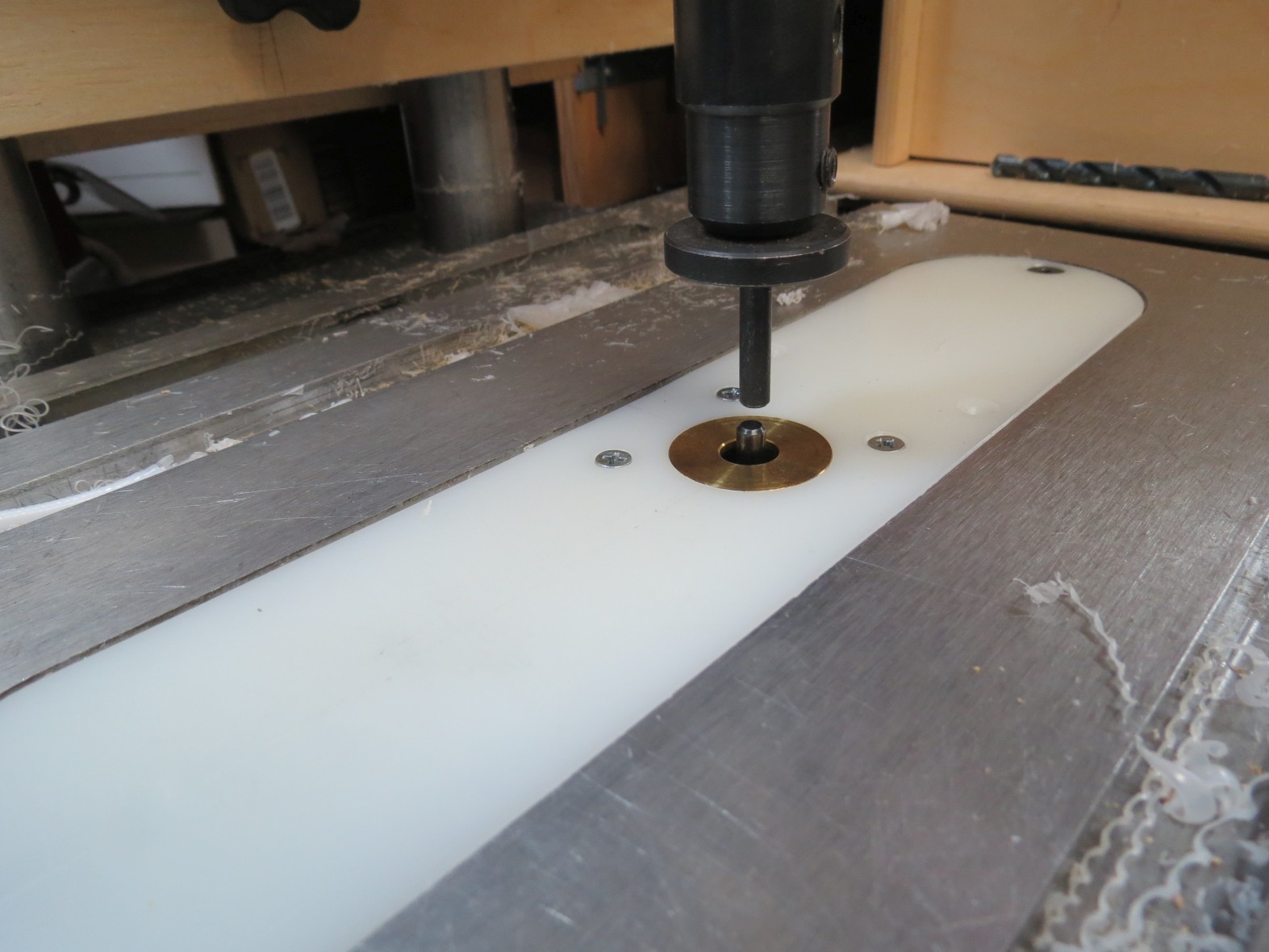

By aligning the router to the headstock when building the table insert it stands to reason that I could then align the two once built. So the two would look like this:
An alignment pin in each one can be used to match up to each other. If you were to mess with the alignment of the table at some point it is very likely that you would need to make another table insert to reestablish the alignment.

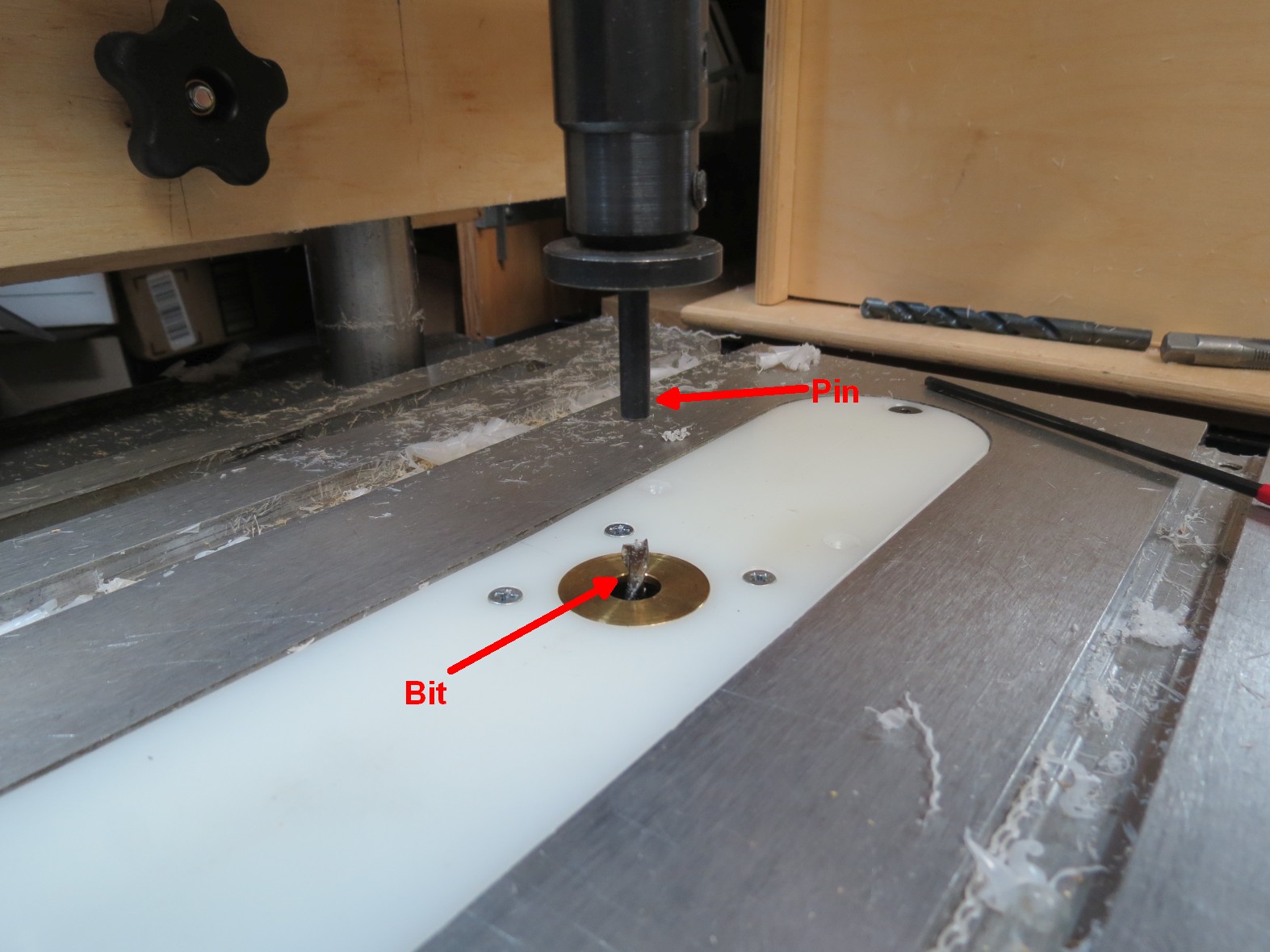

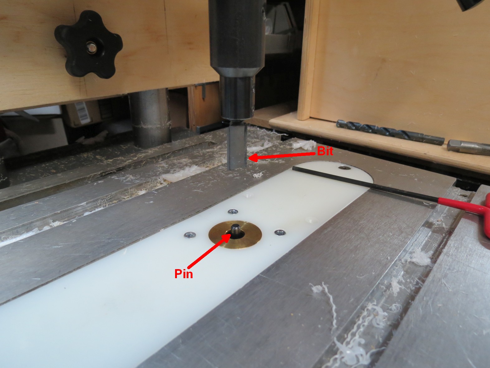

How about because then you can have a pin router with the pin on the top or on the bottom. At this point all I have is 1/4" pins but with some brass stock one could turn the 1/4" stock to say 3/16" or 1/8"........ 1/16"???
So it might look like this:
or
With the pin located on the bottom then you can use it for pin located drill as well.
So this should give you some things to think about.
