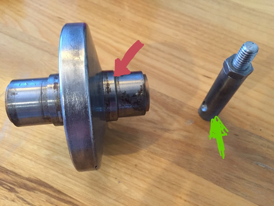

gurrenteed wrote:Quick couple questions:
First, I think I screwed up. This is the pulley assembly from a speed changer. The fixed sheaves have been removed because the floating sheave is frozen. I'm assuming that the sheave moves where the arrow is pointing, but wasn't 100% sure. I initially began soaking it in PB blaster but then found a manual that said to soak it in paint thinner or a solvent... Then I read to "NEVER loosen the special size set screws". Oops. How bad is this?
Second, what is this little part on the right?
I appreciate any info you guys have on this.
https://drive.google.com/open?id=0B5oxA ... UpuWGR6V1U
It is not bad at all. In the speed changer manual under "Care of your Speed Changer" it does say never loosen those screws. On the last page of the manual under "Trouble Shooting the Speed changer" it says if the distance between the outer sheaves is greater than 2" loosen those screws and set the sheaves to 2".
When I refurbish a speed changer I always completely disassemble it and then set the sheaves to 2" when I reassemble it.
As for the item on the right I don't know. It looks like the carriage stop rod except I have never seen one with a dimple in it. All the ones I have seen have a screwdriver slot in the non threaded end.
Ok, great. That helps a lot. I have most everything figured out except for just a few random pieces. Some of it was just random junk parts that my grandpa saved with the shopsmith stuff for some reason. This looked like it might be part of something that he no longer has.

Soaking the speed changer in paint thinner or solvent pertains to removing "belt" dust and dried or gummed grease. Keep soaking it in the PB blaster or kerosene, etc. for freeing a frozen part.
Just give it time to do the job. I've had many speed changers which were froze up and with enough time, it will free up. Don't rush it and start beating on things... I've had a few which took 8 to 10 days to free up.
As John mentioned with the special set screws, it's no problem. When I acquire a new speed changer, I completely disassemble them too!
The part on the right is for the A-34 Jig Saw, it is the Saber Saw Support, part number 134-13.
