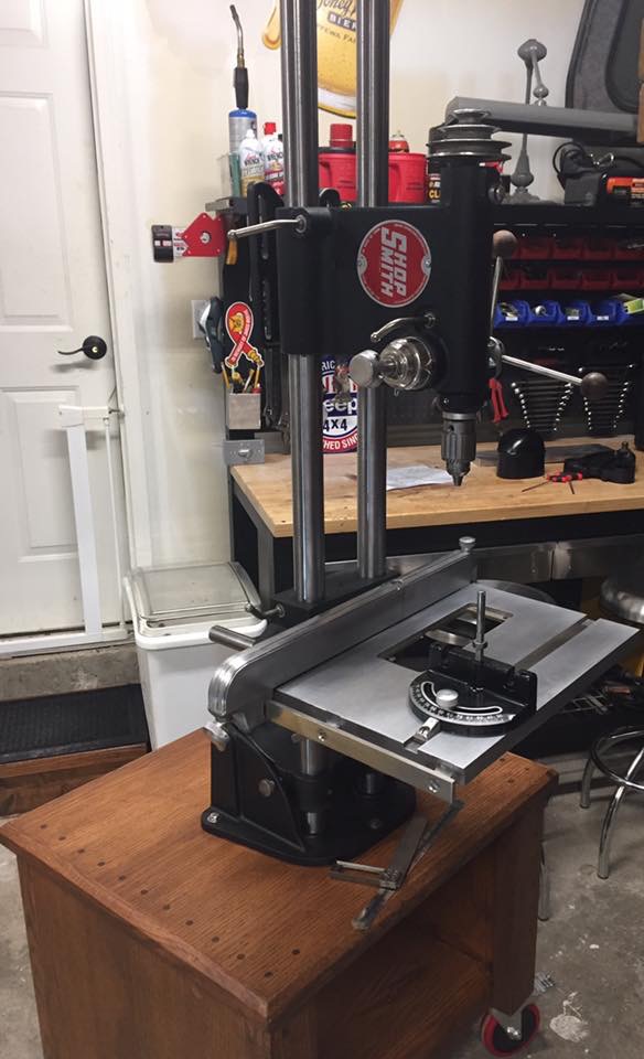

Re: Reassemble a Shopsmith 10er
So I have a few broken or less than perfect parts on my 10er. I've been searching for parts and I found a cheap 10er locally that's in better shape than mine when I got it. It has a speed changer and all the basic pieces plus quite a few extra parts I wouldn't mind having.
I set up a deal with the guy to take any or all parts I want for $75. I would easily spend this on eBay trying to buy the parts I need. I imagine he will just scrap what I don't take, which brings me to my question: Should I take things like the headstock, headrest, way tubes, and base plate and sell them? Is there a need for these things? I'm not looking to make any money, just don't want to let something go to the scrap yard that someone might need for their 10er. I guess I'm thinking that those parts are so heavy that shipping would be a fortune. Would it be helpful to sell these kind of parts for the cost of shipping or is it still not worth it?
Anyway, my 10er is coming together. I'm chipping away little by little but I'm getting closer. I'll try to attach a picture of it. Thanks again for all your help! You guys are awesome!
- IMG_0002.JPG (117.71 KiB) Viewed 9714 times
ERLover
- Posts: 3914
Looking very good. Yes it would be worth it for the parts. SC go for 150-175# on EBay alone.
