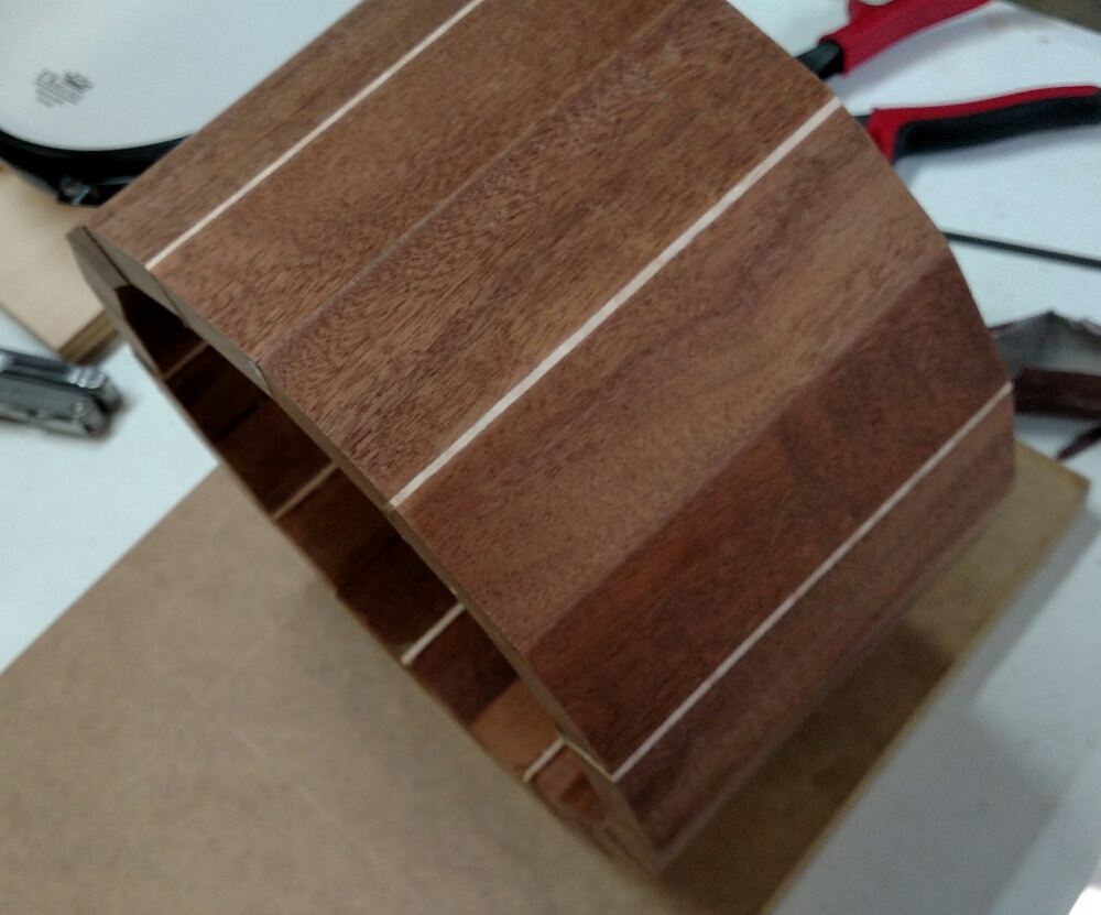

Latest project, ready to be turned and have bearing edges cut since this will be another stave snare drum. Wood is Mahogany and quilted maple as the dividers. Math and angles were not easy. Lol
- IMG_20170221_101602.jpg (215.11 KiB) Viewed 6157 times

My son, a high-school drum-line leader, just drooled all over my iPad.JazzLuthier wrote:Finally got a picture outside of the snare I made.

It is a relatively easy project if you decided to make one with his help. A deeper version might be heavy for marching. I can't say I recommend turning a 14" shell without a speed reducer. Anyway, if you want detailed info on that project, then just shoot me a PM.
