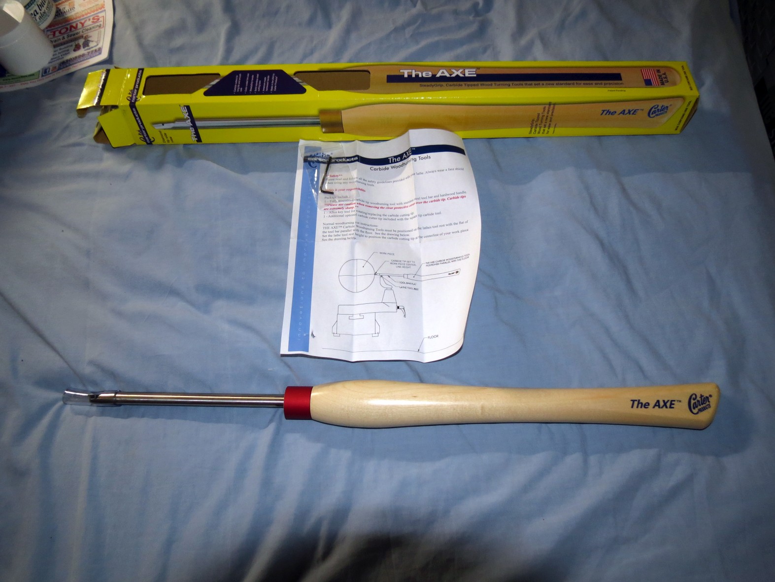

Who ever turn it was you didn't do well keeping me from spending money. I headed off to the Woodcraft store with my birthday 10% off card. I had a couple of items in mind as they don't always have something in stock. It was a debate with myself as to what I would get. This is what followed me home:
Hope to have a chance to use it in the next few days. This is close to the easywood tool I already own but with a couple of extra features. I like how it feels in my hand so I want to see how that translates in to how it works for me while turning.

Hey Ed,
I think you'll like the flat bottom surface on the bar. My Sorby Soverign system also has a flat bottom surface which makes it MUCH easier to always start the cut with the bit horizontal. I "think" yours also tapers up to a radiused edge so you can roll it to go to more of a shearing cut. The Sorby is a fixed mechanical so I need to loosen the collet, rotate the bit holder to a fixed 45 degree slot and then re-tighten. A bit time consuming, I've never tried to just roll mine into the shearing position, but I think yours might save time and effort plus better control
It should be fun!!

I too have the sovereign system. Due to how large it is I don't use it a lot since a lot of my work is smaller, well at least for now. The other problem I've had is that it can rust.... I've got rust to clean off mine, put some oil on to stop further progress but have not got back to it to clean it up. When you turn wet wood you really need to clean and dry the tool soon after, wait a couple of days and rust!
I have a couple of round bar tools and they are especially hard to handle. One just loves to catch, a fault of the carbide tip that has an aggressive lip arrangement. It really takes off the material but it almost always gets me. I use it for early ruffing only because of that. The another one is a small tool with a more flat carbide tip and it too is hard to control with the round, I find I don't use it much because of that.
The round bars do allow the rotation but lack the control I feel. I'm hoping the axe tools with the rounding edge and the flats on the handle will allow more control. Time will tell.
The easy tools all have square bars and are easy to handle but lack the rounding that this one has so it will be a new experience.

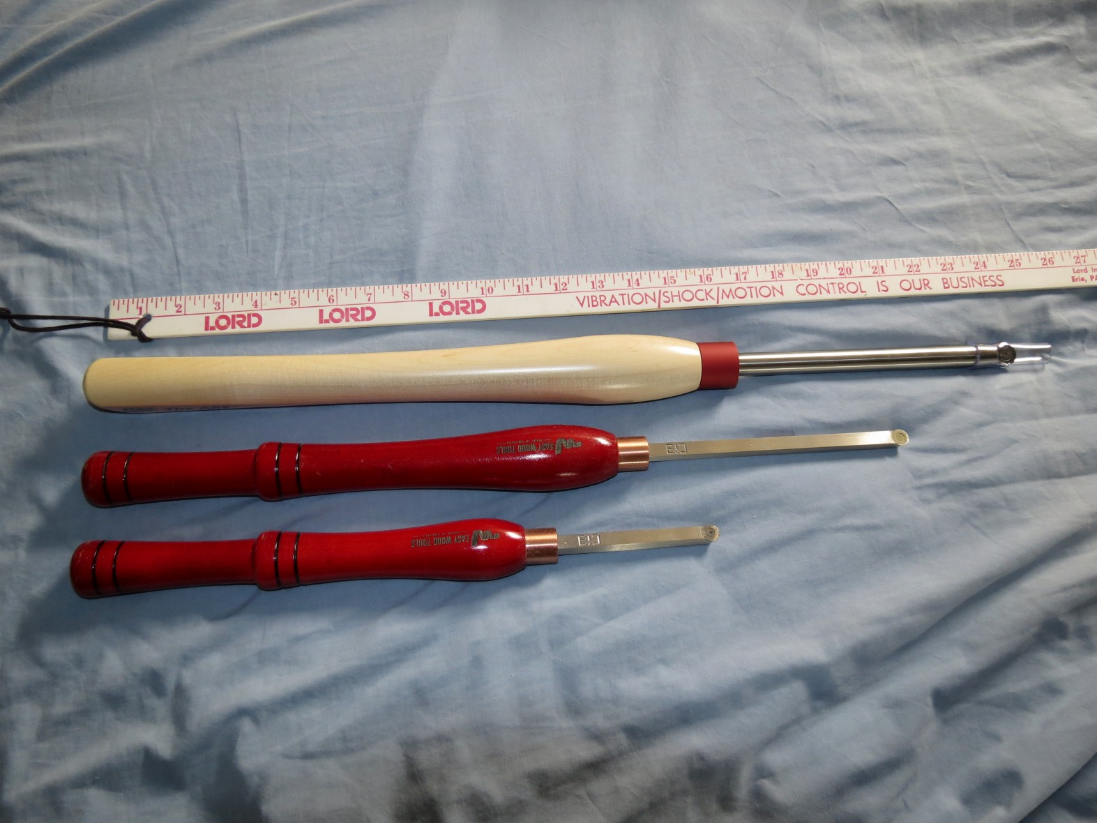

I have both the Mini Easy Finisher (6200) and the Mid-Size Easy Finisher (6300). The next tool I had been thinking about is the Full Size Easy Finisher (4200). One of those goes for about $130 and with a sale just over $110. The length is about 24-1/2 overall as a reference.
The Axe is about the same size as the Full Size Finisher. The price is a bit lower being $100 to start with and $90 with my birthday month discount.
Here is a picture that shows the three that I have of this basic design:
The Easy Wood tools use the handle color to identify the different tool types. The Axe uses the ferrules for that function, note the color they picked by accident???.
Now I think I read somewhere that the carbides are interchangeable between the two, having said that I can not at present locate that "fact". The size seems to be the same, 5/8" dia, and the thread is the same 8-32 so that is promising.
Now Easy Tool has a mark on the bar indicating the maximum extension from the tool rest, The Axe doesn't. The bar is very heavy duty stainless steel and no indications in the paper work on this subject. More research to do.
The Axe has a unique handle, round near the bar and with flats at the end. the Easy Wood tool have ones as pictured and I have no problem with them.
So there is the visual review.
