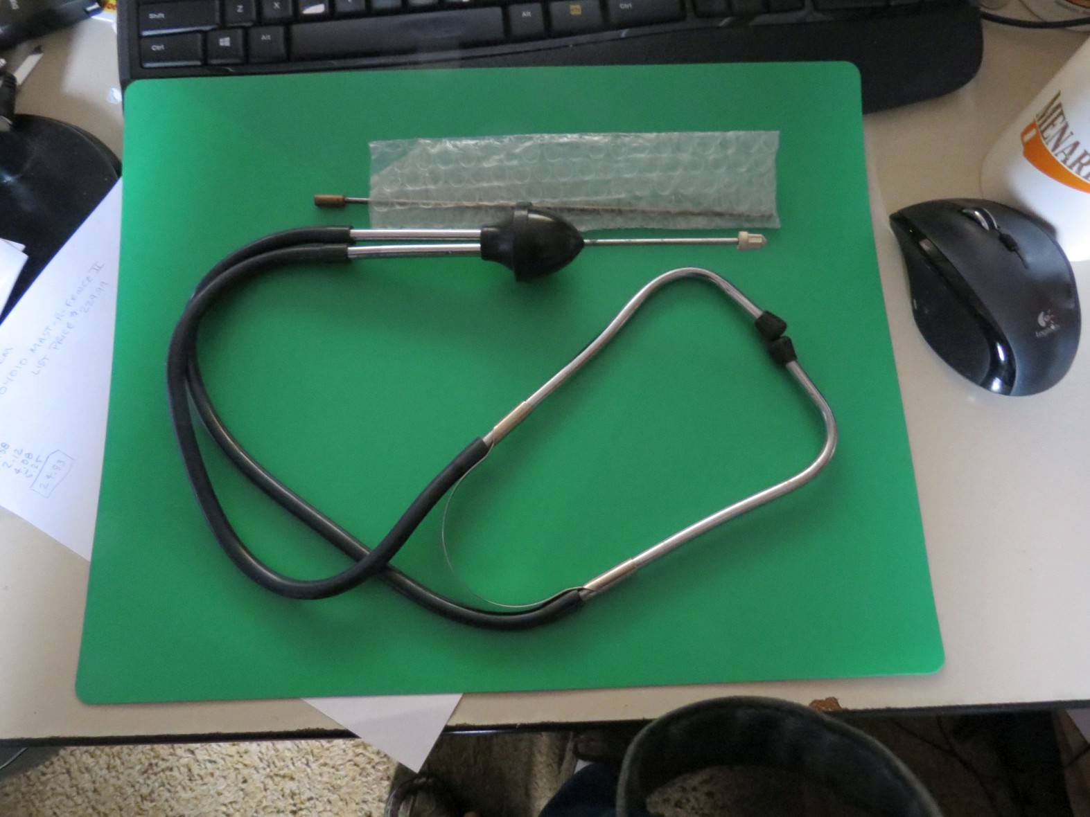

Re: Woodworker II blade
This is what I have. Got it years and years ago and as I recall it was cheap. It is in my cabinet of auto tools as that was what I got it for. Of course it works for just about anything.
A stethoscope is probably the preferred method in a wood shop. The wooden dowel or screw driver is some times difficult to keed in position. With the stethoscope, you have both hands free and you can look right at what you are attempting to meter.
