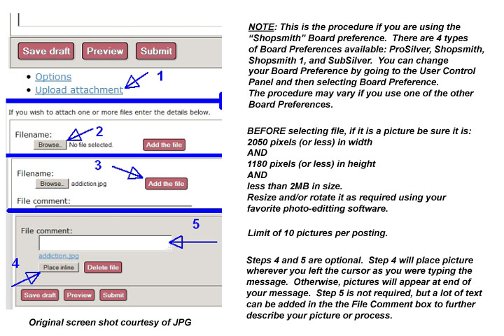

Attached is a PDF I downloaded from a previous post and saved, in case that is what you need.
Also, a guide on how to post a picture, in case you need help there too.

- How To Post a Pix.jpg (116.63 KiB) Viewed 2532 times
