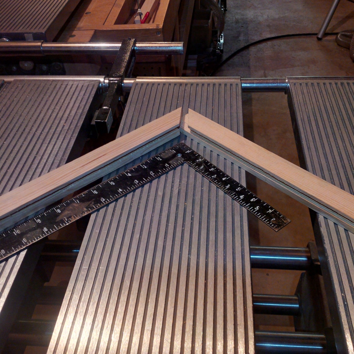

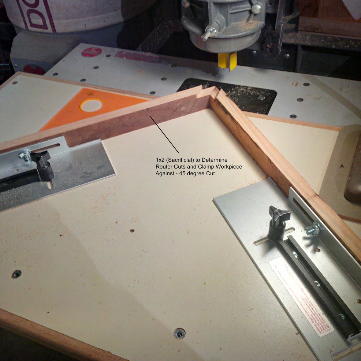

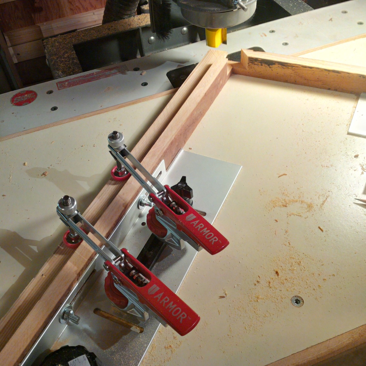

The OPR Sled. A bit long in the making but here it is. I am using it here to make a backed Miter joint. Maybe look at the last picture first to see where we are headed. Just getting a chance to use, but seems to work pretty good. The router vibration rattles the stops and set screws loose but once tightened down, good there. Also the 1-1/2” bit, covers a large area and takes time to spin down. Only brushed it a little. A clean cut and almost as good a new now.
Think I got the dimensions about right on the sled, front to back. The 45 degree cuts are at the front of the sled and horizontal cuts are at the rear of the sled. The front cuts overhang the sled slightly and rear cuts are just about max before the sled contacts the OPR upright support. Still might be a good idea to make the underside rails into cleats. It works ok as it but need to be mindful of balance if too far off the table underneath.
Parts: It would also be nice if the Shopsmith fence were a bit more square. It doesn’t matter much as the clamp system clamps to the melamine surface not the 1x2. All the inserts and respective hold downs come with the fence if you go that way. The other parts are from Woodworkers Supply and are called out on the drawing. Guess that’s it from here. Questions – Comments? Enjoy.
