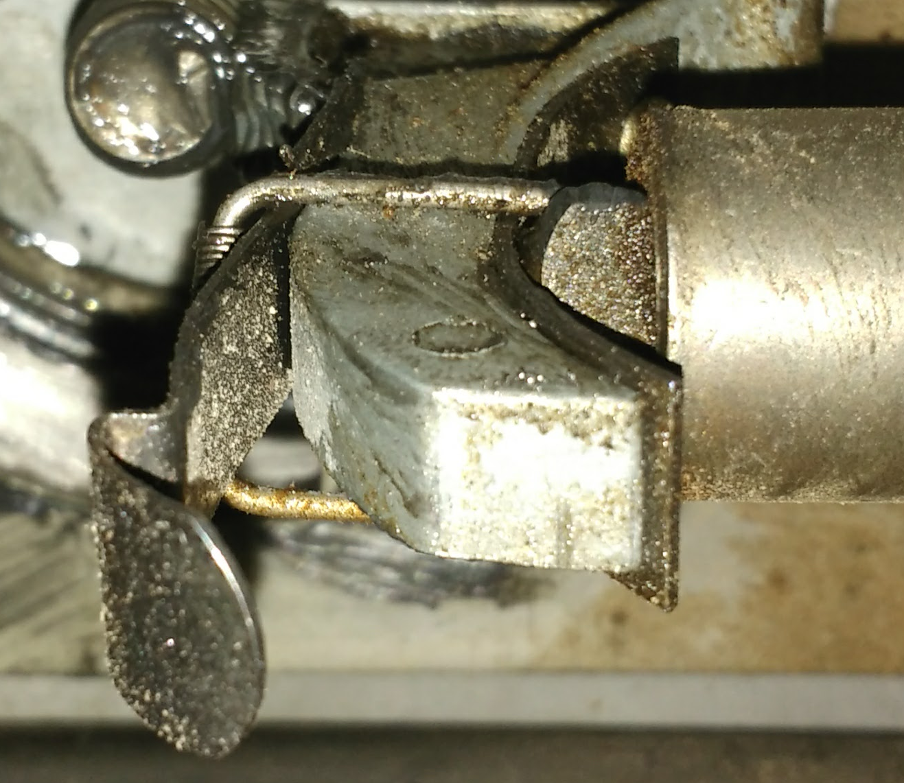

A sluggish floating sheave will definitely contribute to hard turning of the speed control knob towards slow. Also that would cause excessive pulling of the clip on the button bearing/porkchop when moving towards fast. You cannot over lubricate either movable sheave.

Re: What do I have here?
Two things jump out in that pix.
The leaf spring on the porkchop arm appears displaced from being centered on the arm.
The wire loop is not a loop. Also it appears to be coming from the side of the bearing 'button' rather than the top/bottom. Neither does it have the fine 'coil' of it.

I hadn't noticed that JPG. I went back and found another pic and everything is there, just a bad angle in the first pic I guess. Had me scared for a minute there. :D
porkchop spring.png (1.98 MiB) Viewed 1920 times
