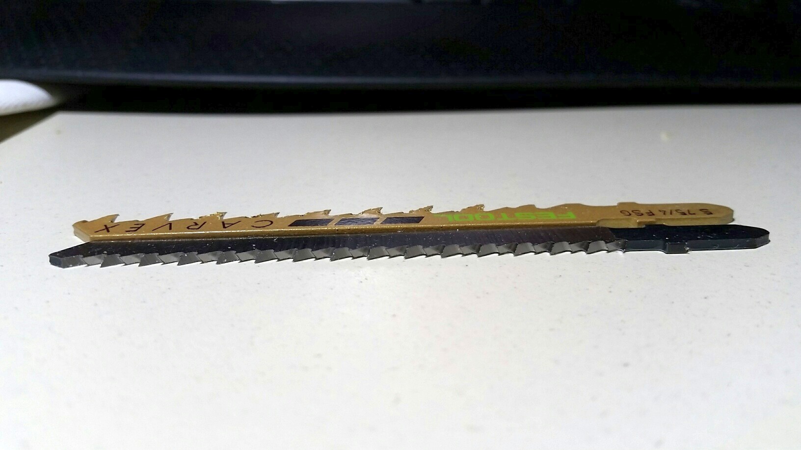

Never once did I think about how thick the blades were. No notification on any of the packages I have either. I did take a caliper out and measure some, all pretty close to .045". Now my Porter Cable jig saw has blade guide adjustments but for the most part I never seem to need to adjust them. One of the other saws has some sort of rollers and again no adjustments seem to be needed.
Now I'm watching these videos on youtube were people are getting these cuts which are much better then I've ever gotten. So how are they doing it?
How in deed. OK they have jig saws that are a lot more expensive then even my most expensive one. But still.
So after some research in to the great cuts I'm seeing these Festool jig saw are doing they are using a blade called a Carvex. After looking them over much thicker, measured one at .065".
How did I manage to measure one? By buying a pack of them. About $3 a blade in small quanities, perhaps a bit more as this way pre the price increase. (They were back ordered)
Yes I'm taking a chance that these are going to fit and as soon as my back recovers enough to get the jig saw out I'm looking forward to testing them out. If they don't fit then I'll save them until I get a festool jig saw.
I've got to believe this added thickness will made the blades much stiffer. And if Festool has them then it is likely other companies also have them, just haven't got around to searching them out.
This may not be news to some of you but it to me and I will to guess that it is news to a lot of you. Stay tuned for testing and possible results if they fit my saw.

I have several Bosch blades the measure .042 to .062 and since they all fit my Bosch saw I would expect the Carvex will to. I have always been happy with the Bosch blades but very seldom do I make a finish cut with the jig saw.

The blades fit at least two of my saws! No cutting yet but we will see, perhaps today???

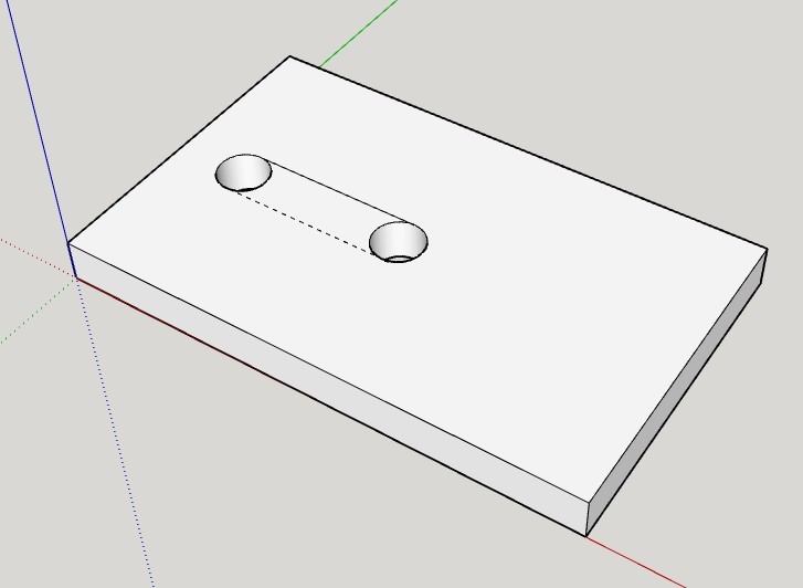

I'd like to see the cuts be at 90 degrees to the worksurface when I do the drill the holes at the ends of a slot and then cut out the rest in this fashion:
ScreenHunter_56 Apr. 22 11.12.jpg (28.84 KiB) Viewed 13272 times

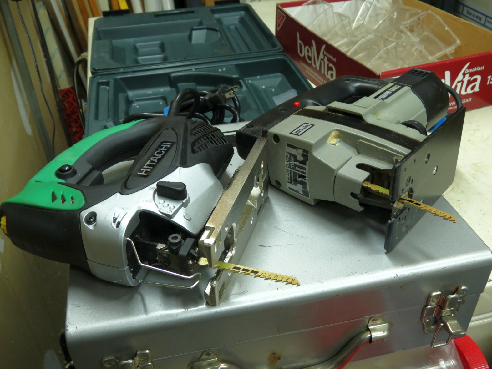

I often do this with a router but sometimes the jig saw. The porter cable does pretty well on these cuts, the hitachi, well it was inexpensive and came about because I was 800 miles from home and needed to cut out a 3' diameter circle.........

Well they did cut better in the porter cable but not as nice as I wished they would. Did not try the other jig saw. Maybe it is skill set that I'm lacking or maybe the Festool jig saw is just plain a much better saw. More green for more green I guess.
