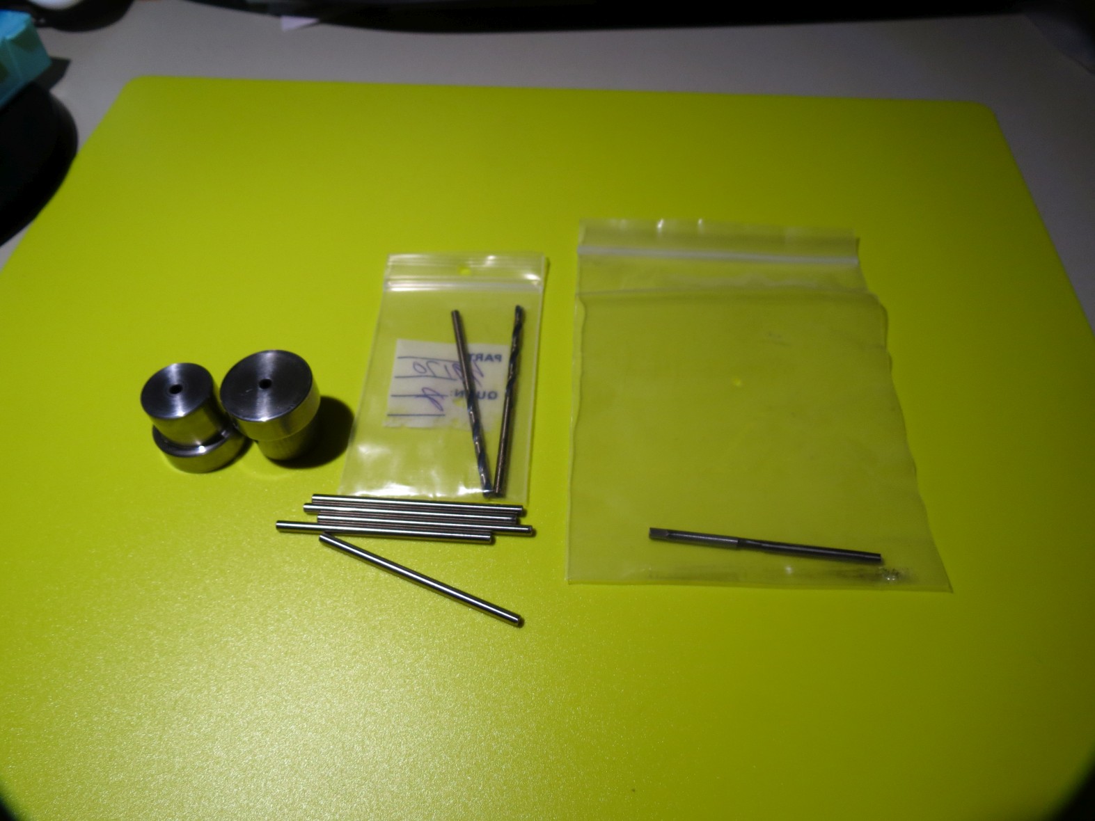

So I designed a "parf" dog drill guide that fits the MFT holes and has a centered and guided 3mm hole to drill into a pattern or top. I contacted a person who has made several other tools for me by the name of Richard Herrell. He resides over at the pen turner org if you have ideas of your own that you would like to have made. After contact he was given my drawings from which he made me a pair of the guides.
He does exceptional work and these are no exception. I have tested the fit in the MFT and the drill size is just right. They are heat treated so they should last a very long time.
I also had to get some drill bits in the 3mm size that were also heat treated and should last plenty long and if not they are relatively cheap to replace.
I also wanted some 3mm rods to use for alignment when doing template work, found a nice set of 5 and they also fit very nicely.

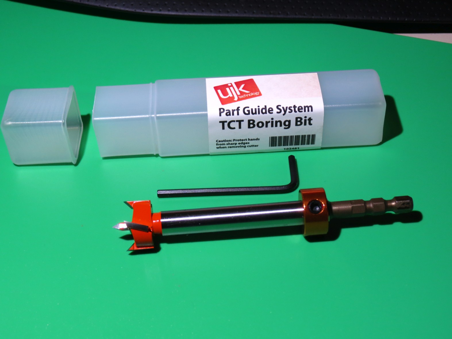

The drill bit that enlarges the 3mm hole to 20mm comes with the kit I have on order from lee valley so I can use it with that system or chuck it in the shopsmith to make holes.

Other other news the arrival of my new bit from Axminster. I takes a while to get here from GB. Well packed and arrived in great condition. Clean off the oil and wax stuff so you can see what it looks like. Note the extra point in front that aligns it to the pilot hole.
Can't hardly wait to try it out!
