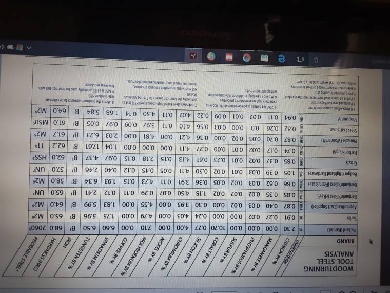

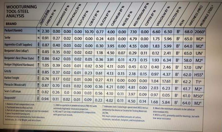

In the same test that I referred to in my earlier post there were two versions of the Benjamin's best tools that were tested. One set was purchased through E-Bay and those did not make the grade as HSS but those from PSI did check out as HSS. I will try to find the copy and post it here.
I have an older set of Miller's Falls which have the high carbon steel cutters. They have grey steel like the good butcher's tools from the old days. I can put a real good edge on them but the edge doesn't hold up like the HSS edge does. Compromises for sure.
There are also different alloys of HSS such as M4 but some of these require the use of higher end grinding wheels including the CBN wheels.
In my case the use of these M4 Steel chisels, which are also very expensive, is not warranted. Others will disagree.
Before I would advise anyone to spend money on really good chisels I would suggest the sets from Harbor Freight. Not very good but cheap and good for learning to grind and sharpen.
Bill V
wa2crk
Posts: 3080
Location: Leesburg, Fl
Re: Lathe Tool Steel
Post by wa2crk »
This is the chart I was referring to. I hope it helps someone.
lathe tool steel types.jpg (104.59 KiB) Viewed 9289 times
Bill V
