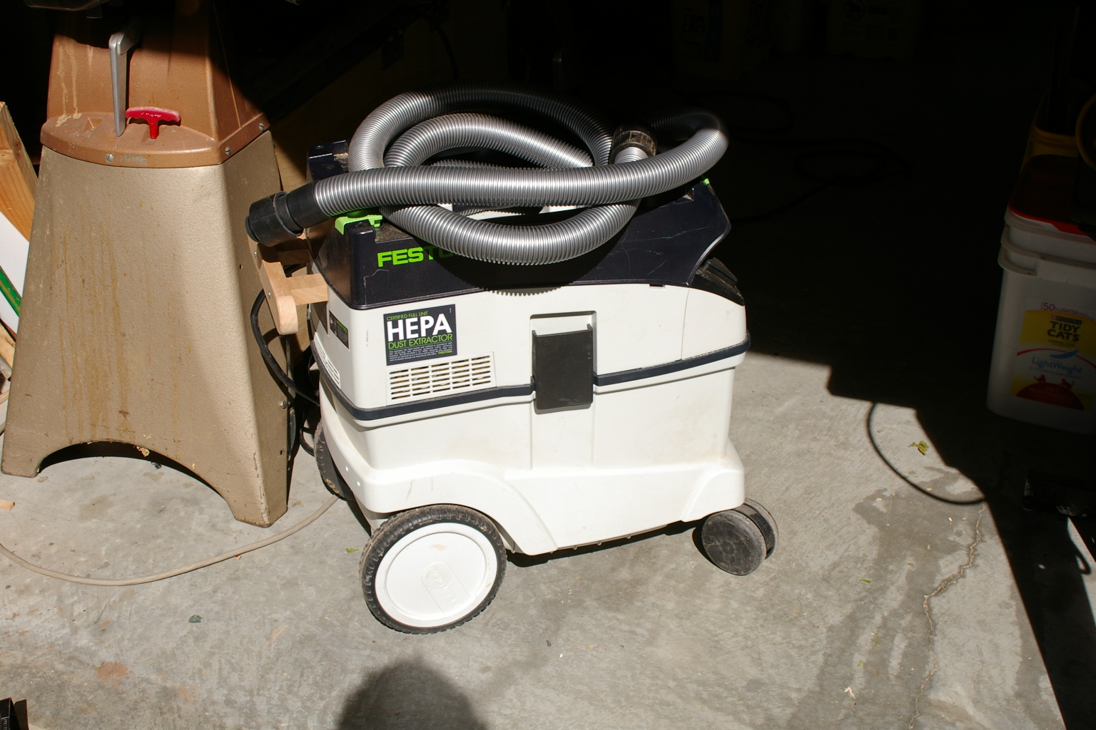

dgreen810 wrote:I have an an opportunity to pick up a like new Festool CT-46-E dust collector for $300.00 bucks. Can someone give a clue if this unit would suffice for limited use with SS equipment?? Right now I am using a Craftsman shop vac.
Don G
I assume it is a CT48E. It will work fantastic on your Shopsmith provided you have a dedicated 20 amp service. Simply plug in the vac and plug your Shopsmith into the vac. I have that same set up and it works very well.

No it is a CT-36-E. https://www.festoolusa.com/products/dus ... t-36-e-usa. However comparing the specs. on both units it appears they are basically the same except for container size the CT-36 at 9.5 gal to the CT-48 at 12.7 gal. In any case if yours works OK I think I may spring for this one. I do have a question though. Have you had any trouble with the hose only being only 1 1/16"??? Seems pretty small.
Also where did you get the connecton to adapt from Festool hose to SS dust outlet???
Don G

I did purchase the CT-36-E "HEPA" and a Bosch hose as suggested. In case someone else should go down this path I ran into the the following issues.

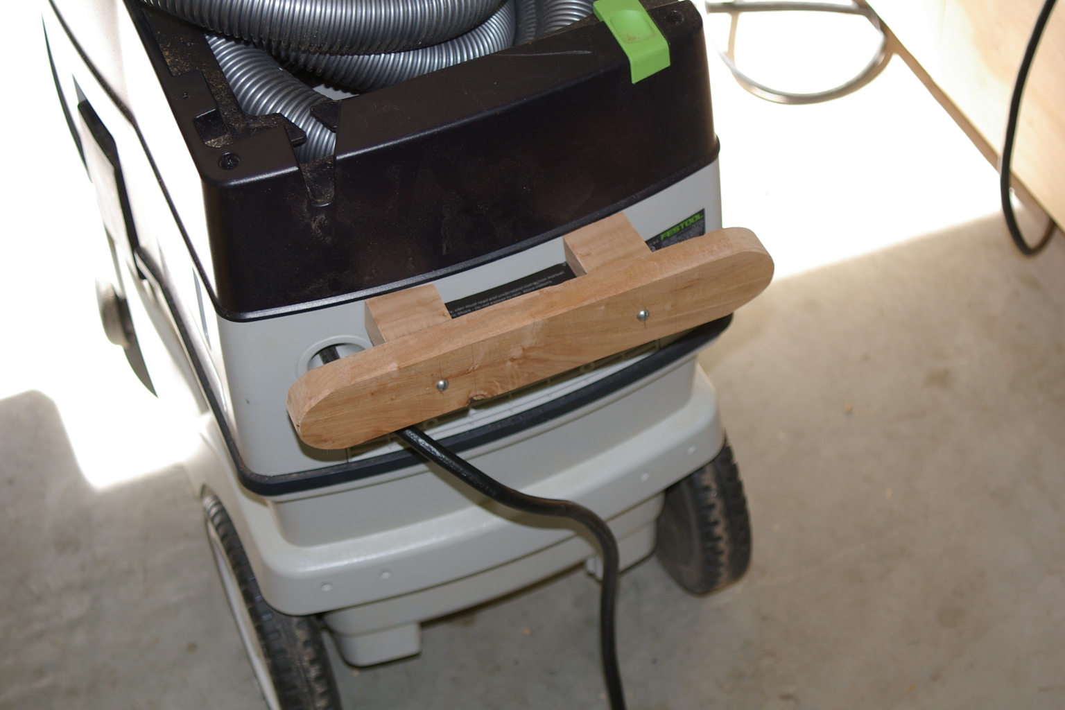

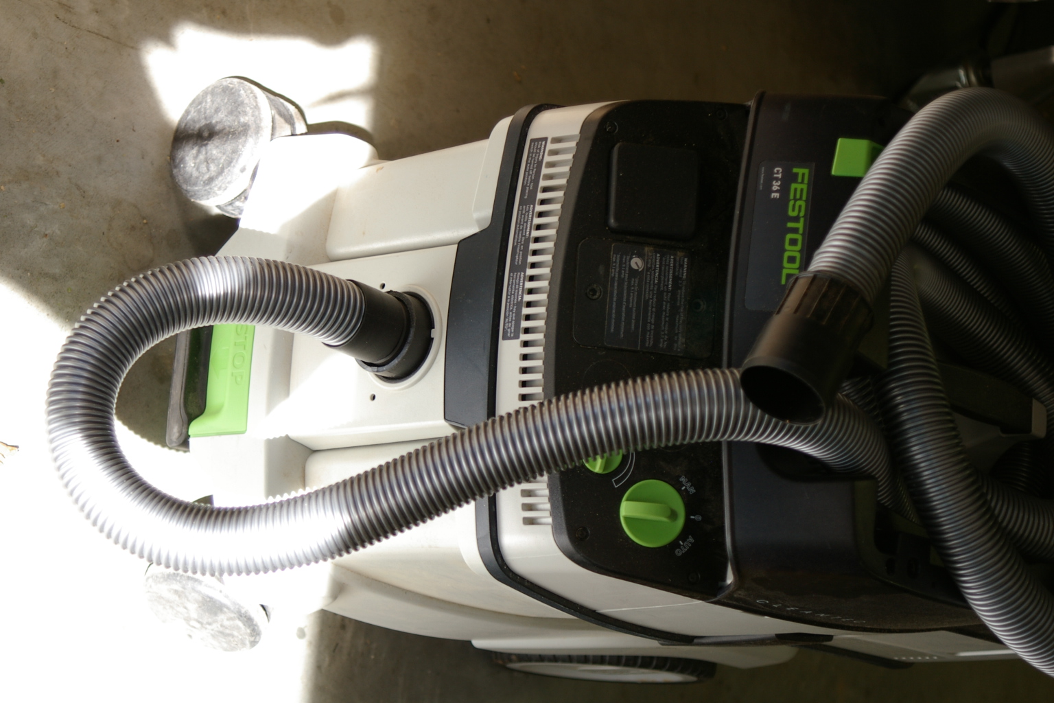

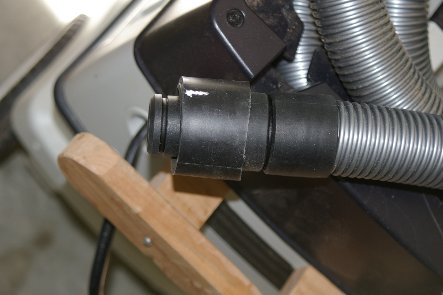

As someone suggested the Bosch hose indeed does fit the Festool inlet, however the other end does Not fit the dust ports on SS equipment. I believe there is an adapter from Bosch that will go from 2 1/4" male to the Bosch tool end, but I am not positive about that until Monday morning. In the meantime I made a adapter from a piece of Craftsman vac hose that will fit the inlet of the Festool CT-36-E. So I just reversed the hose so I could use the Bosch 2 1/4" end to tie into the SS dust ports. Also made a temporary attachment rack for the A.C. line.

The Festool end can easily be put on the Bosch hose for attachment to the tool. The grey hose in the pic above is not ant-static but you all probably already knew that.
