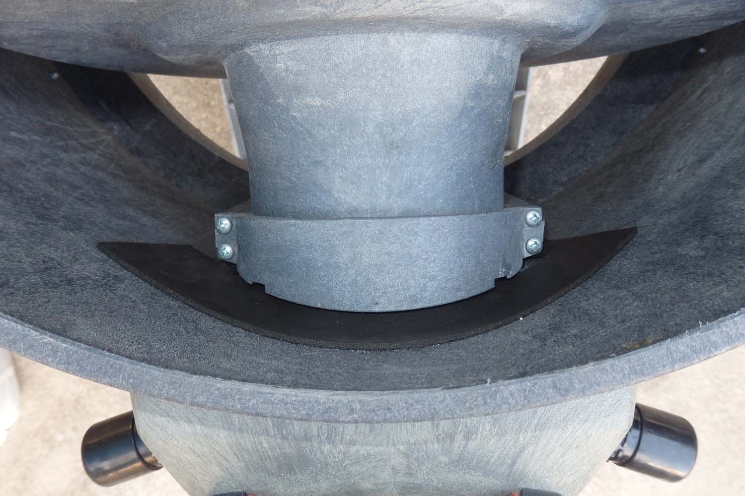

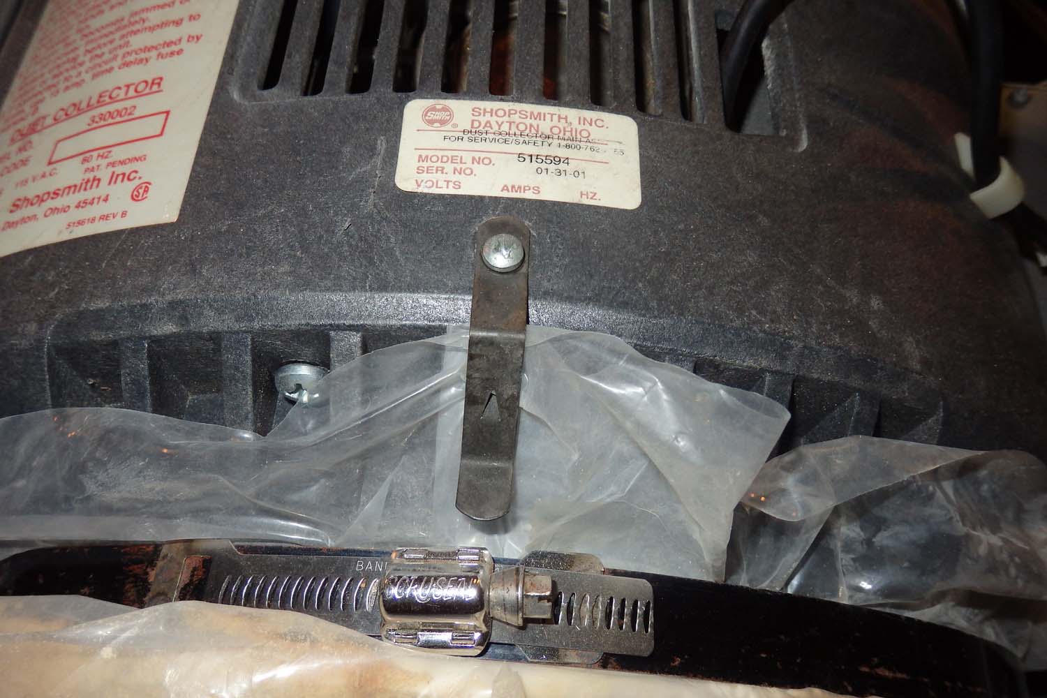

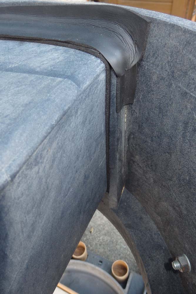

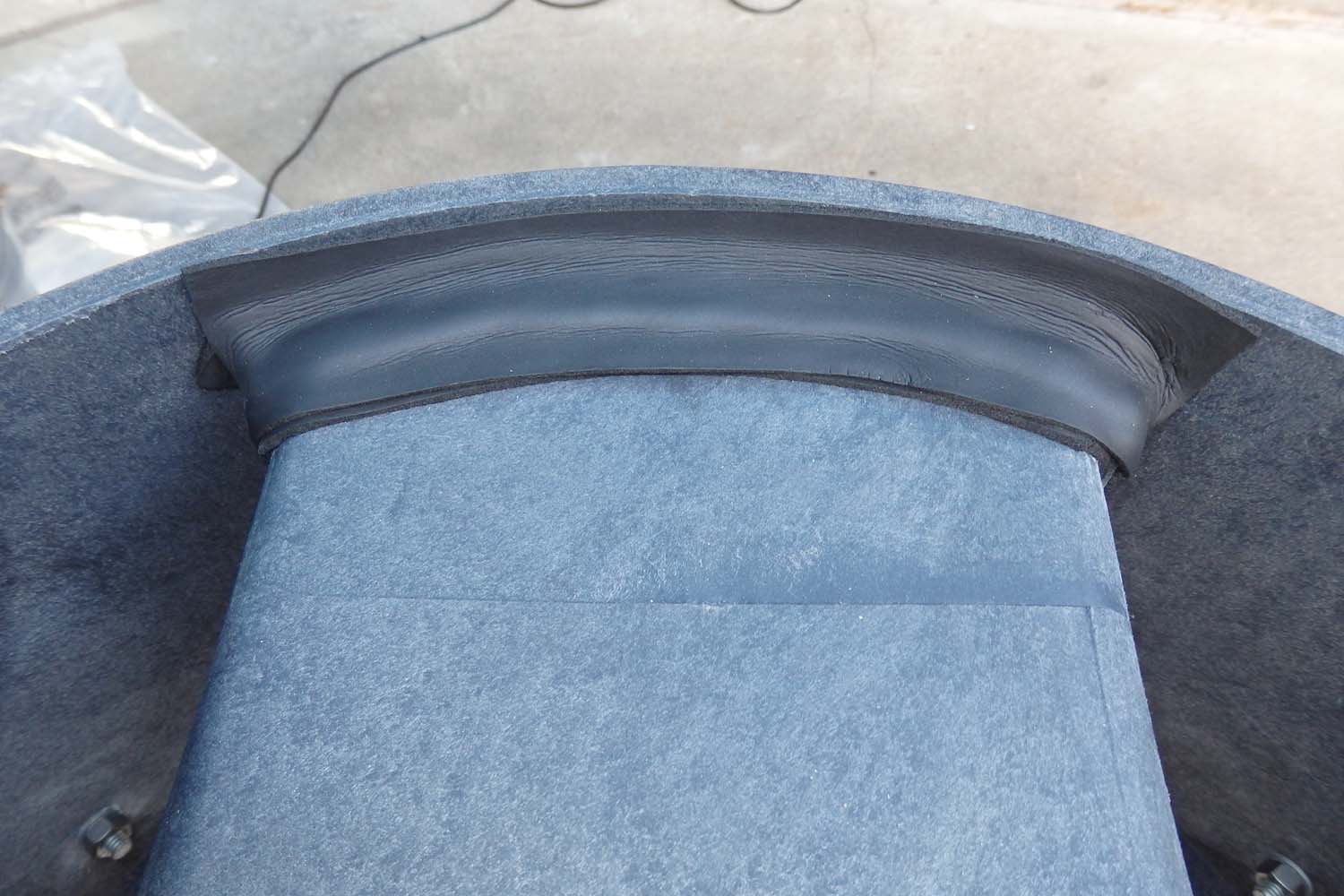

I bought mine used in 2016 when it was already 15 years old and have been pleased. Even with it missing some accessories, I think I got a good deal at $75. I later picked up a used ShopVac locally just for another hose, extension wands, and attachments, and then resold the ShopVac without any accessories. The previous owner of the DC3300 was in CA, and I don't think he was the original purchaser, so no telling where it started out. Even at 16 years old, no issues with plastic. Mine came with the auxillary handle on top of inlet housing ... prior to 2001 or so I don't think that extra handle was "standard", so that may be a clue as to how old one is (in case the serial number is not a date code like mine). Without disassembling it, no way to tell if impeller is damaged, unless performance is really off or maybe sounds strange. I used mine for several months before taking it apart to give it a good cleaning and replace gaskets. Shopsmith sells a gasket kit, but I just used self-adhereing 1/8" x 2" foam rubber pipe insulating tape. If you buy used, might be wise to plan on replacing gaskets and give it a thorough inspection. The housing is held together with machine thread screws into plastic and one was not holding well ... that's one thing I revised to lock nuts when I re-assembled. Attached are a few pics of mine from when I replaced gaskets.
