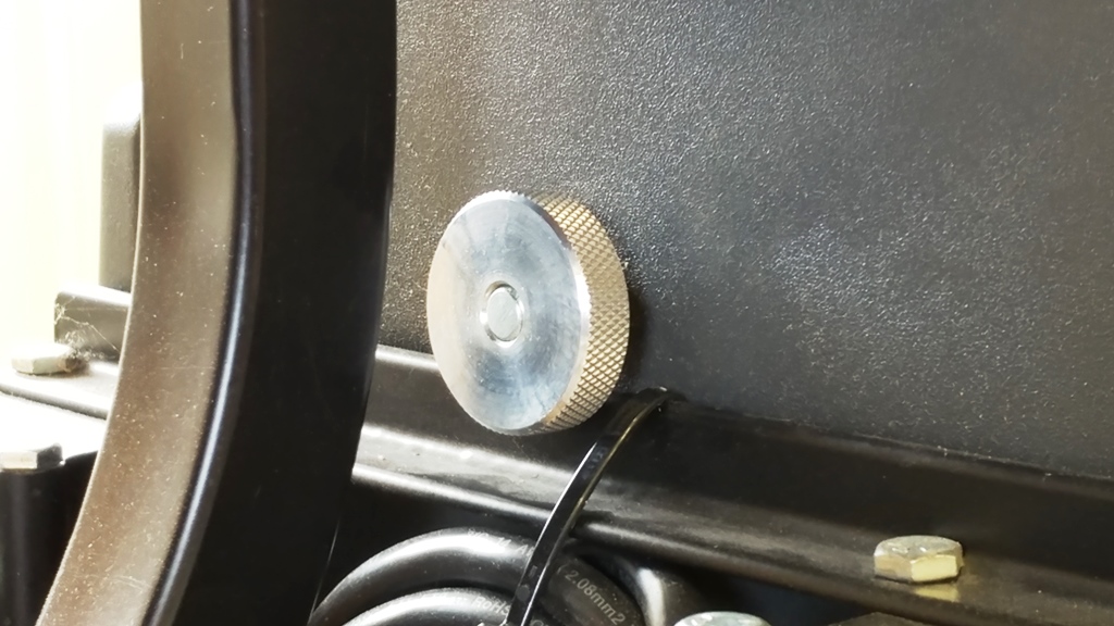

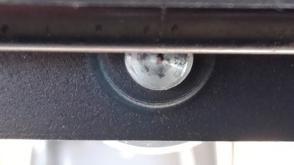

What is "fully engaging"? The end of the threaded rod is tapered. It goes up against the pivot rod. It is only supposed to be finger tight. Channel locks, NO.
Yes the knob at the right end where the lift assist is mounted is tight but again the knob should only be finger tight so it is no problem.

In the past I recall a user with a problem with the knob in question. In that case the thread was coming out the flat side and thus not screwing in far enough to engage the rod. Does your knob look like the one pictured in this thread?
Those knobs should turn pretty easy, never ever needing any tools to turn them. They also don't need to be all that tight to work, just snug.
I'll see if I can find the old thread to refresh my memory and let you have a look at that issue.

No, my knobs are nothing like that. It's one of two issues, either the threading on the cross arm is a mess or the base arm knob has thread issues. WD40 made little to no difference. From what I can see of the threads they look fine, clean and threaded cleanly. Everything is very tight, always has been and probably the reason for the mishap last August and the near mishap last night.
Called just a few minutes ago and don't have a warm fuzzy feeling that the problem was understood well at all but probably won't hear from an engineer until tomorrow morning. That said, I'm basing on how easy every video I've seen shows the knobs being turned without any real effort. Checking the arm lock knob and that turns almost without effort. My biggest concern is making it right for safety sake and if there was a live demo anywhere nearby I'd drive and hour or two just to verify this but all are way too far that I've seen listed. And no-one I know locally has a unit either.

Re: Lift Assist Issues
I don't have my lift assist installed right now so I can not do a valid check but from your pictures it does seem as though the lift assist is too close to the knob. Not much help, I know. But hang in there, this will get resolved.sreilly24590 wrote:While this page doesn't do a thing for showing how stiff these knobs are it does show them full in/out where they stop being less stiff, if that makes sense. Not easy to turn but doable. See http://www.astral-imaging.com/shopsmith.htm
