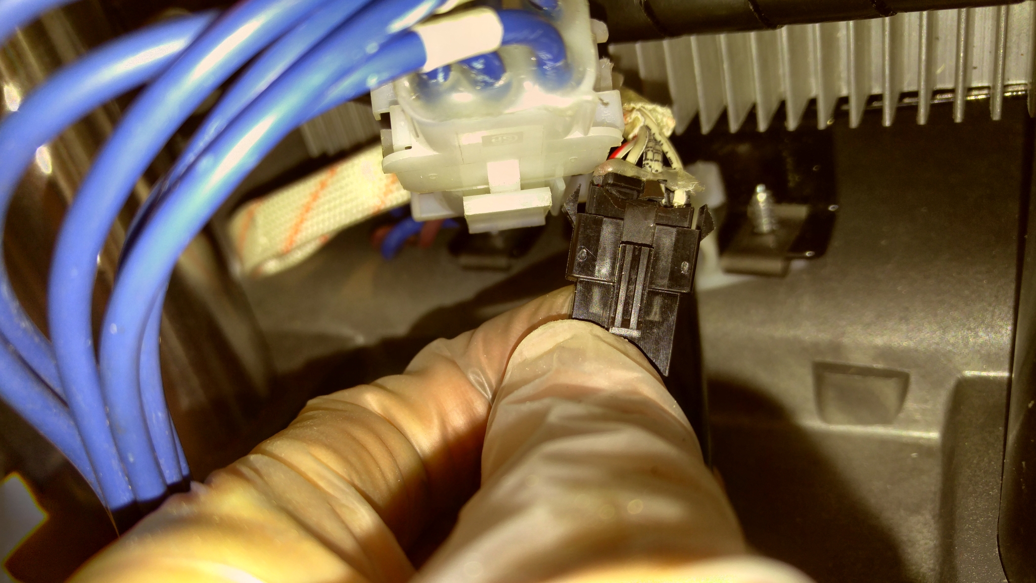

Belt loose, motor fully unscrewed and pulled away, I went to unplug the motor from the original control panel. To my surprise, there were far fewer cable ties (1) than shown on the DVD (4), perhaps since 2010 they discovered that many ties were not needed? Also, one end of the small plug was cracked with a broken piece falling into my hand:
20170617_112620 (crushed clip) reduced.jpg (1.44 MiB) Viewed 7145 times
Would this affect the function of the plug? I didn't know and decided to wait and see once the new control panel was in place.

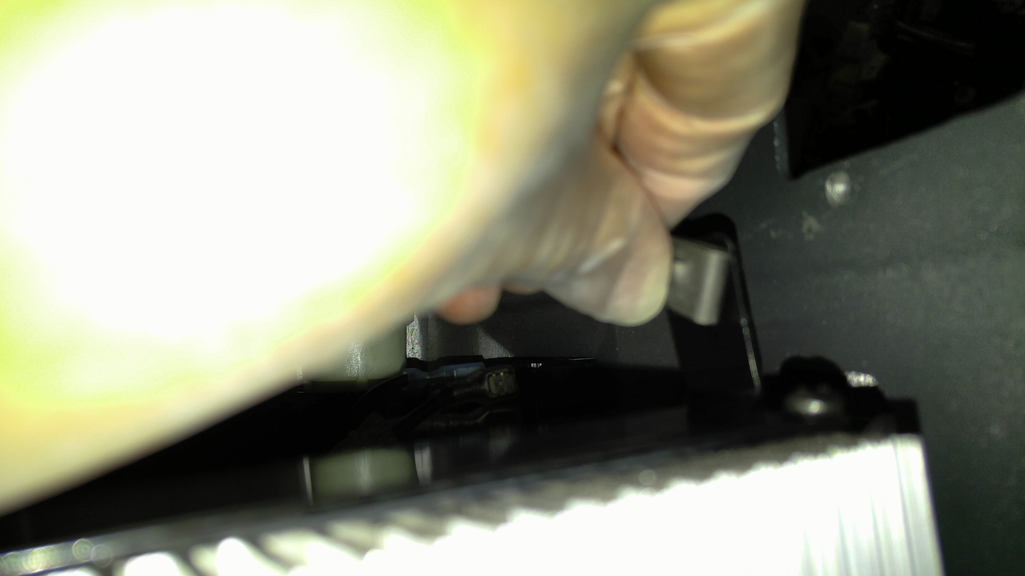

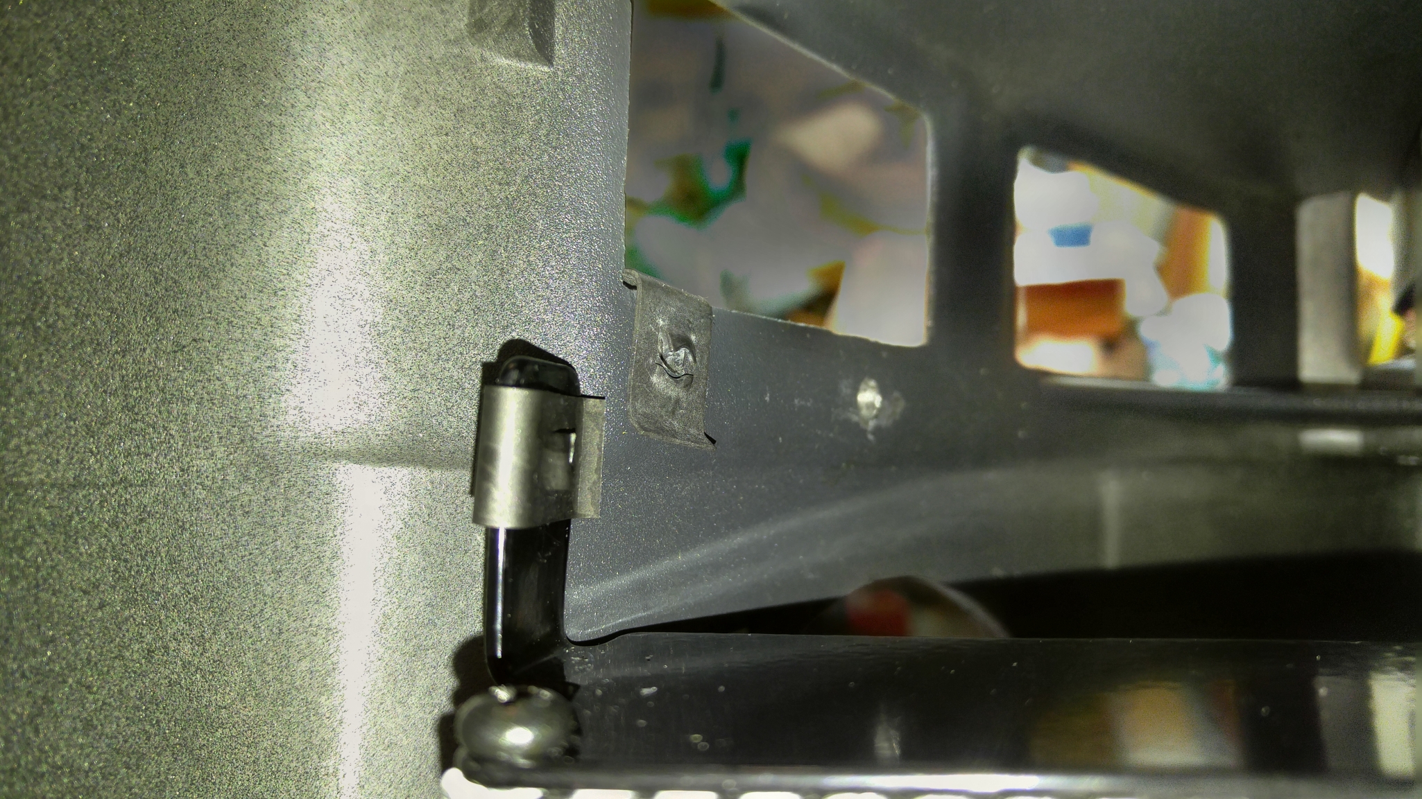

It was time to remove the power supply and I went to remove the four screws holding it in place. Another surprise as two of the tinnerman clips weren't attached to the power supply but merely held against the side of the mount when the screws were put in. Was this another assembly line time saving measure? The next two pics, as the clip should have been, and how it was placed next to the mounting bracket:
20170617_101905 (propper placement) reduced.jpg (1.98 MiB) Viewed 7145 times
20170617_101659 (hanging in space) reduced.jpg (897.72 KiB) Viewed 7145 times

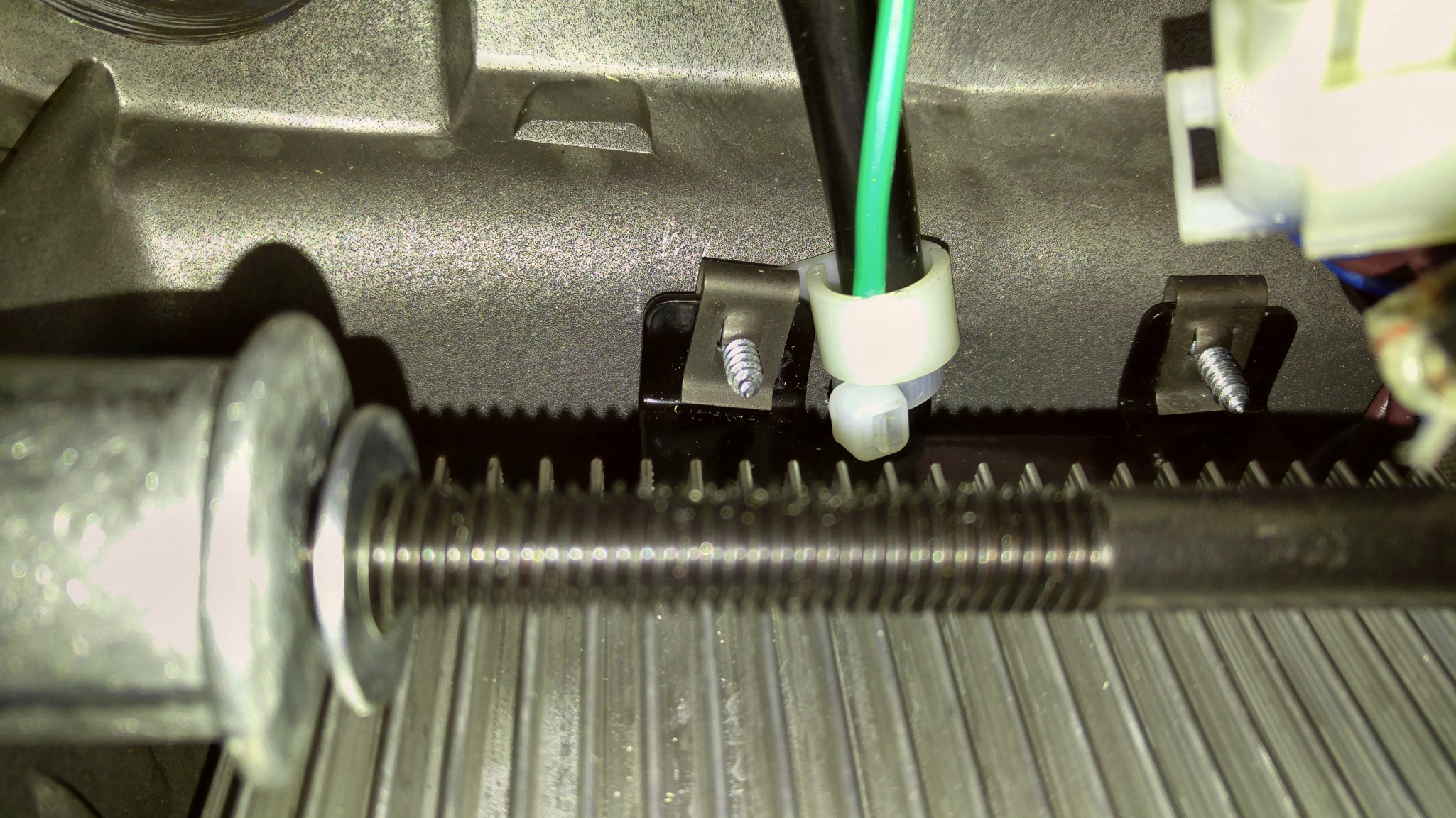

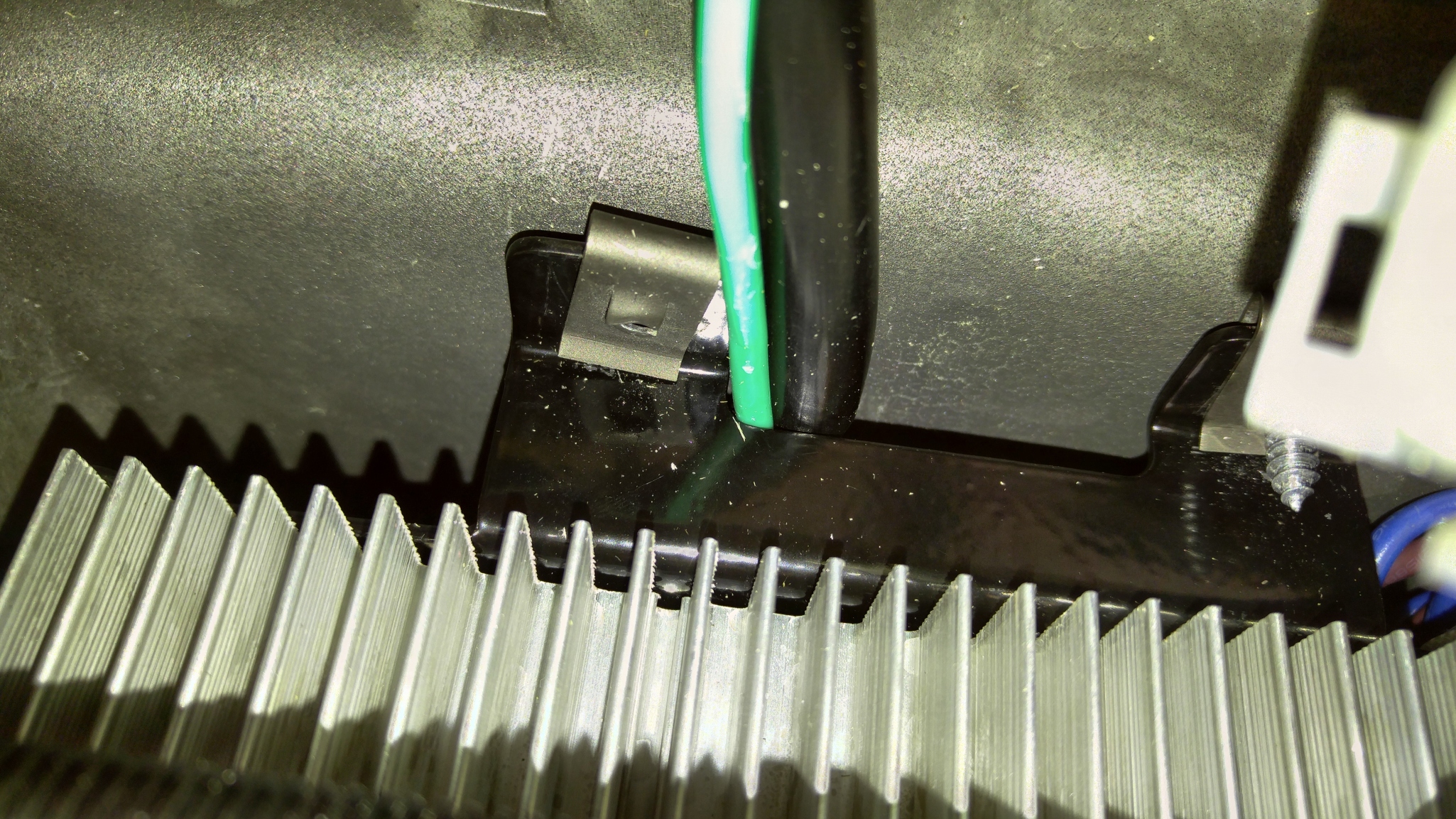

Done, I properly attached the tinnermen clips onto the power supply and mounted it back in place. I added a cable tie where it was shown on the DVD to allow the cable clip to hold onto something. I found without it, the cable clip only held the cable from moving side to side, not up and down. Pics as the cable was without a cable tie, and then with the clip and my cable tie in place:
20170617_104822 (no tie) reduced.jpg (1.41 MiB) Viewed 7145 times
20170617_105201 (added my tie) reduced.jpg (1.8 MiB) Viewed 7145 times
