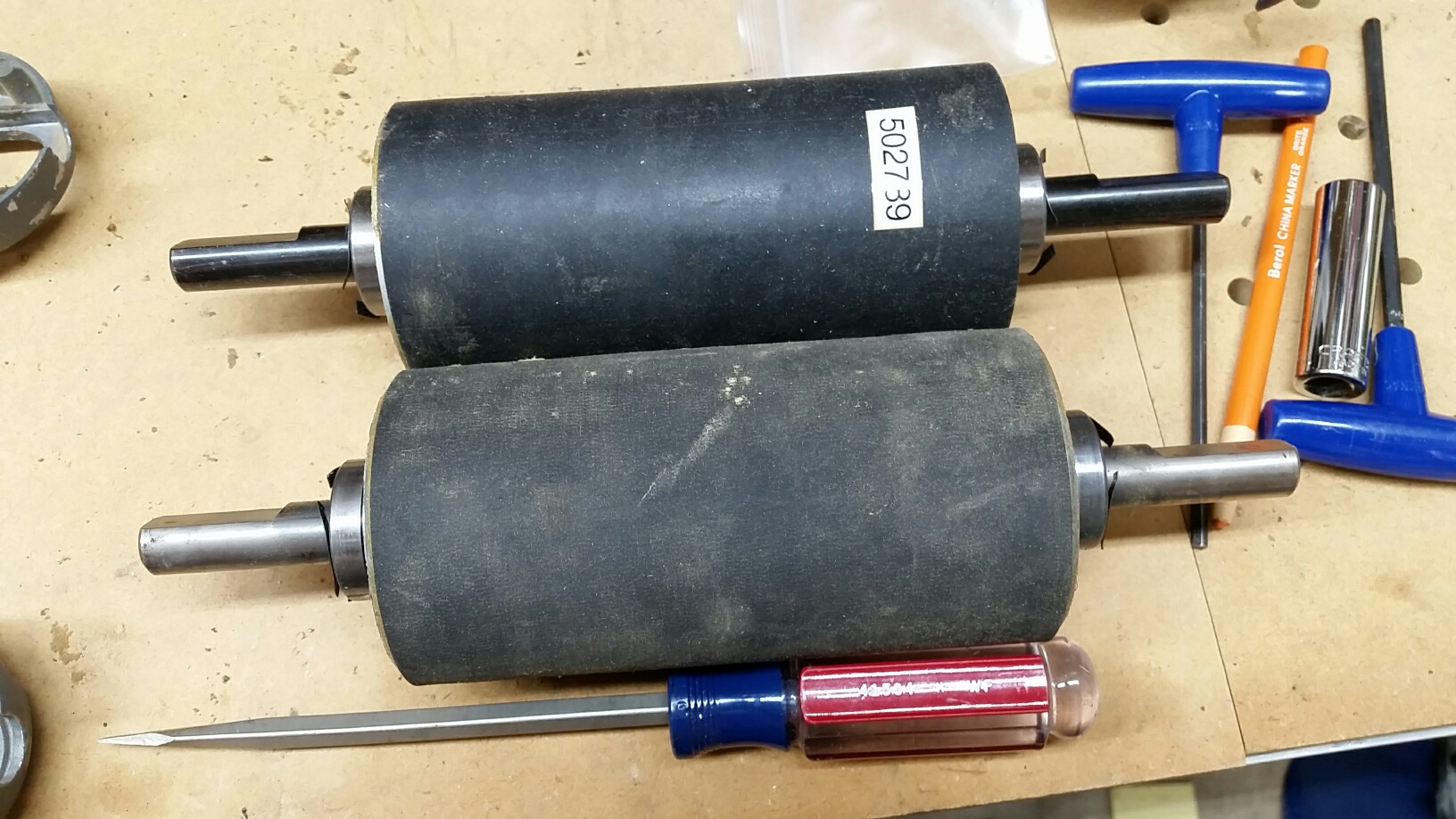

I was going to repair it but then though this thing is pretty old now so maybe I should just refurbish it. Last Aug I then ordered the two main parts, the idler drum assembly and the drum assembly. At the time that was $100.41 and $101.66. I was just going to order the sleeve for the drum but it wasn't in the parts list as a separate part so I ordered the whole thing. Turns out there was a part number for just that part but I kept the assembly on order so I'd have new bearings and all.

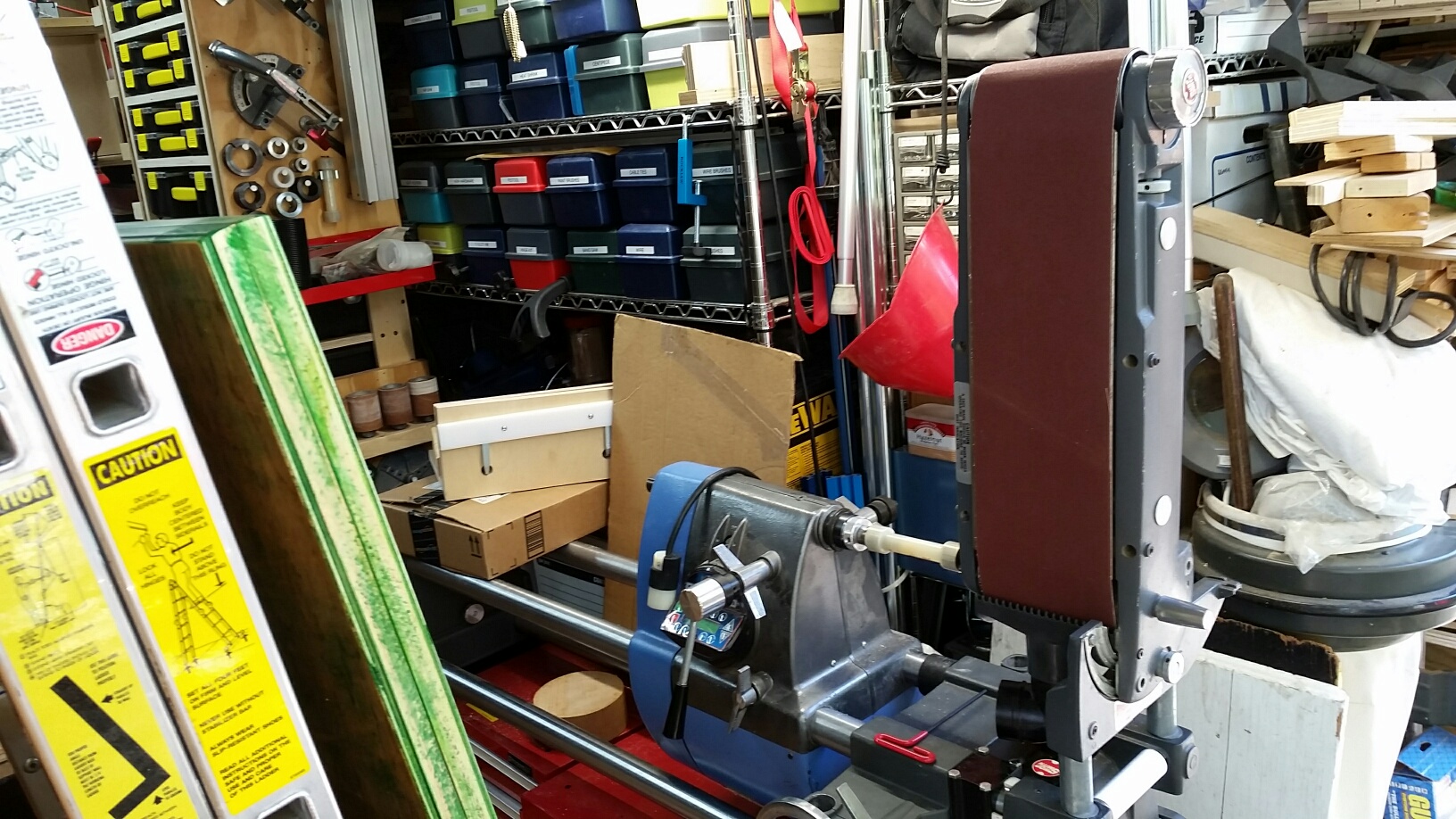

While I tried to mark and measure things so it would go back together pretty well adjusted that did not work out so well. The belt was no where near centered and took a lot of adjustment...... the alignment to the shopsmith was looking OK but when I ran it there was a lot of vibration. But those are fixable issues and now solved.

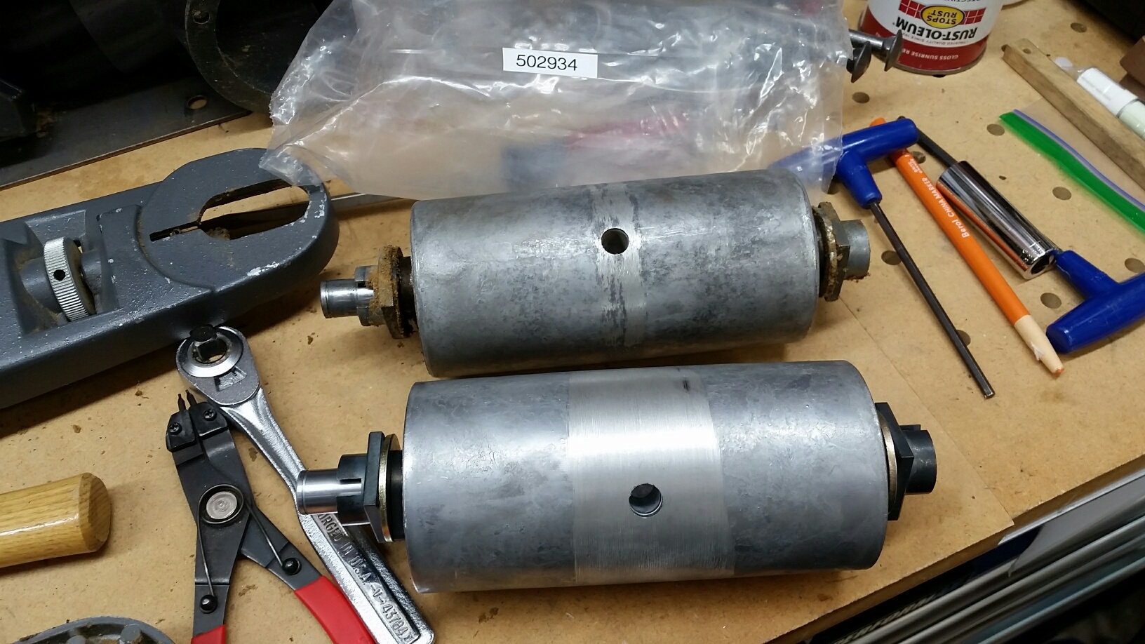

Since we have the rule that if there are not pictures then it didn't happen I did take a few shots along the way.
Here it is before I started:
As I said it was basically taking it apart and swapping in new drums.
And then after the tension set, belt installed and alignment done it ready to go.
Yes it has the updated dust port, a major improvement over the old one. Other then that it looks almost as good and works just like it did 40 years ago. Not a bad investment.
