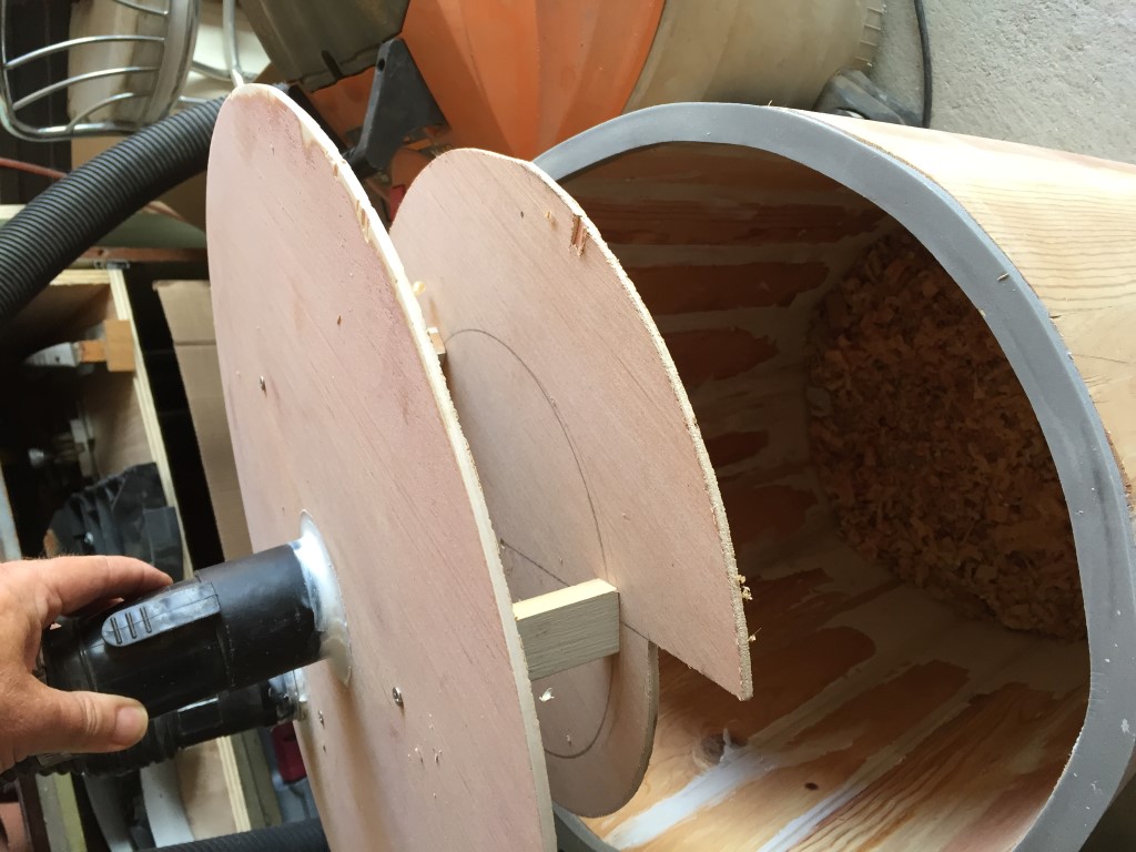

I should have done this years ago.
I finally got tired of the dust clogging up my filter.
The barrel is stave construction from some left over pine shelving I wanted to get rid of.
Stave construction barrel
2017-06-29 07.23.04 (Custom).jpg (203.44 KiB) Viewed 11665 times
2017-06-29 07.23.14 (Custom).jpg (172.13 KiB) Viewed 11665 times

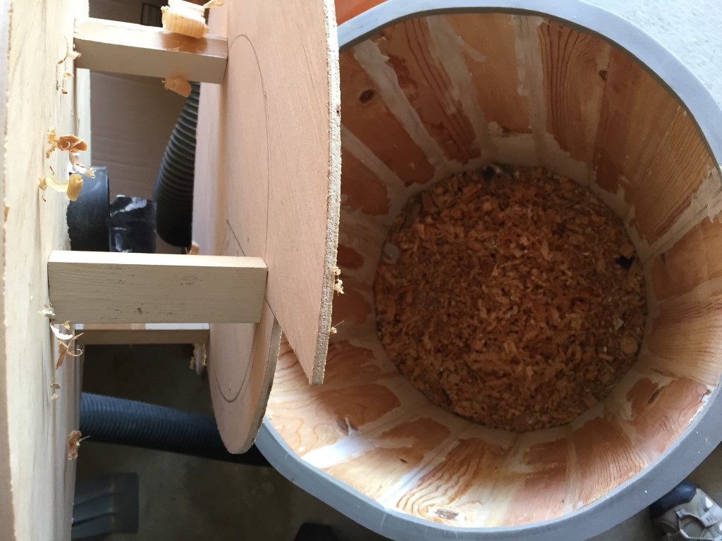

Here is the baffle, you can also see weather stripping I applied to the top of the barrel.
Thein Baffle
Thein Baffle
2017-06-29 07.23.51 (Custom).jpg (154.14 KiB) Viewed 11665 times
I used caulking on all of the internal joints to make sure it was air tight. It works!!
Shavings in the Barrel
2017-06-29 07.23.54 (Custom).jpg (145.85 KiB) Viewed 11665 times
We'll see over time if I spend less time cleaning the filter. Nasty Job! If nothing else I have experience creating a staved barrel. Not for the feint of heart.

Cool way to make the container. I did the same with a 55gal drum and my HF dust collector. The Thein baffle system makes a huge difference in the dust collection.

The chips in that barrel are actually from a hand plane used to slightly round off the sharp corners from the the stave construction. Just regular vacuuming of the shop floor. No reason a Jointer with dust collection would not work as well.

Great little project! I love my Thein baffle and it captures a lot of stuff. At least for my high flow CFM, low pressure Dust collector, it must capture close to 99% of the dust before it ever reaches the filter.
