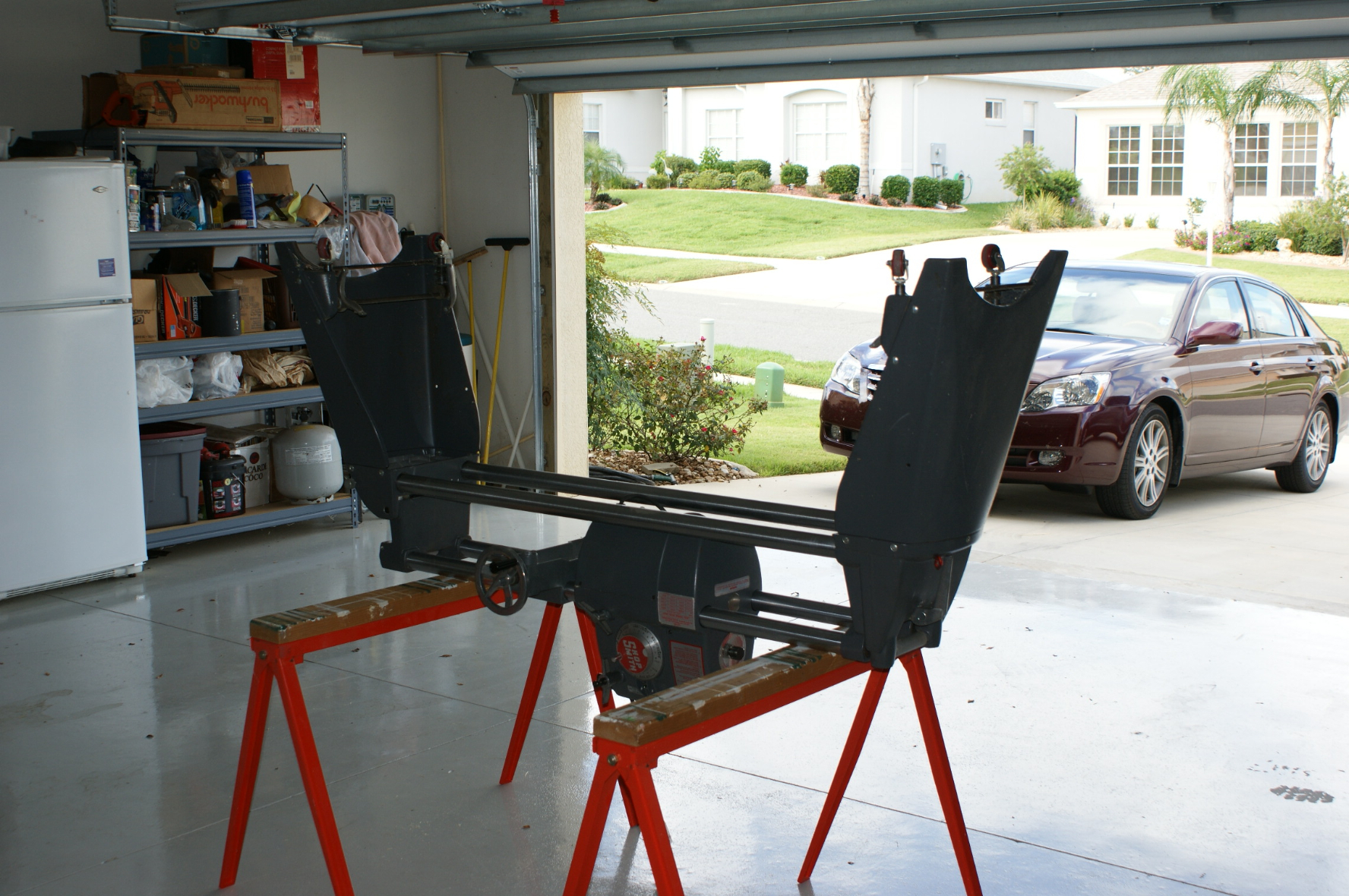

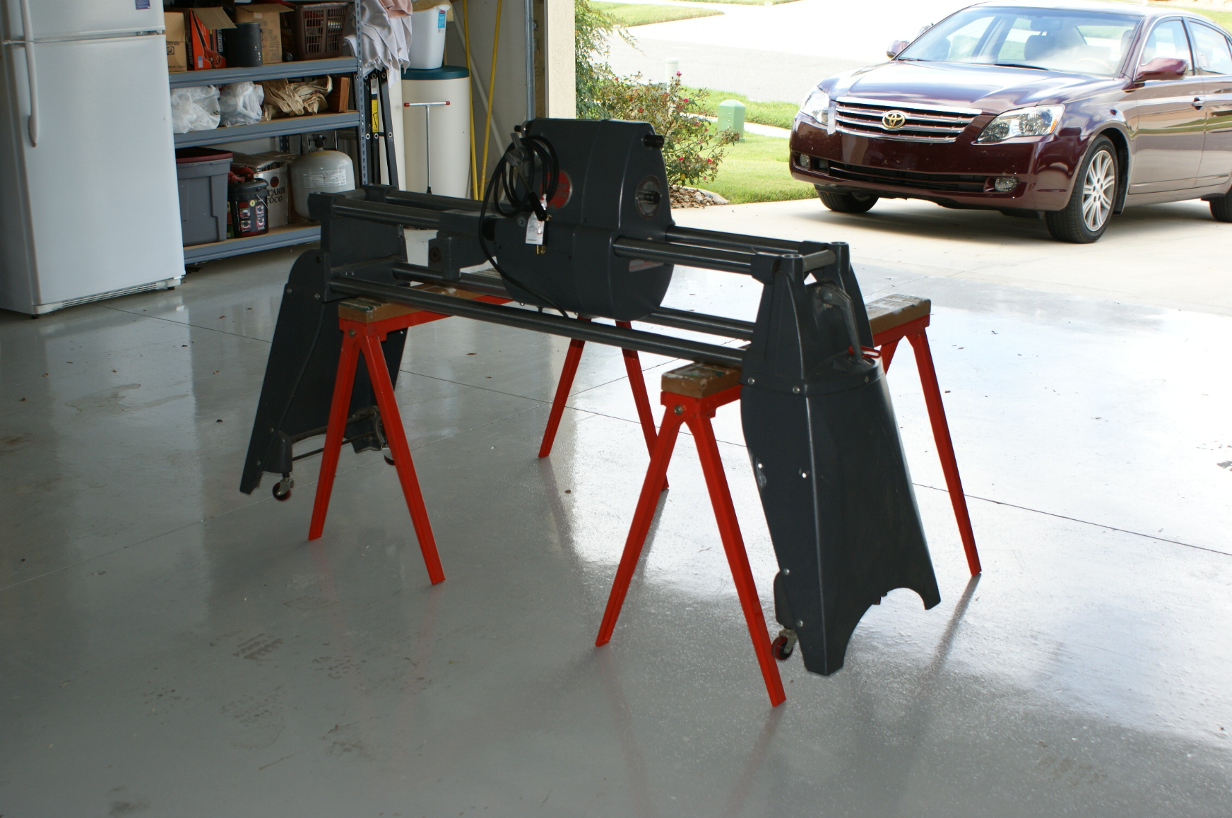

Upstairs or down like this
First set it on some saw horses this way
Roll it over on it's back
Then remove the legs
Then have a friend help carrying up or down as many floors as you like
Bill V
