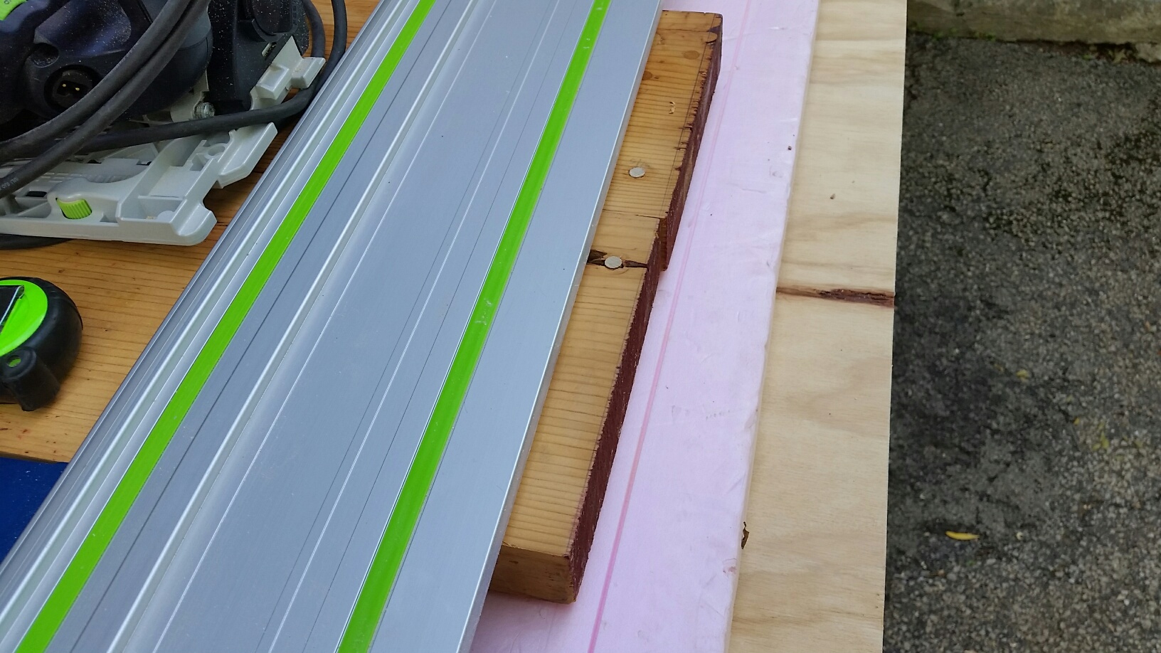

The pictures.

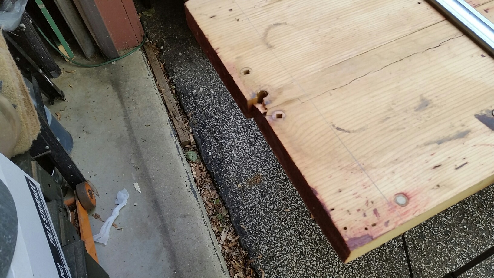

This is one of the ends I trimmed. One board was pretty square and the other not so much. The cuts were ruff too.
The other end wasn't even close.
I did the trim to length cuts which fixed those issue.

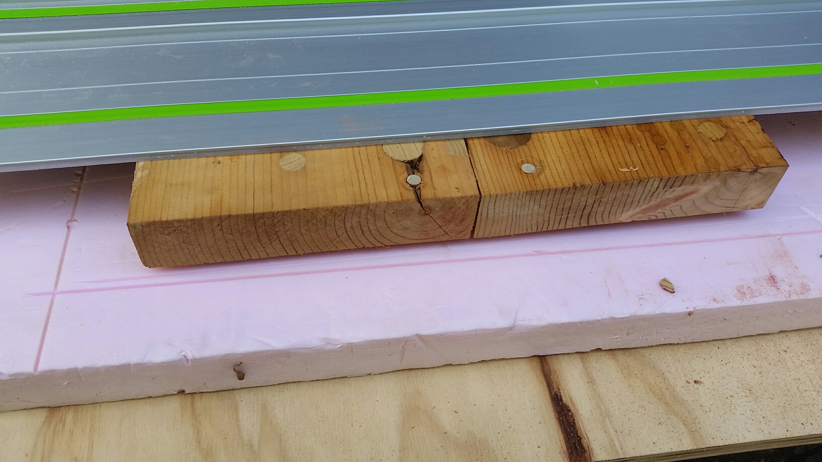

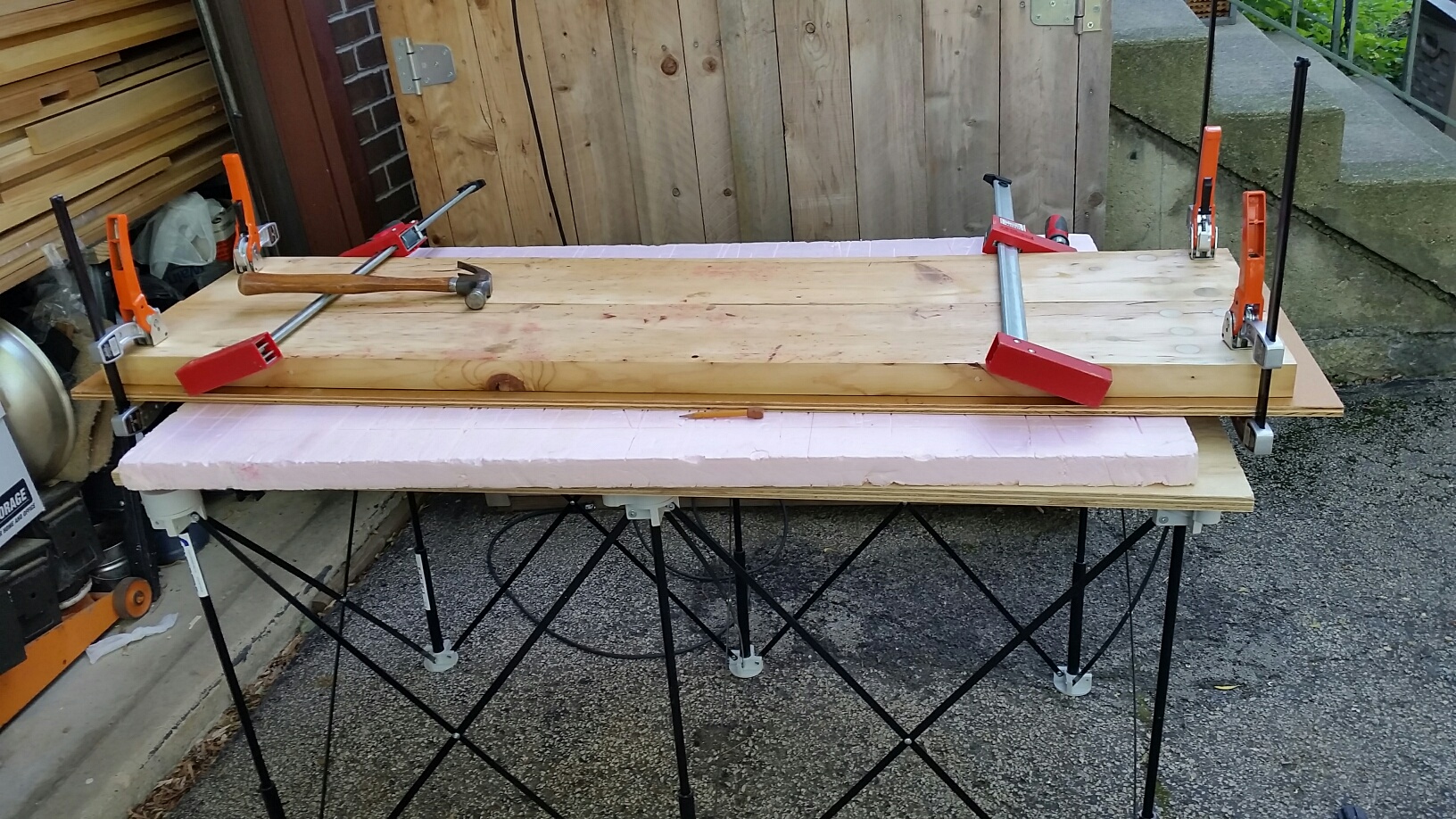

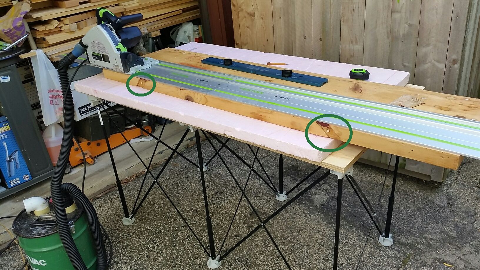

Next I trimmed the wide way, you can see the two places that were cut in to recess the supports.

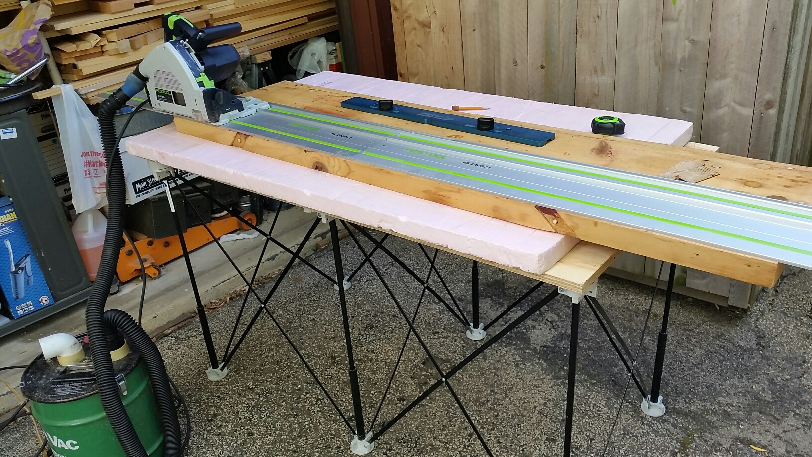

You can just see the one after the cut but it close enough. If you look closely in this next picture you can see it. This is how I clamped it up to trace the boards unto the MDO.

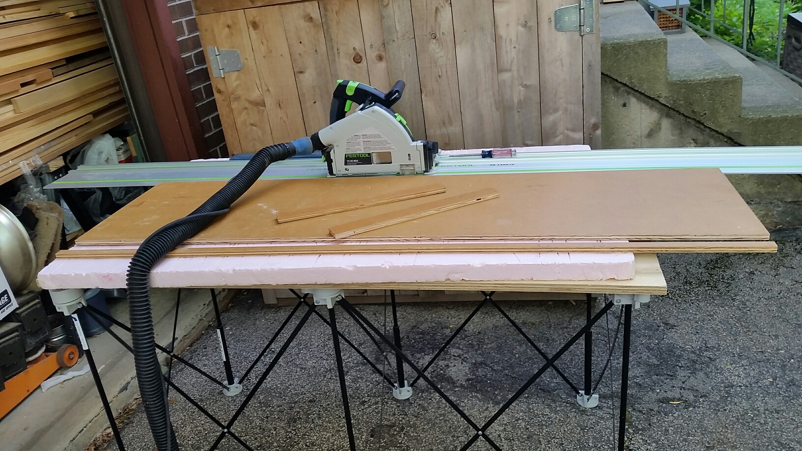

Here is the MDO and the small left overs, not sure they are worth saving but the larger sheet sure was.
And that is that.

Quote, "that were cut in to recess the supports."
What recesses? They are not OEM
Re: 10ER bench questions???? Width?
jsburger wrote:Ed,

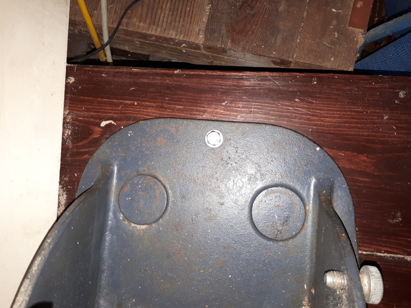

As I mentioned the unit had a plywood back. To get that to fit flush the notches were cut in, the supports then were inside the plywood. You can see them here in the circles.

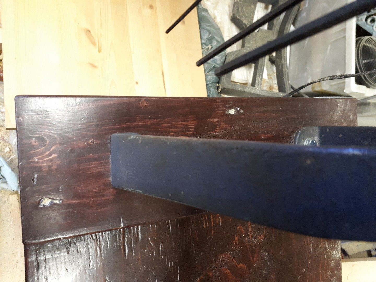

Speaking of brace 'recesses', why are there none on yours JB since the boards are wider than the steel legs the other end of the braces are attached to? :rolleyes:
Posts: 6585
JPG wrote:Speaking of brace 'recesses', why are there none on yours JB since the boards are wider than the steel legs the other end of the braces are attached to? :rolleyes:
I see the rolleyes.
The SS metal legs are tapered. Where the bottom of the braces attach to the legs the legs are 17" wide. The top of the legs are 15 1/4" wide. That being the case with a standard construction one would need spacers not recesses for the top end of the braces.
The top of my bench is 16 1/4". Spacers again.
Tweek, tweek troll... :D :D :D :D :D :D Keep it up, it keeps me sharp like you. :)
