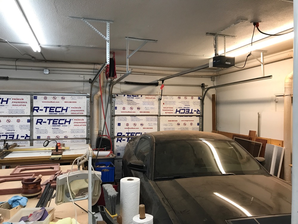

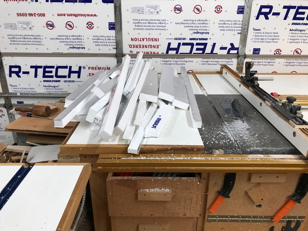

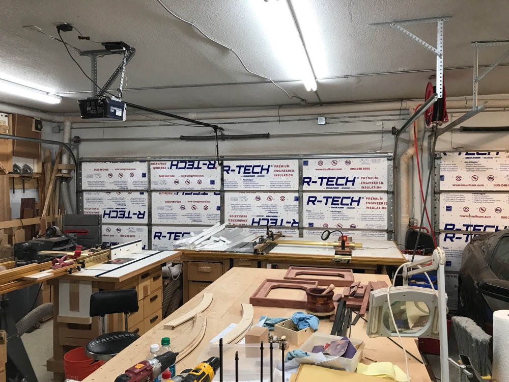

Post by masonsailor2 »
I finally got around to insulating the garage doors which worked really well. The AC units in the shop are running quite a bit less. I opted to buy the 4X8 sheets of the 1 1/2" thick foil backed foam and cut it to size on the table saw instead of the precut kits available. Very simple to install but now I have tiny pieces of foam every where. I am going to have to do the Bill Murray method and open the doors and use the leaf blower. Time to dedust anyway.

How did you attach them to the doors? Glue?

There was no glue required. The doors are made with metal channel that is designed to accept 1 1/2" foam so you just cut to size and pop it in. Very easy except for the window area which took slightly more work. The results are really dramatic. There is probably a 20 degree drop in the temp during the day. As far as the car, well it's a point of contention at the moment. I build the awning out back to park it under with a cover on the car but one of the neighbors managed to tell the wife that rats got into a car they stored in that manner and chewed up the wiring. So now it still remains in the shop. It is her baby and it's a fairly rare and valuable car and I know I'm not going to win this one. More impetus to get my shop built I guess.
Paul
