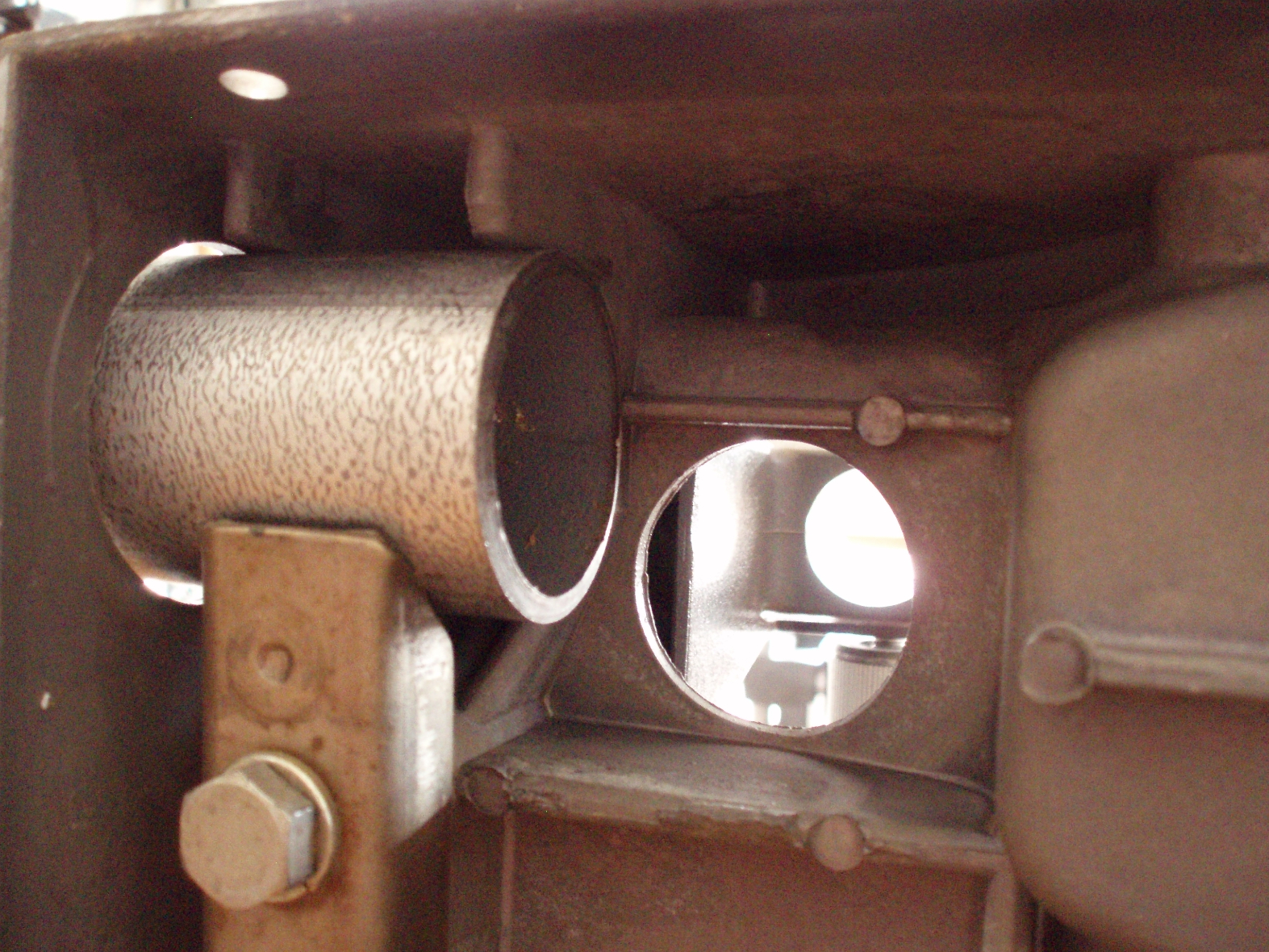

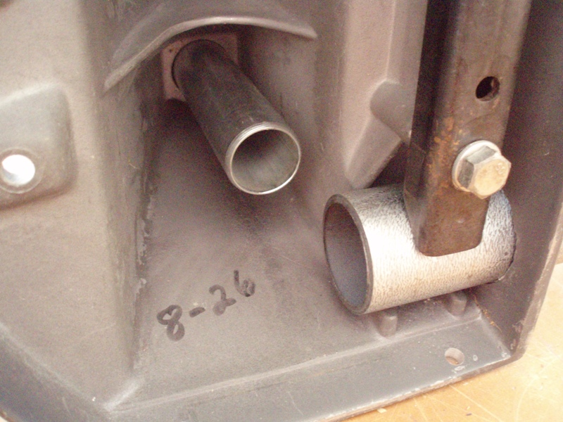

The Bench Tubes, when properly inserted, will just barely clear the extension table legs when the extension table legs are inserted into either the Headrest or the Base.
You can see this relationship between the Bench Tubes and Extension Table legs by simply peering down into the holes where the Extension Table is mounted or laying on the floor and viewing from beneath.
However, the relationship between the Bench Tubes and the Way Tubes, when in the drill press mode, should not be an exact 90°. It is designed to have a slight tilt beyond 90°.
- Inserted but No Mechanical Stop, Align with Extension Tube
- Base and Bench Tube Limited Insertion.jpg (202.36 KiB) Viewed 7826 times
- Inserted to Mechanical Stop
- Desktop 010.jpg (2.35 MiB) Viewed 7826 times

Thanks Dusty. The pictures tell the tail.
My SS is back to 90 degrees. The lower tubes were loose from all the moves I've made in the last few years The mechanical stops were worn down quite a bit from all the movement. They still had enough bite to line up properly after I tightened them down. I raised the bars after I flipped it over and it's just passed 90 degrees. SUCCESS. Now I just need to put the thing back together. I took the motor and shelf off so it would be easier to work with. I'm over 71 and have back problems so it is easier to lighten the load when I am working with heavy stuff on the floor.
Just an observation. If you are moving your SS any great distance it might be a good idea to take the legs off to prevent damage to the mechanical stops (if yours has them) on your SS. I think all the moves I made messed up my mechanical stops.

I am curious what you are referring to as 'mechanical stops'.
Re: Drill press not at 90 degrees
See Dusty's last picture above. He calls them "Mechanical Stops". Some of the bases have them and some don't (see both pictures) pictures. My machine began life as a 520 so it has the "mechanical stops" he refers to.JPG wrote:I am curious what you are referring to as 'mechanical stops'.
