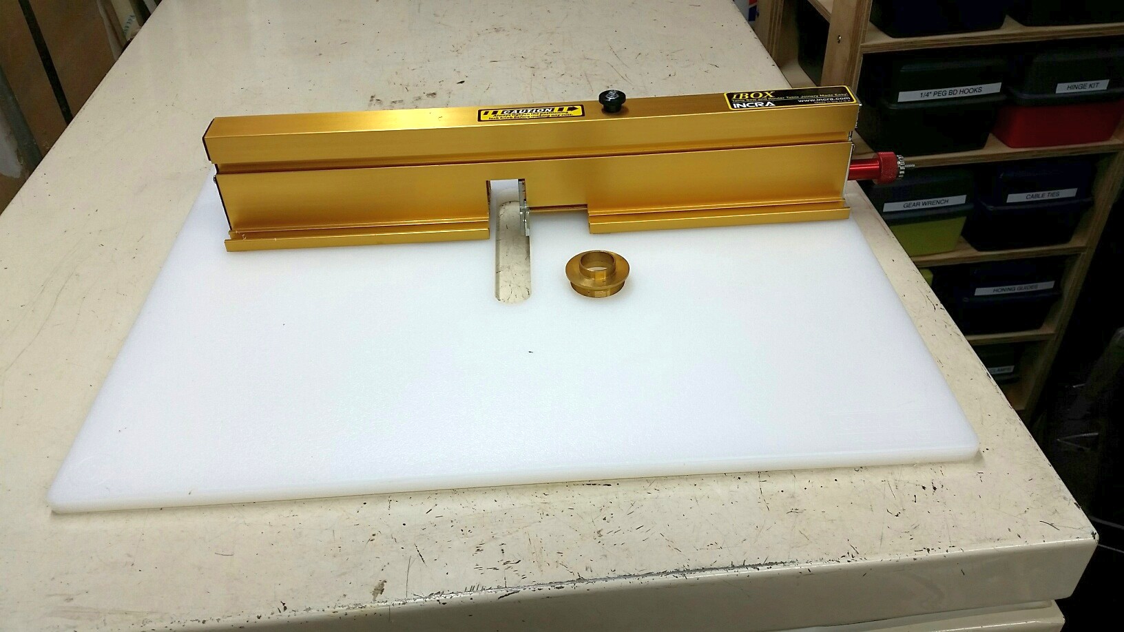

I started work on this months ago and never finished it. Tonight I needed a piece of cutting board so I pulled it apart. Not sure it will ever get finished but I'm sharing the idea in case someone else wants to work on it.

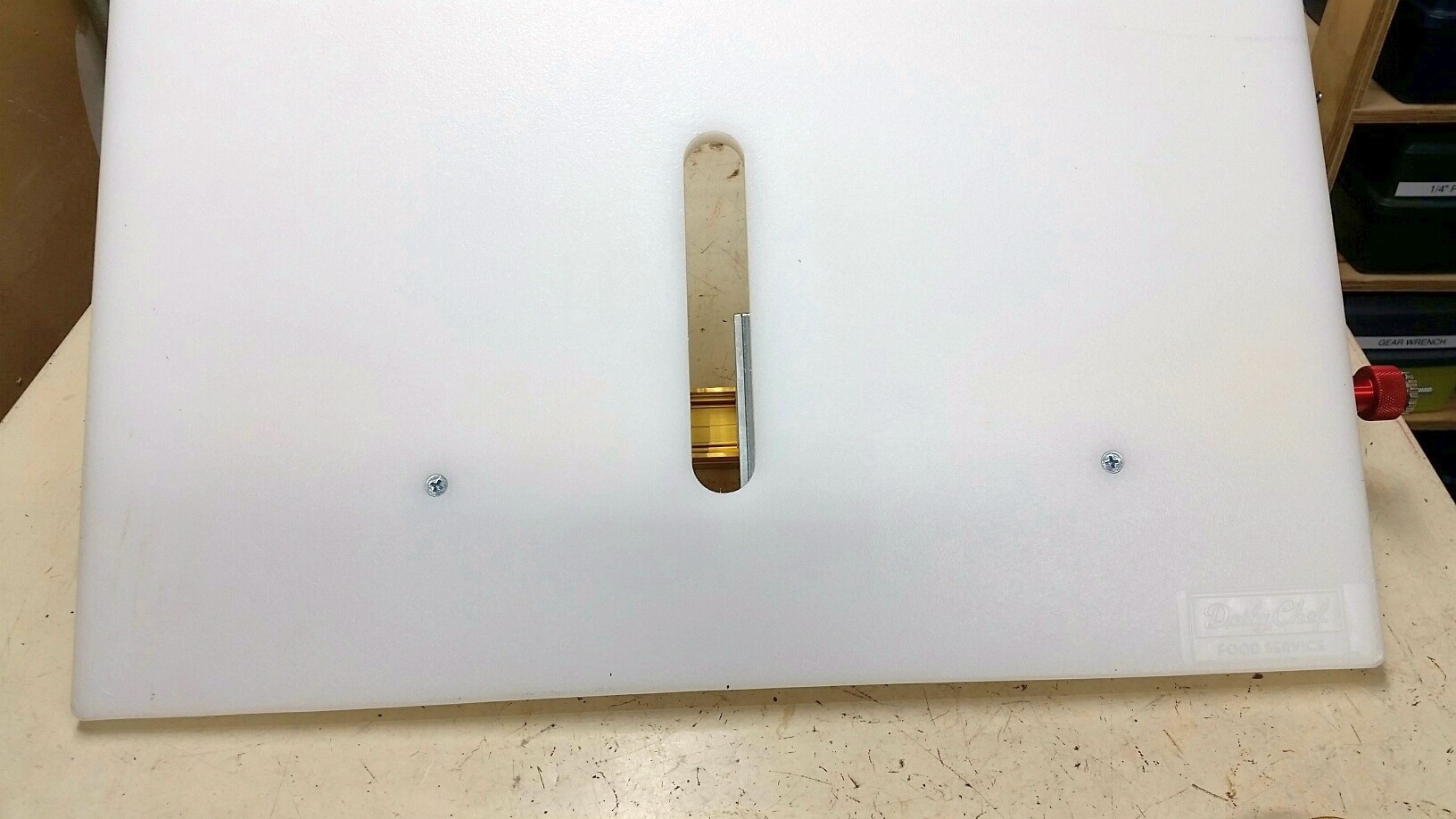

It is a cutting board from Sam's Club with a 1" slot cut in it. There are two screws to mount the i-box jig and that is about it. You simply mount a guide bushing in your router table and then that controls the jig. It is really simple but you have to get the slot right.

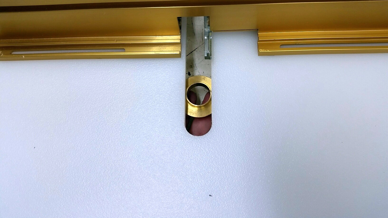

The 1" guide bushing is a sliding fit in the base of the jig:
Like I said it has just two holes to mount the jig, t-nuts from the jig along with the two countersunk screws.

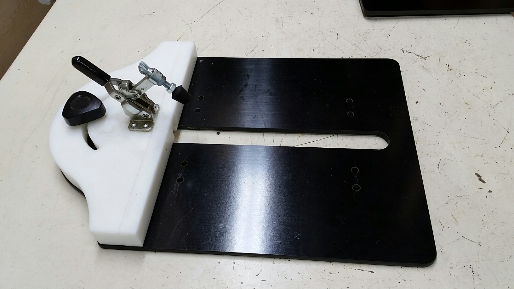

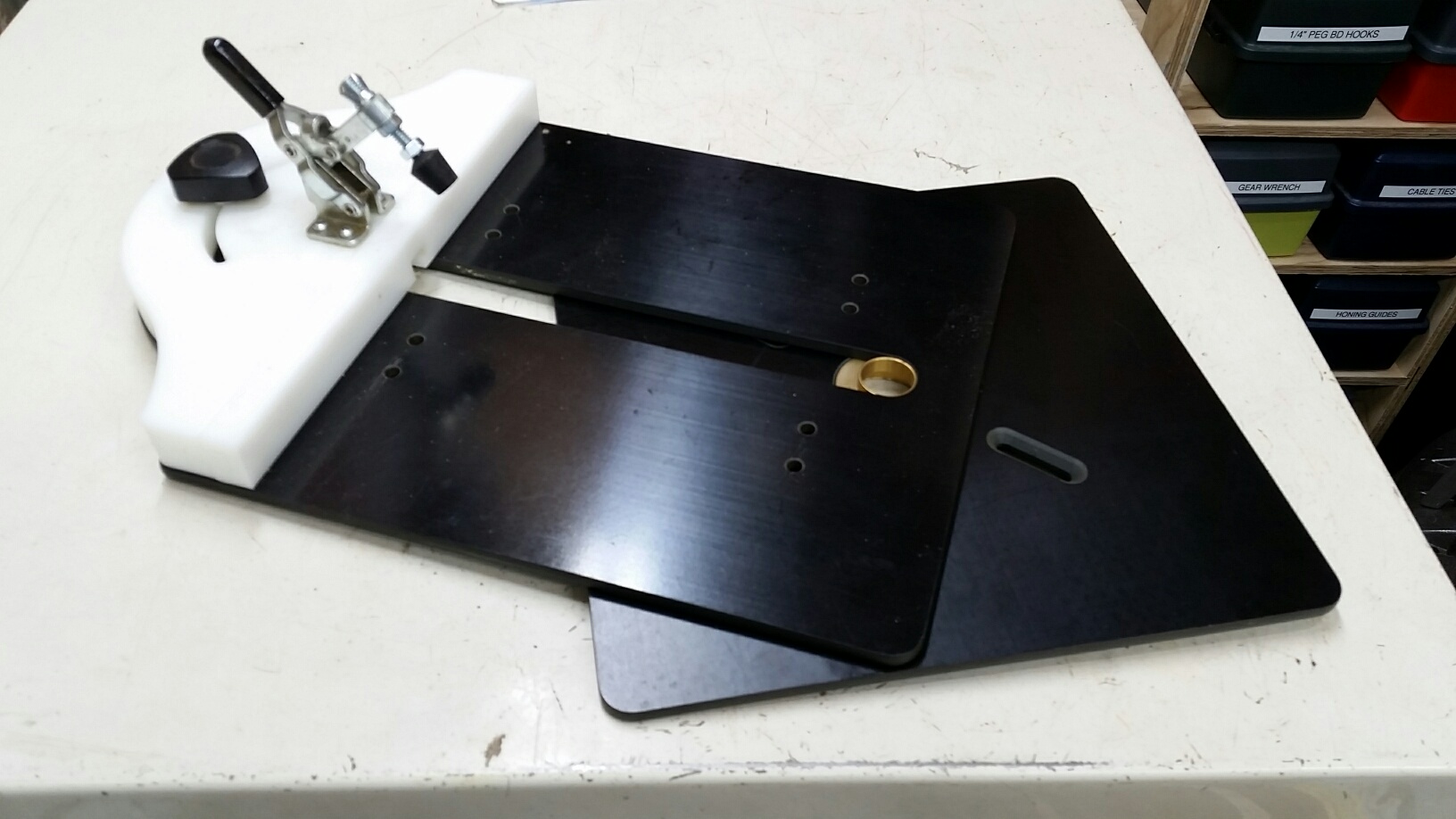

So in that light here is a miter gauge they use to sell, the makers mark:

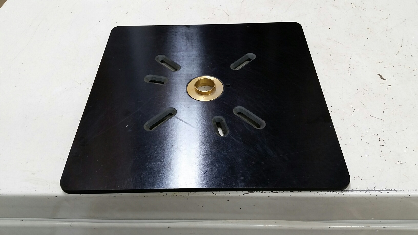

I don't feel like setting up a router table so lets see how this goes just showing the mounting plate that the router attaches to and go from there. Now just to be clear the router is mounted below, the router and plate fit in to a table. The plate has a guide bushing inserted.
This is the miter gauge from Oak Park, it has a replaceable strip along the front edge and some holes for an attachment and of course the clamp to hold the stock in place.
Now the jig with the slot just slides and is guided by the guide bushing in the table/mounting plate.
