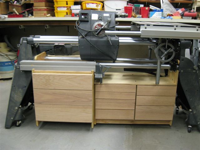

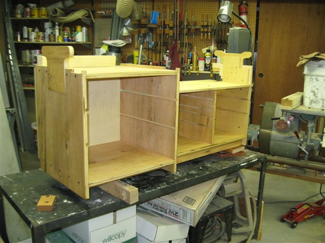

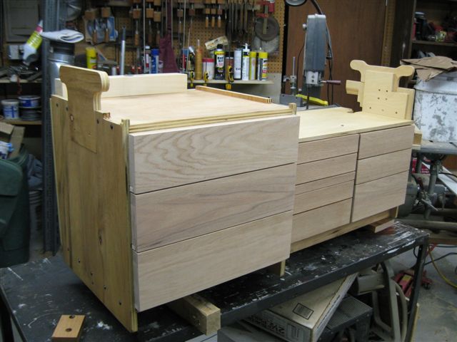

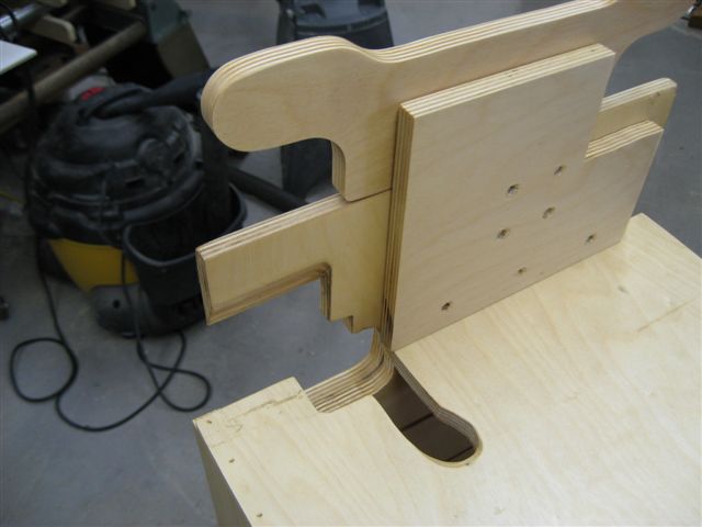

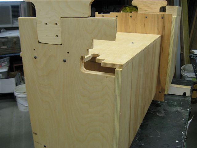

Re: 3D SketchUp of the "Under-the-Mark V" Accessory Cabinet
Here's what I did back in 2008. Hopefully there are pictures(first time to try attachments) Still in service today. It has aged better than medamagi wrote:Now...perhaps a v3 specially designed to accommodate the lift assistAnyone?
- IMG_0466.JPG (58.18 KiB) Viewed 16563 times
- IMG_0471.JPG (63.51 KiB) Viewed 16563 times
- IMG_0472.JPG (36.87 KiB) Viewed 16563 times
- IMG_0473.JPG (39.02 KiB) Viewed 16563 times
- IMG_0481.JPG (56.63 KiB) Viewed 16563 times
Larry Hargrove
Rock Island, Ok

larryhrockisland
- Posts: 278
- Joined: Sun Aug 19, 2007 10:47 pm
- Location: Rock Island, OK
Thanks. I keep the universal lathe tool rest in the bottom left drawer and with the jointer on the back everything is rock solid, maybe too much so when retracting the casters. Pretty heavy kerthunk when it lands. I do have the premium casters now so it is still easy to roll around.
