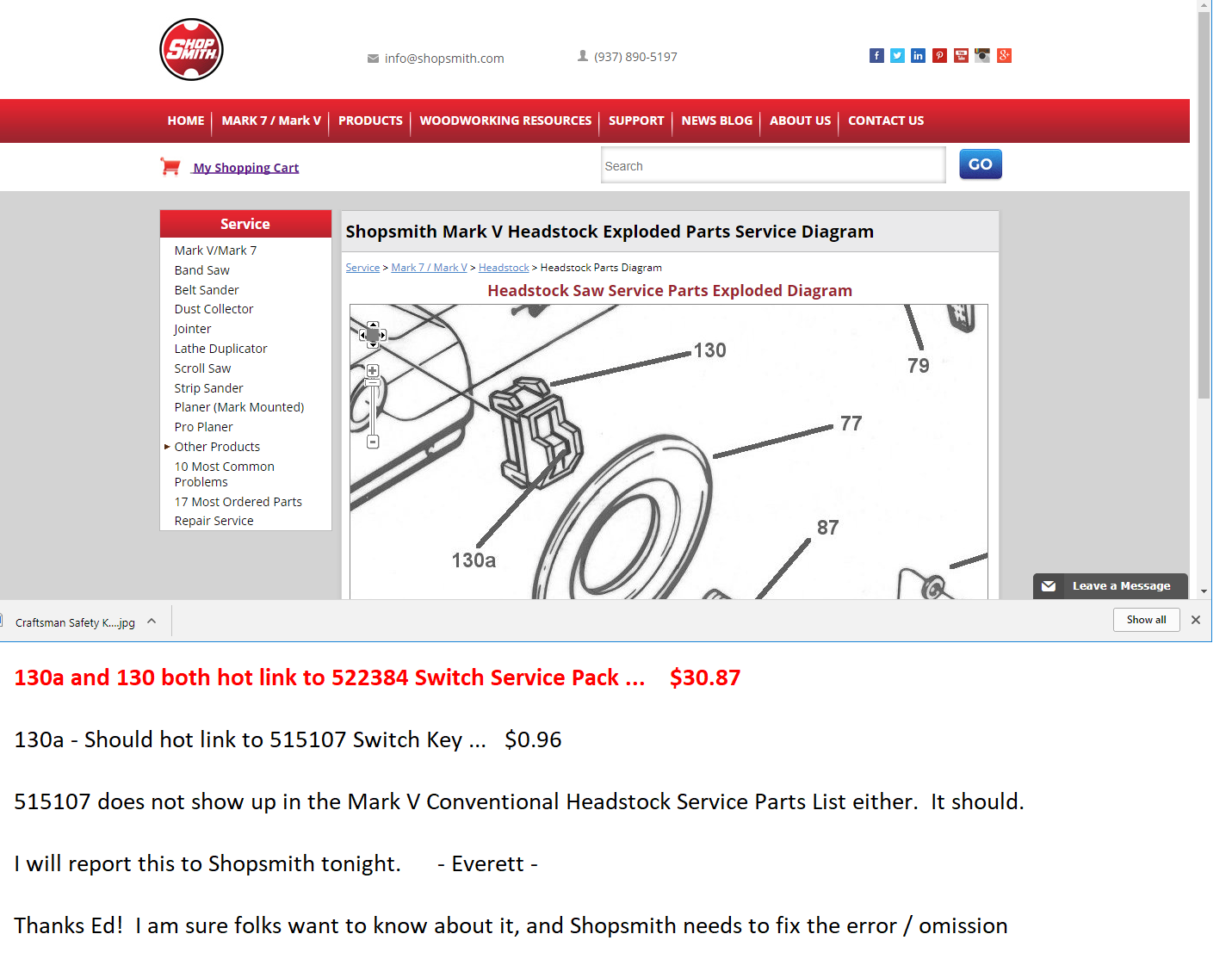

Re: Headstock safety switch — need a key
Try part number 515107. Did a search on the site and:
http://www.shopsmith.com/ownersite/item ... tem=515107
everettdavis
Posts: 2163
Location: Lubbock, TX
Post by everettdavis »
Thank you very much Ed!
I found the error on the web site that suggests that this may have been going on for a long time.
I will notify Shopsmith tonight.
The only place that I found that it shows up is in 34a 515107 Switch Key for the DC3300 Dust Collector Switch. Since I don't have one of the DC3300's I have no point of reference to say it is physically the same.
Either way I will reach out to Shopsmith to correct the error and add the appropriate part number for the key, and to order them from Kedu if they don't. Clearly they list 130a as a specific part and they should supply it even if they have to 3D print them.
Everett
Error in Parts Web Page Shopsmith Safety Switch.png (277.07 KiB) Viewed 8441 times
