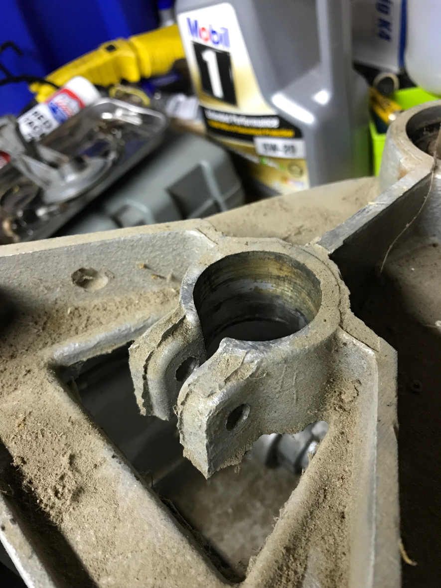

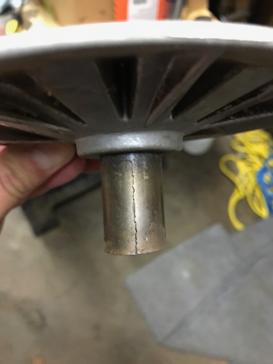

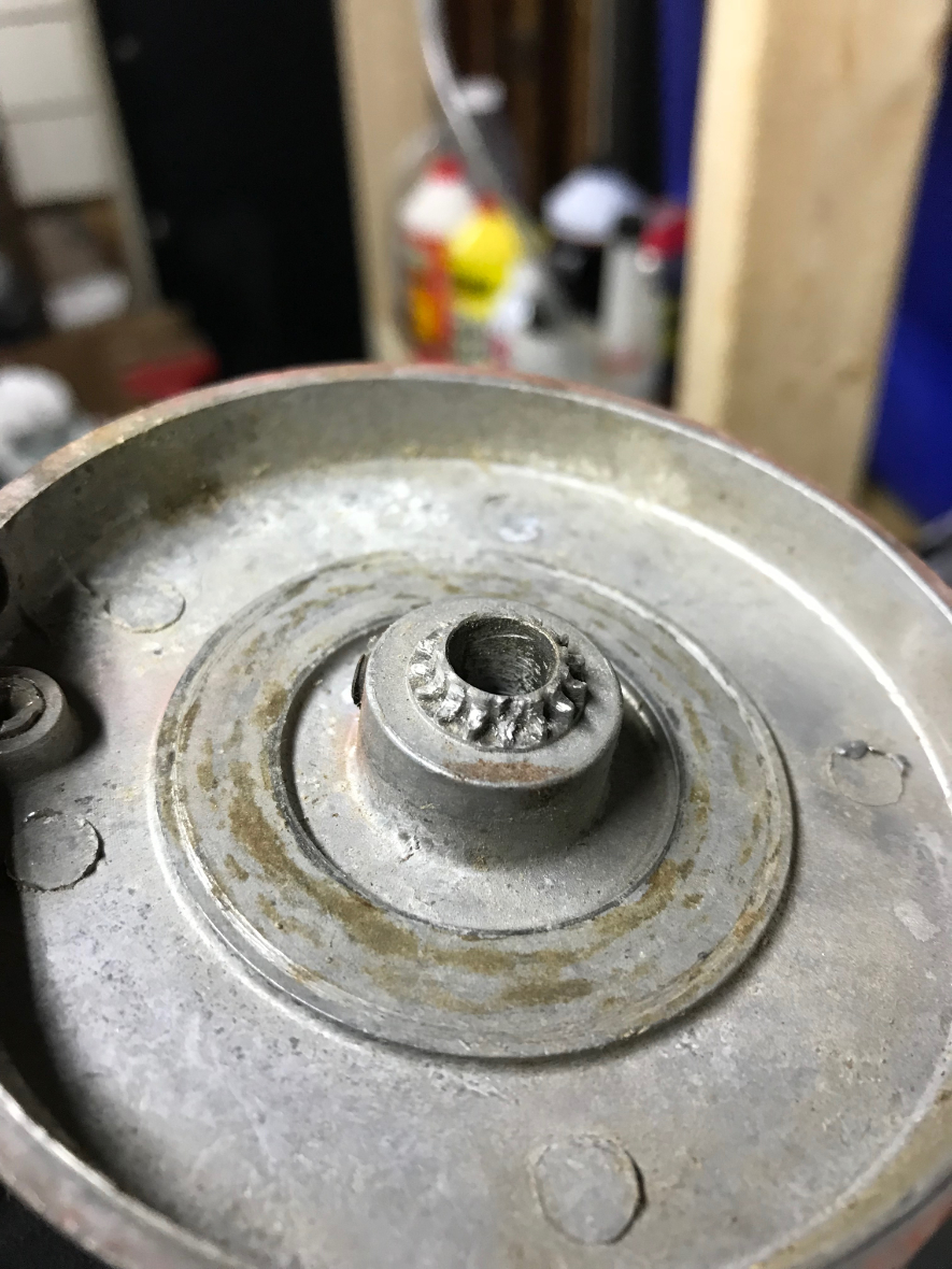

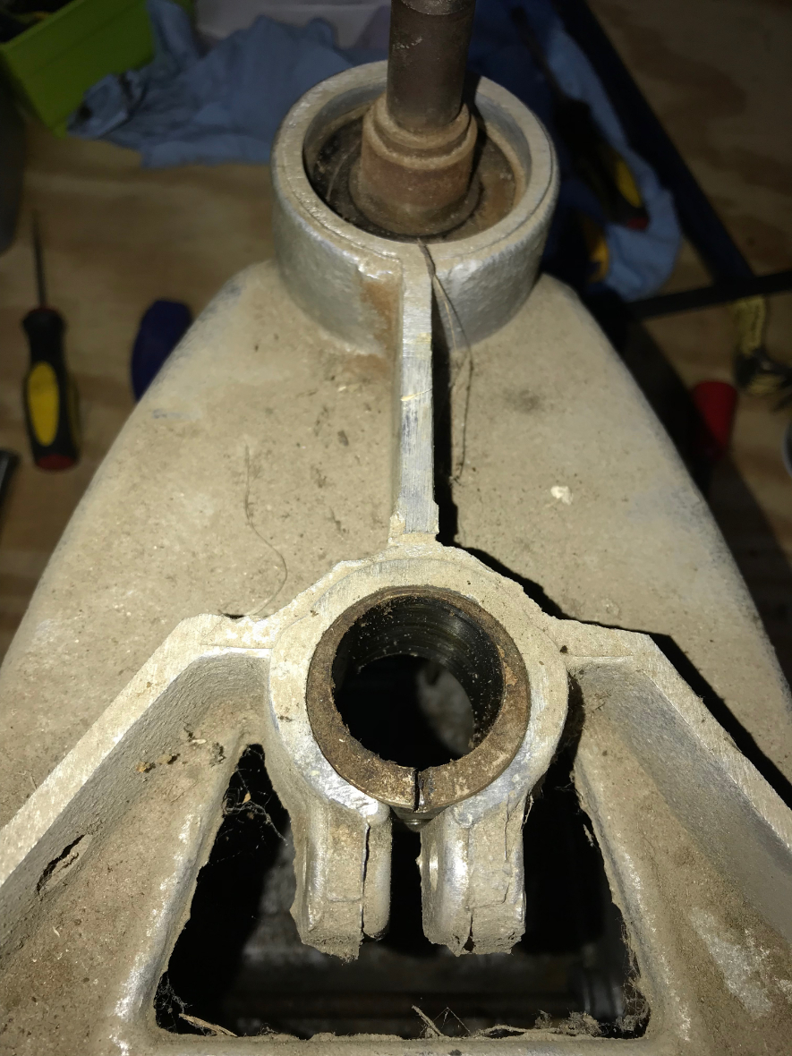

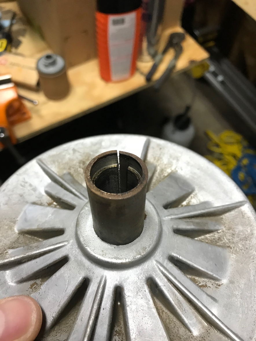

I recently got a 1954 mark V greenie that sat in my dads garage for years. It needs work...after taking it apart it needs a new idler assembly and sheaves (one thats on it is cracked), the retainer clip that holds the eccentric bushing to tension the belts is gone, and I need arbors and a quill but can get them off of eBay. the things I need help finding are the idler assembly (both sheaves really as I can find the shaft on eBay with new bearings) and the eccentric bushing retainer problem. My understanding is the the old ones like I have used a bolt and metal clips to hold the bushing from moving in the housing. the new style just use a bolt and washer on top and then the bold that pinches the ears of the case. can I just go with the bolt that pinches and add a bolt with a washer to hold it on top or do I need to find the clips? thanks for any help and if anyone has a bunch of greenie gilmer drive parts let me know. oh and also it needs to have the speed control knob fixed/replaced...there is a guy in cali that repairs them with a steel gear instead of the aluminum so think that is the way I was going to go for that. thanks for any help. I have attached photos for reference.

The guy in Cal does excellent work. I would prefer one rebuilt by him to a new one.
The current Mark V control sheave is interchangeable with the greenie Mark 5 control sheave.
The idler sheave is unique to the Gilmer drive.
A screw may be carefully added at 12 o'clock to prevent the eccentric from slipping out. I would use a small screw with a large washer(not much material for drilling/tapping).

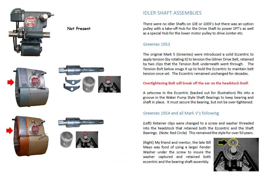

Just a heads up. I extracted a screen shot from a section of a page I am working on documenting Shopsmith Bearings. Be careful with the bolt that goes through the headstock ears that tension the eccentric on yours. See
http://www.shopsmith.com/ss_forum/viewt ... 69#p239169 See photo.
You may like to download the bearing file which is a work in process that's ongoing, and download the Buying a Used Shopsmith PDF from My Google Drive. See http://www.shopsmith.com/ss_forum/viewt ... 90#p185690
Everett Bill Mayo was also fond of putting a compression lock washer under the bolt. Tightening it to the point the washer flattened was tight enough, no more or you risk breaking off one of the ears, requiring a new headstock housing. - Ev -

ok cool so the control is the one that is toast so I'll order a replacement. And I didn't know if adding the screw for the eccentric at the 12 o'clock position would require a new bushing. the one that is in there seems to be fine was just wondering. And since the machine is older than my father I was planning on replacing all of the bearings. thanks for the input.

Re: Mark V Greenie rebuilding
When I referred to 12 0'clock hole tapped, I was referring to the headstock casting, not the eccentric. Later(B,C) headstocks have greater width at that location for a tapped hole.SethJGibbons wrote:ok cool so the control is the one that is toast so I'll order a replacement. And I didn't know if adding the screw for the eccentric at the 12 o'clock position would require a new bushing. the one that is in there seems to be fine was just wondering. And since the machine is older than my father I was planning on replacing all of the bearings. thanks for the input.
