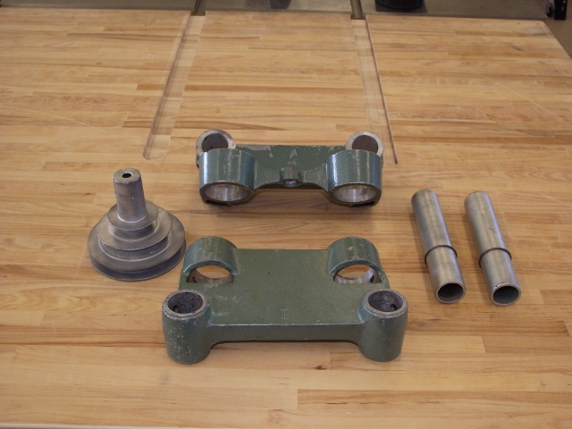

Yes it is but you won't like what it costs. Magna sold a set of adapters (after they came out with the MK V) for the 10ER that would allow you to use the MK V SPT's on the 10ER. They are VERY rare. I have a complete set that I got on eBay a few years ago and it is the only complete set I have ever seen. I paid $290 for it as I remember. The individual pieces come up occasionally but are very rare also. Skip Campbell of MKCTools makes an adapter and the head stock pulley at $95.00 each.
http://mkctools.com/10erparts.htm

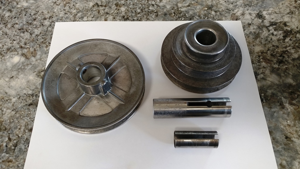

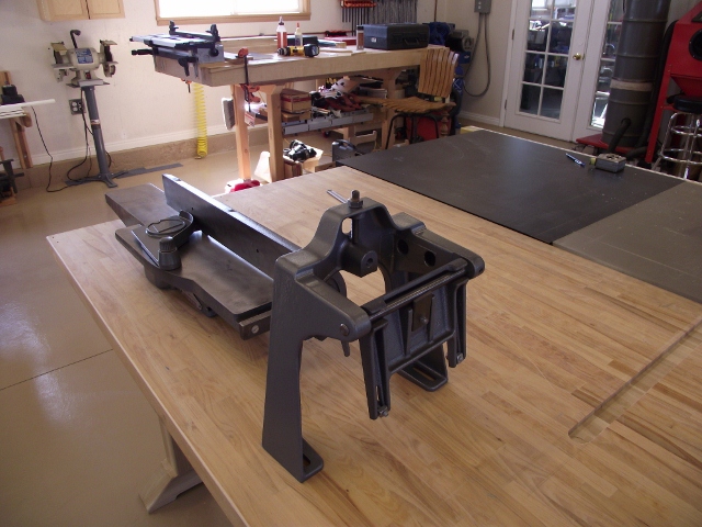

Magna started the SPT tool idea with the jig saw. They are very plentiful as it seems most who bought a new 10ER also bought the jig saw accessory. The only other SPT Magna made for the 10ER was the 4E jointer. They are also very rare. You have to have the jointer and the replacement head rest along with the pulley adapter and pulley for the motor. I have never seen the complete set offered. The jointer or the head rest come up occasionally. The motor pulley and shaft adapter are VERY rare. After years of looking I finally scored a complete motor pulley set. You have to have the complete set as the original 3 step motor pulley must be replace with with one with a larger bore to accommodate the shaft adapter/sleeve to mount the jointer pulley. Skip Campbell also makes one so see the link above.
DSCF0886 (640x480).jpg (239.01 KiB) Viewed 6677 times
DSCF0890 (640x480).jpg (266.16 KiB) Viewed 6677 times
