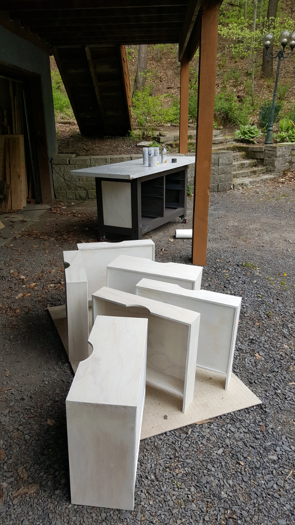

The bench below started as a repurposed metal shelving unit. It was an experiment but I decided to keep it. The table top is a solid core door split in two. The metal frames were clad with 1/2" plywood for the doors and sides to reduce the visual clutter of having things exposed on the shelves. I still need to add rear panels on the left side.

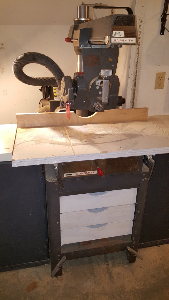

For more storage space, I made new Sawsmith drawers with 1/2" plywood. They slide very well with the help of paste wax. It's nice having the RAS accessories right there where you need them.
I adapted the drawer design into my main workbench. Again, I opted to use left over shelving steel instead of traditional drawer slides. Prior to this, the area beneath the workbench was open and prone to clutter. Now I can store things like tape or glue well within reach.

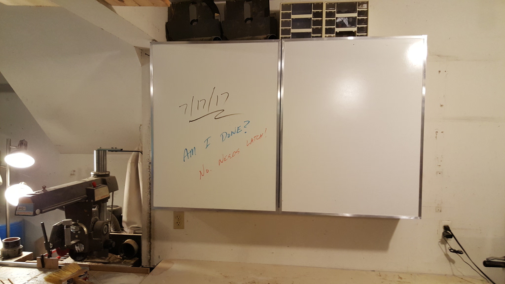

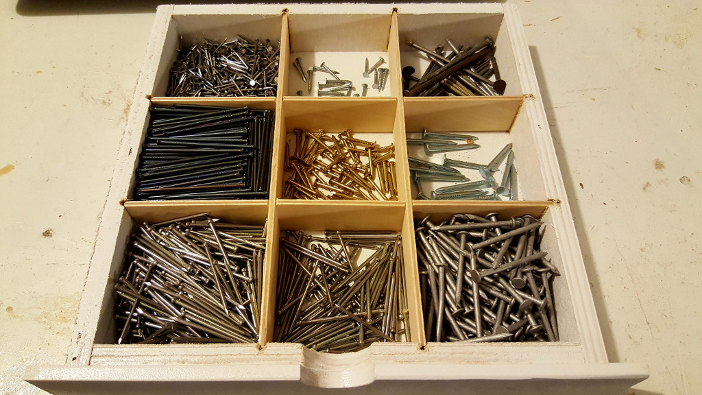

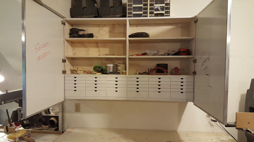

This is my attempt at a multi-purpose wall unit. It helps organize and store small parts in removable drawers, provide additional cabinet space for other junk, and provide whiteboard space to use as needed. It's a lot of utility in a small space.
The inset cabinet doors below were replaced in favor of the whiteboard doors.

Thanks guys. The wall cabinet did take some time but that's part of the fun, right? It was built using my Shopsmith 510, Sawsmith, and a small homemade CNC machine which was also made with my Shopsmith.
The payback happens every time I can quickly locate an item stored in the drawers or scrawl something onto one of the white boards. I look forward to seeing what jeremysavoy puts together and hearing how his solution works for him.
