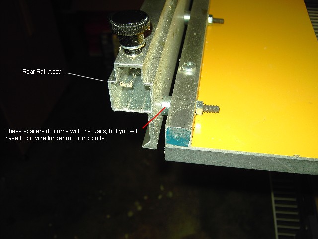

Post by curiousgeorge »
John,
Yes, you will have to provide something to mount the rails to. In the attached pics of my Jointech router table you will see that mine have aluminum bars that came with the table. You can use what ever you want, but aluminum is readily available and easy to work with.
George

curiousgeorge wrote:John,

dusty wrote:Thank you, George. You answered my question before I asked.
How did you determine the vertical location of the rails?
I used the alum. spacers that came with my 510 to 520 upgrade.
