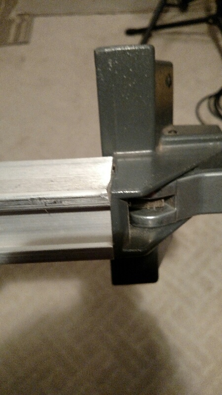

Thanks. Not interested in the incremental scale, just a fence that locks relatively square.
My 510 fence has never squared to the table since it was purchased in 1987. It seems there's an issue with the extrusion. I contacted SS again a few months ago, but they have indicated that it looks like mine is damaged, despite the fact that there's no way to damage that spot, in that way, without completely disassembling it. And yes, I am fully aware and familiar with adjustments and using or removing the set screw all together.
SS has offered for me to send it to them for an assessment. However, I never seem to have a time when I can do without it for any period of time. It is also cumbersome to clamp a straight board or other temporary fence.
Even with the set screw completely backed out, the fence has a pretty severe angle making it 3/32" off or more on the other side of the table. In order to cut anything straight, I have to put it in a bind. As a result, I often have to reposition it in order to get my right distance from the blade for the cut. Because this is so much drama, I often use the carraige to reposition. However, this operation means I lose a lot of accuracy since I also have to loosen my stablizing tubes to avoid deflection or tilting of the table. I know it isn't much, but with my projects, it can have a significant impact as the error continues to compound itself, by a factor of 30 at times.
Ultimately, I don't want to pay for parts to help repair the fence which is clearly not operational without major effort. As such, I'm looking for a viable alternative. Since I've been cutting fairly dry hickory as of late with one of my projects, the vibration is causing the fence to slip. That's why, now after all of these years, I'm ready for an alternative.

If you haven't already done so, you might consider posting a pick of your problems. People around here are pretty good at diagnosing and offering suggestions for fixes. One thing is for sure, repair it (even if you need a new extrusion) will probably be less expensive than any aftermarket fence.

The other option might be checking eBay for another fence, then with another one to use send yours back to shopsmith for evaluation.

It is difficult to see, but I have loosened the locking mechanism to show the issue. When the one side mates to the surface, it introduces a cant and an overall angle. Haven't measured the degrees, but there's no way to shim and because the difference is so much, it isn't really an option to file the opposite side.

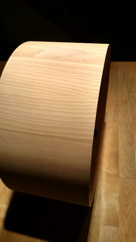

Here is an example of recent work with the hickory. Since this has 16 staves and 32 mating edges, even small differences can really create a headache for me.
