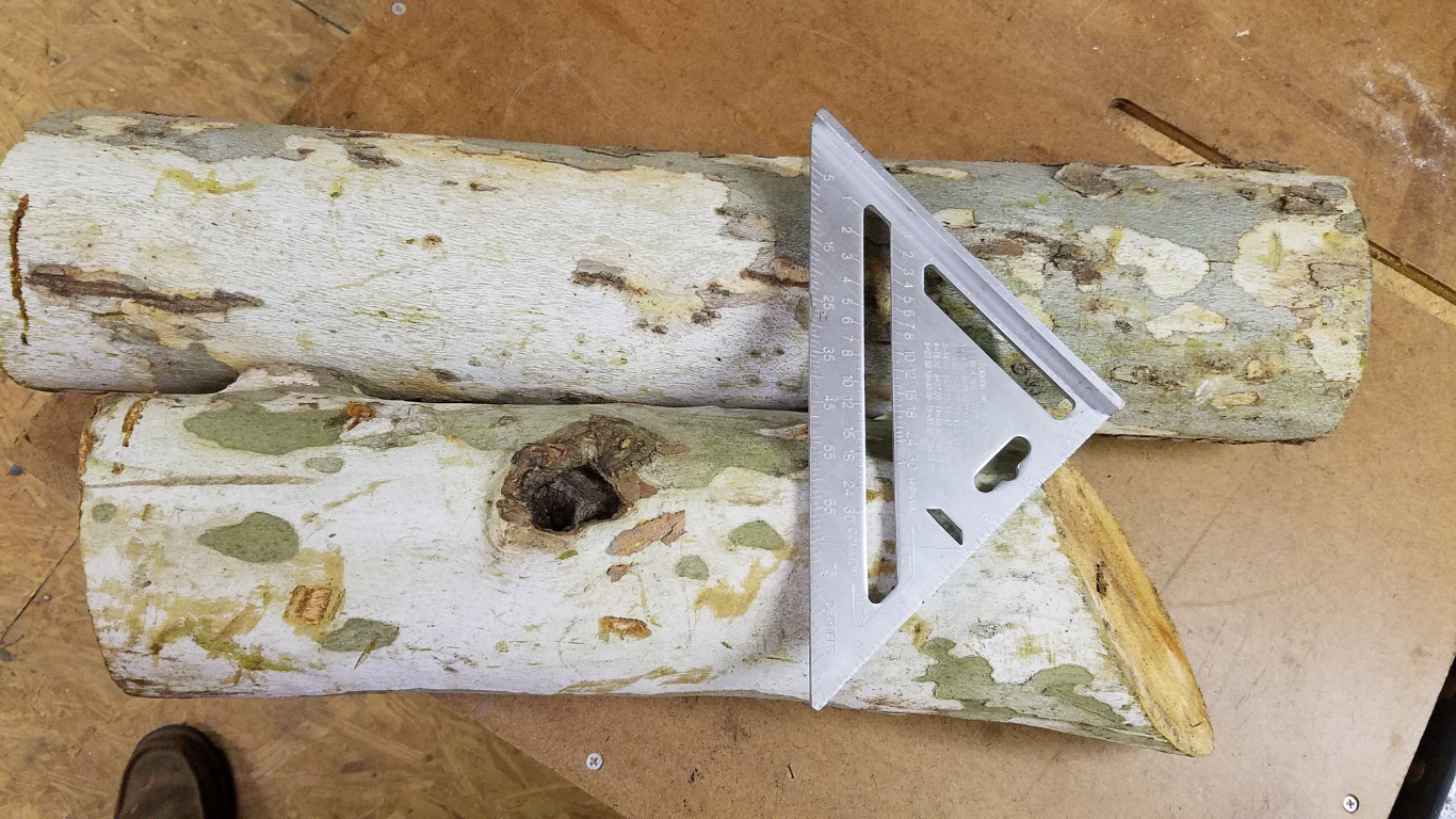

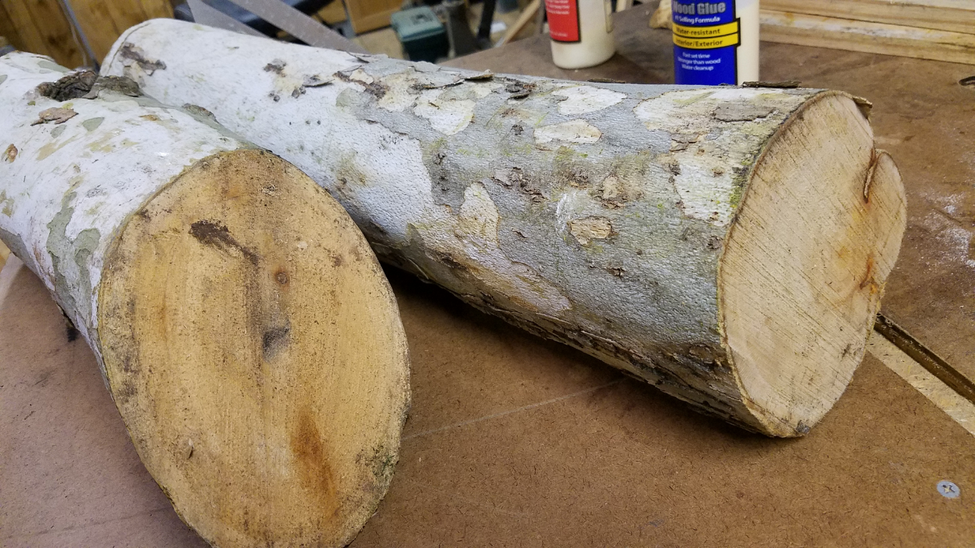

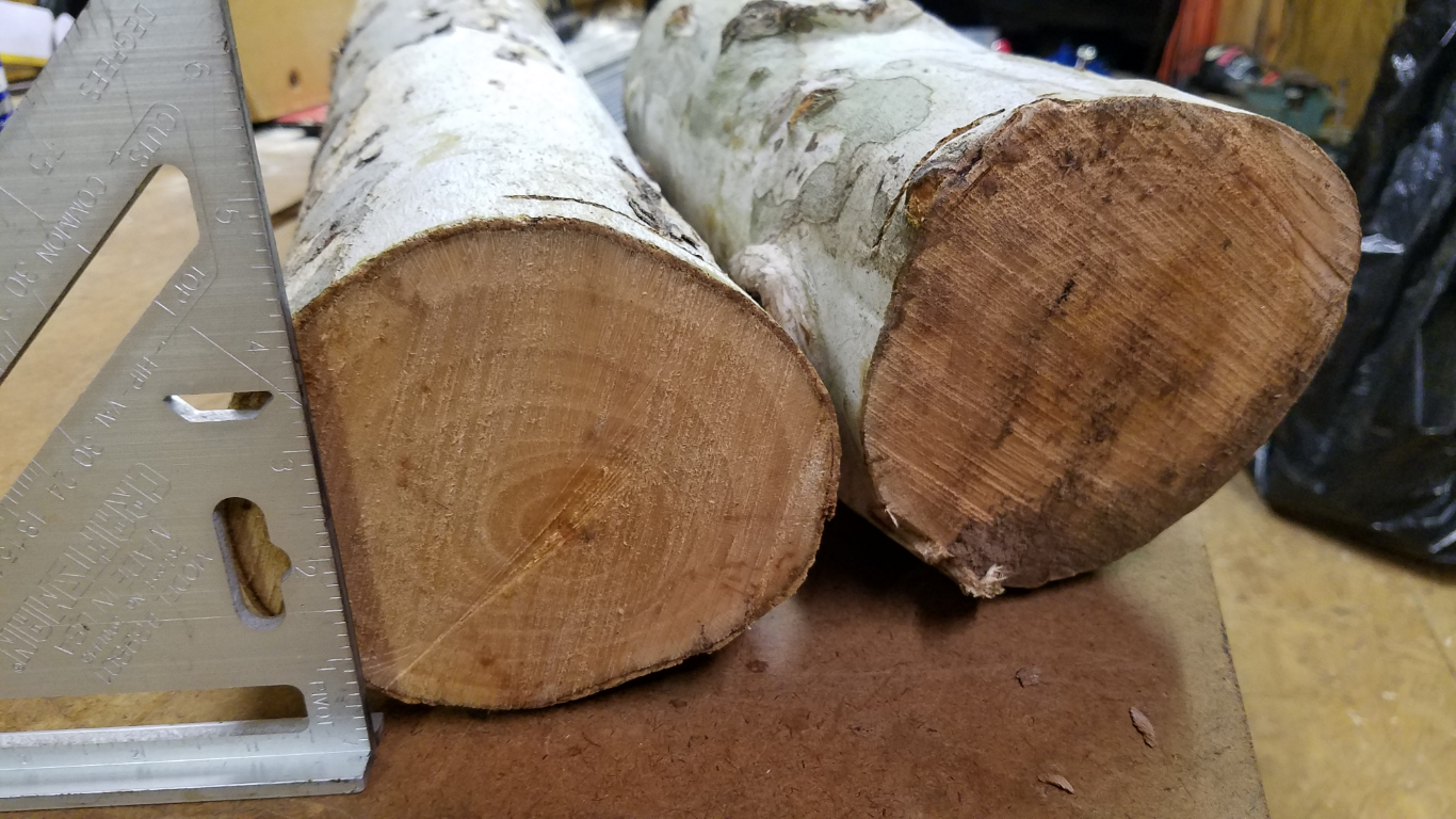

I was given these sections of Beech limb and I'd love to do something with them, perhaps a turning project. But I haven't done much turning. So I need some "beginner" level ideas and direction. I think the wood is pretty green still.

How old/seasoned is it?
Re: What can I do with this Beech wood?
Still pretty green.

As the wood dries, it will want to crack about the pith. So unless you want the cracked/rustic look (probably not a good choice for a novice turner), you want to cut it into pith-free blanks before it dries. Bonus: the thinner pieces will dry faster.
But now you’re left with some pretty small blanks. You could turn some teacups, but not much of a bowl.
Beech is quite hard, similar to maple, and so it makes good handles. Your blanks would be a nice size for that. How about a nice set of long handles for your lathe tools?

You can rough-turn the blanks while they’re still green, and they’ll dry even faster. Then finish-turn after they are dry, and dimensionally stable.

Seal the ends of the logs, so that uneven drying doesn't split them. Anchorseal is the gold standard for this, but ordinary latex paint reportedly works fairly well also.heathicus wrote:Interesting idea about tool handles. I've got some files and rasps that could use a handle.

Jut a suggestion , get the bark off first,,,,,, you can then 1/4 it ,, slice it ,what ever you want ,,, then dry it .. both will help to avoid splitting ,,, then when ready to use it,,, cut strips and glue the pieces for the lathe.
Or just allow it to dry and see what happens , it my not split too bad just the way it is , ya just never know .. , I made a cabbage smasher for making sour kraut out of a beach limb and it hasn't split .

Looking at the wood it doesn't look to be too green, grain in some wood is much tighter,,smoother ,,the grain doesn't appear wet ,, green wood tends to bleed,,,,seep water,,, on the ends .
