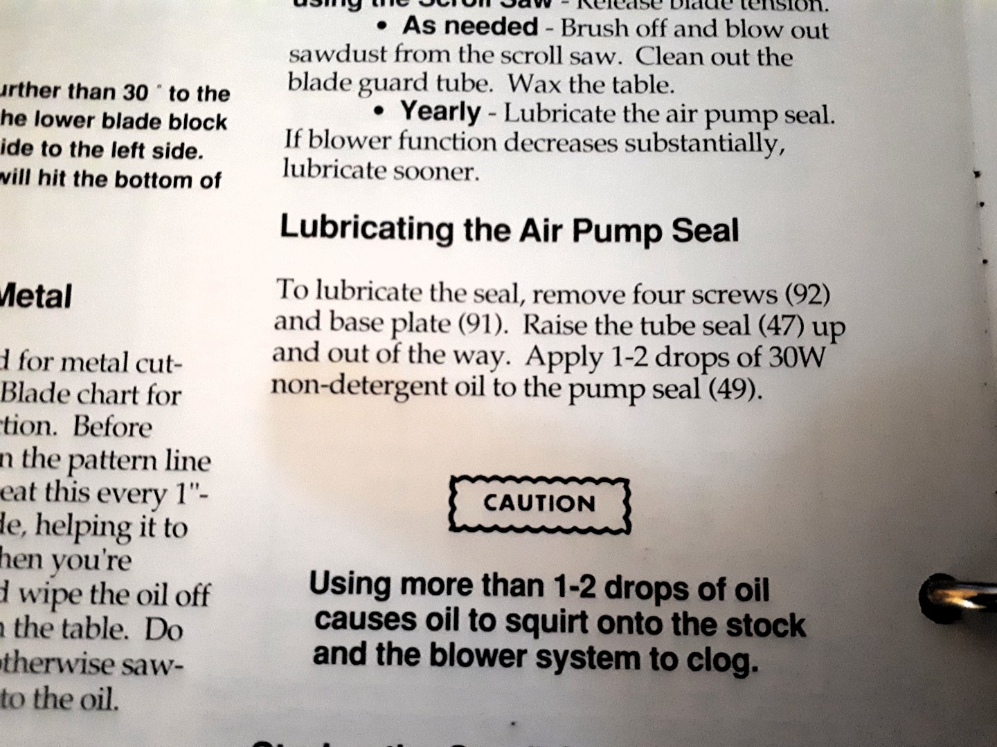

Oil the pump seal and see if that makes a difference. See the manual, it is in there.

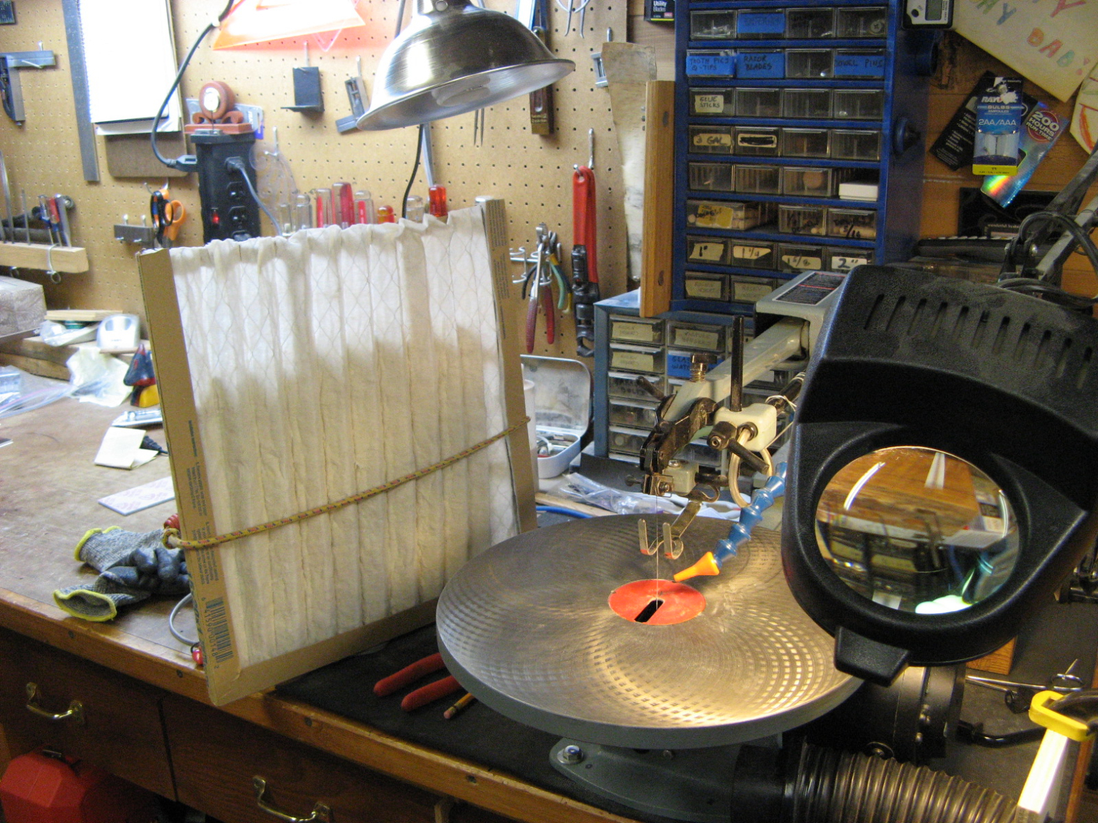

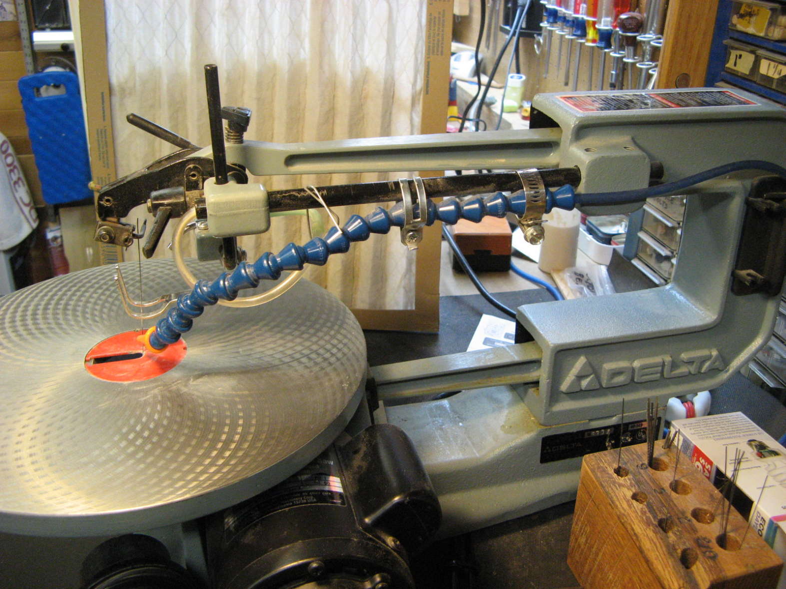

For years I had a Delta scroll saw with a terrible dust blower. I took the route Ron suggested. I got a garage sale aquarium air pump, I think it was $3.50. I ran a small tube through Loc-Line which attached I attached with hose clamps to the saw. I think you can make it out in this pic. Under the table I have my SS dust collector attached. This set-up worked really well. I could position it as needed and adjust the blower for how much air it moved.
