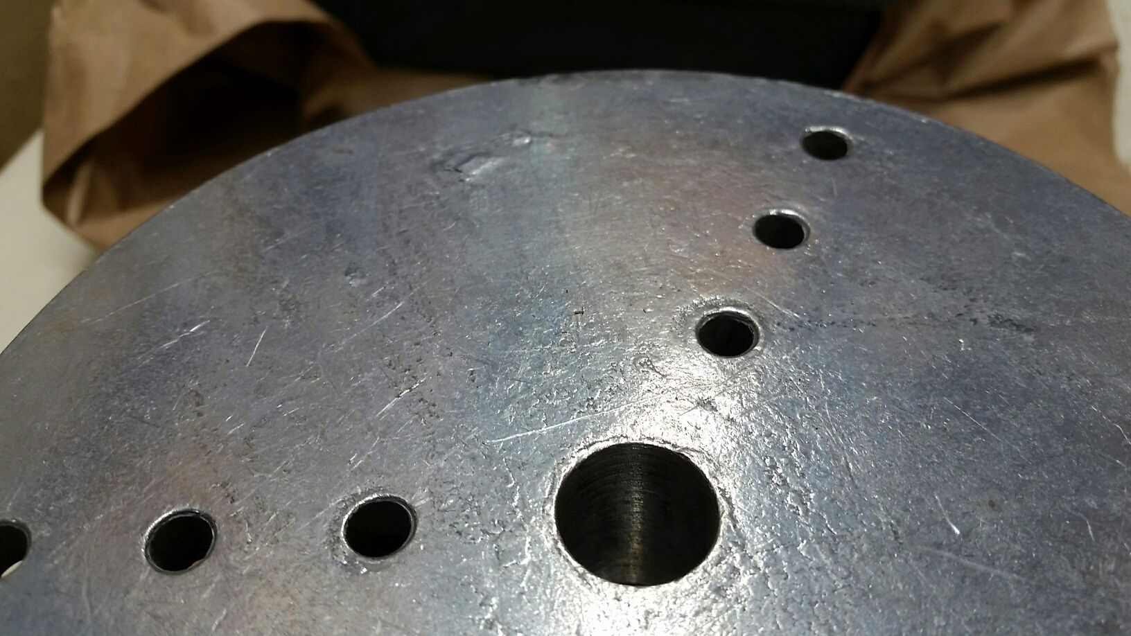

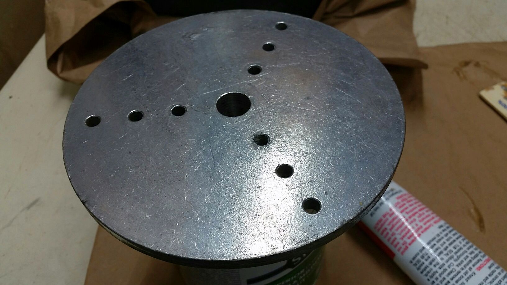

I don't think these are die cast, to expensive to do but just the same they are cast how how it is done does not matter. Here is mine as photo proof the surface is not nice and smooth and likely not flat either. It doesn't mater for lathe work as you mount wood to it then flatten that before mounting the workpiece in most cases.

I've never had the need to "fix" it but it could be done just like I did my smaller version.
Just don't expect too much from the product if you are not using it as intended.

Good information and a good warning. The face plate shown is definitely not suitable as a reference surface for critical alignment purposes and it was not intended to be used that way.
But, it also does not look as though it was milled. The face plate advertisement in the new catalog states that it is milled, balanced and wobble free. That may favorably effect its usefulness as a reference surface.
A similar photo of the new face plate is needed.
