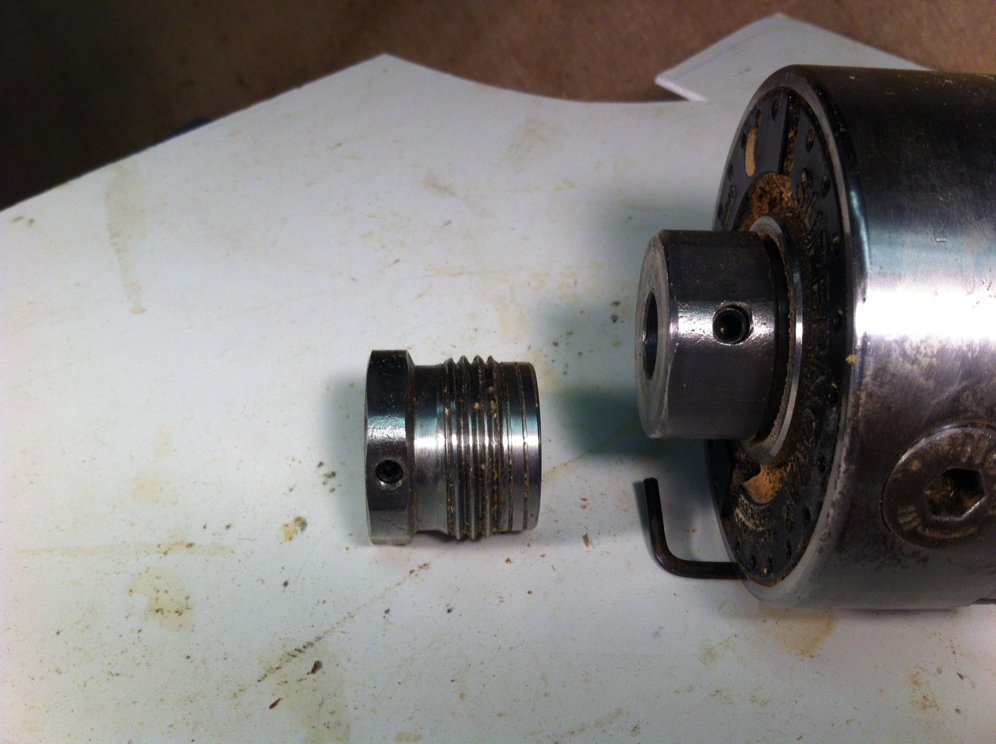

This photo shows the proper Shopsmith adapter mounted in my SuperNova2 chuck and the generic 5/8" Nova adapter. Note how there is an unthreaded nose that extends into the body of the chuck. The PSI adapter doesn't have that even it was the right size.
Teknatool F and S adapers.JPG (286.26 KiB) Viewed 15653 times
Get the proper Nova adapter that reible listed above, then you will know that it will work properly. :cool:

Ron,
Thanks for info & photo!
