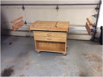

Final Pictures with removable outboard supports for miter saw. Bolts slide into dog clamp holes. Lock nuts for height adjustment.
Miter Saw Supports.jpg (27.88 KiB) Viewed 4337 times

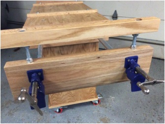

Height adjustment w' carriage bolts
Miter Saw Support Detail.jpg (31.17 KiB) Viewed 4337 times
