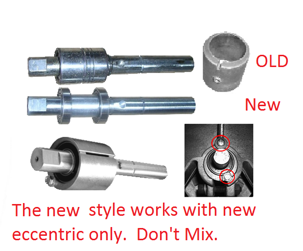

A picture is worth a thousand words....
Don't over tighten the tension bolt below. Easy to break off mounting ear.
If you use a split compression washer to lock, getting it to flatten out is just enough tension.
Everett

tucsonguy
Posts: 102
Joined: Sat Oct 07, 2017 1:14 pm
Re: Idler shaft too hot
Post by tucsonguy »
Thx. Good info! Have ordered the correct bushing.

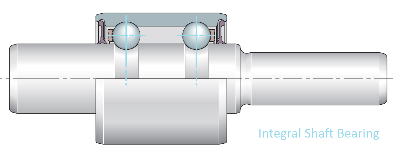

Post by everettdavis »
Just a note on Water Pump Style bearings:
The technical name would be Integral Shaft Bearings and they are lubricated for the mechanical life of the bearing.
Nick Engler, formerly of Shopsmith, once tried to press one apart without any success. The construction cross section illustrates why they are not serviceable at the end user level.
Everett
