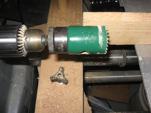

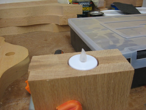

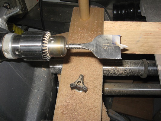

Making some tea light holders. Need 1 5/8 hole drilled in end grain
Cannot find a spade bit that size. Forstner bit does not work very well.
So, drill with 1 5/8 hole saw, and cleanup with 1 1/2 spade bit......
