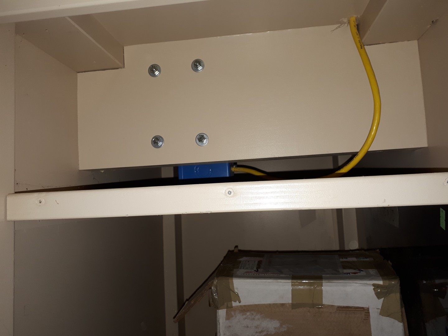

mountainbreeze wrote:Ron,
How is the planer mounted to the cabinet?
I can't see through the front door, the cross piece the motor is mounted to is in the way. and to get to the back door would require major reorganization of the shop.
planer cabinet inside front.jpg (151.26 KiB) Viewed 2249 times
That said, the planer sits on the top of the cabinet, and I presume it is bolted from underneath using the holes where the clamp handle that normally holds it to the way tubes would go.
