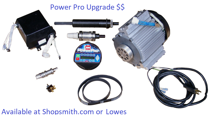

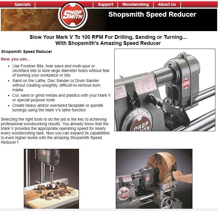

Apart from how to build the watch discussion above, you asked if you could swap the motor for a lower RPM. The Shopsmith drive mechanism uses a special extended length shaft and a mounting not present on other motors.
There is a somewhat expensive upgrade to the motor / drive system that would give you the slow speeds, and the torque through all the speed ranges but likely not in your budget, though an amazing upgrade.
556177 Do-It-Yourself PowerPro Upgrade Kit ... $1,689.00
Look at the the Shopsmith Speed Reducer which is more approachable and seems in line with what you want to do in turning.
555428 Shopsmith Speed Reducer $372.53
Occasionally, they come up on eBay but condition is unknown and warranty likely expired.
Everett
Shopsmith Speed Reducer.png (421.05 KiB) Viewed 7559 times
PP Upgrade.png (344.2 KiB) Viewed 7559 times
