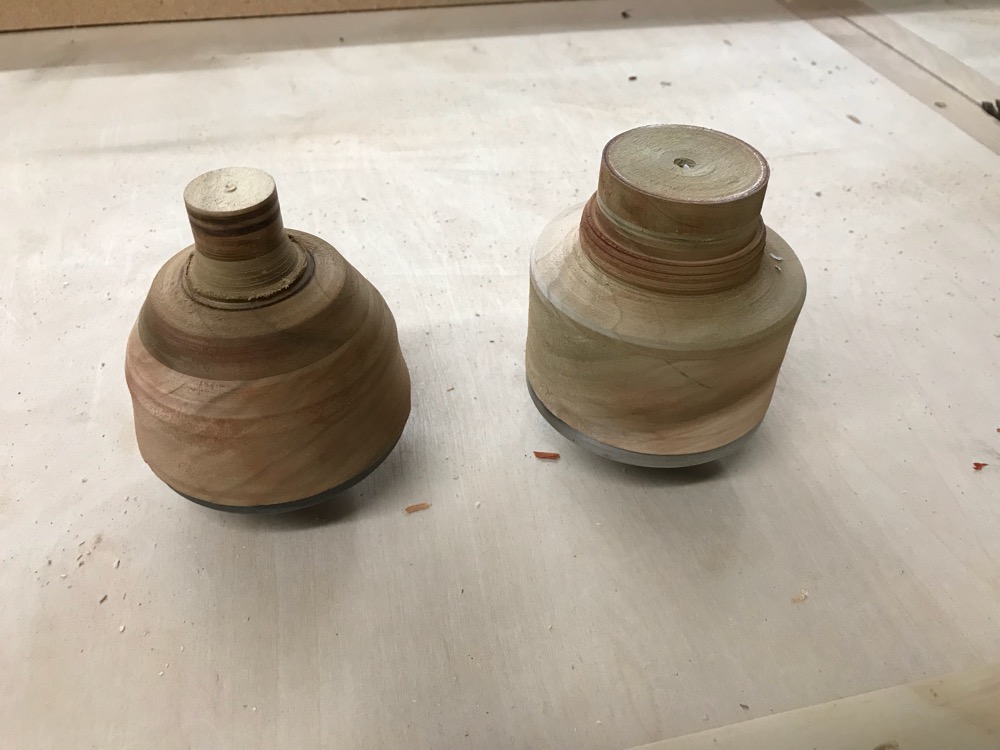

I have tried that method ( using a chuck ) several times and have never been able to make it work. I have watched several of the YouTube turners do it that way but the wobble seems inherent in trying to turn a long spindle like object held at only one end. Here is the method I use. After drilling the 1 5/8 shallow hole in one end and then the 15/16 through hole I use a 15/16” jam chuck at the end that has the 1 5/8 and 15/16 hole and a live center cone at the other and turn just the lower body. That makes it simple because you are doing spindle work between two centers. I use another jam chuck at 2 1/8 to turn the top and use a screw through the 7mm hole to hold it on the chuck. To make that work I drill the top blank with a 2 1/8 hole 1/2” deep and then finish with the 7mm bit. This method also makes it quick and simple to fit the top to the lower body because you can remove the lower body quickly to test fit the shoulder you turn on the lower body to fit the 2 1/8 hole you drilled in the top piece. Once you have them fitted put the top piece on the lower body, use the 15/16 jam chuck at one end and then the cone live center in the 7mm hole and finish the turning. Hope this all makes sense. Once you have the two jam chucks made it all goes very quickly.
Paul
Paul
- DD32C2BF-E398-488B-8A78-3EE9CBFE74A4.jpeg (135.73 KiB) Viewed 13952 times
