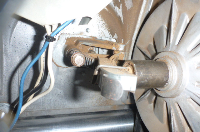

After using my SS all weekend long it's developing a howl. Not sure which bearing, it's coming from the belt side of the powerhead.

How does my speed changer look?
Any other things I need to know/have before I dive in?

- P1050069.JPG (146 KiB) Viewed 7892 times

Howl????
First thing I would do is blow that fine dust off the speed control parts.
THEN apply some oil to the control sheave bearing(the one in the pix with the loop).
Let it soak in.
Then see if the 'howl' has changed.
IMO, sealed bearings make sense. But then none that I have replaced have 30 years run time(yet).
A better way to get oil in the control sheave bearing is to profusely get oil into the hole in the control sheave, raise to vertical and let the oil migrate to the bearing overnight.(thank you Bill)
Large hands - get a 'zoom spout' oiler.
Let it soak in.

I've never dropped the motor. But I have zoom spout oiler.
I think there's too much sawdust to say anything about the condition of the speed changer from that photo. After you blow it out and oil it, you'll know if it needs other work by how easily it changes speeds when the motor is running.
You should consider watching the old Sawdust Session videos on the Shopsmith website. There are several showing everything from routine oiling to changing the speed control to doing a near total tear down and rebuild on a headstock.
Jacob Anderson has some good maintenance videos on Youtube that will also show how to do this and other maintenance jobs.

As part of your diagnosis, walk the belt off the motor, then listen to the motor alone. Helps identify exactly what is making the howl.
