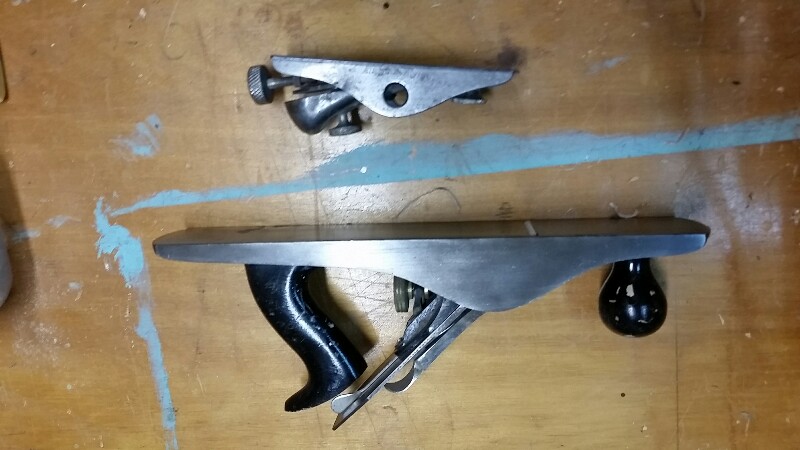

I went with 2 basic new planes, a #4 Buck Bros bench plane from HD and a Stanley 12-920 block plane. Both are my first planes. They both cut ok out of the box but clearly needed serious tuning.
The block plane wouldn't cut evenly and the bench plane chip breaker was always clogging up. The block needed significant filing to level the thoat opening. The bench plane chip breaker needed sanded to sit flush to the blade surface. Both plane bodies needed light sanding to clean up the machining.
I spent 2 nights on each and completely disassembled both. I adjusted, sanded, sharpened, and filed them. Watched a lot of YouTube. Each took several iterations of disassembly, adjustment, and reassembly. They now consistently cut well without any fuss. I use them both regularly and am happy with both.
So the pro of this is I learned the ins and outs of the 2 planes, how to set them up, tune them etc for about $70 all in. The negative is that they're not very good out of the box and take some time to set up. If you're not into tool setup and fidgeting, then a higher end or vintage plane might be a better fit.
