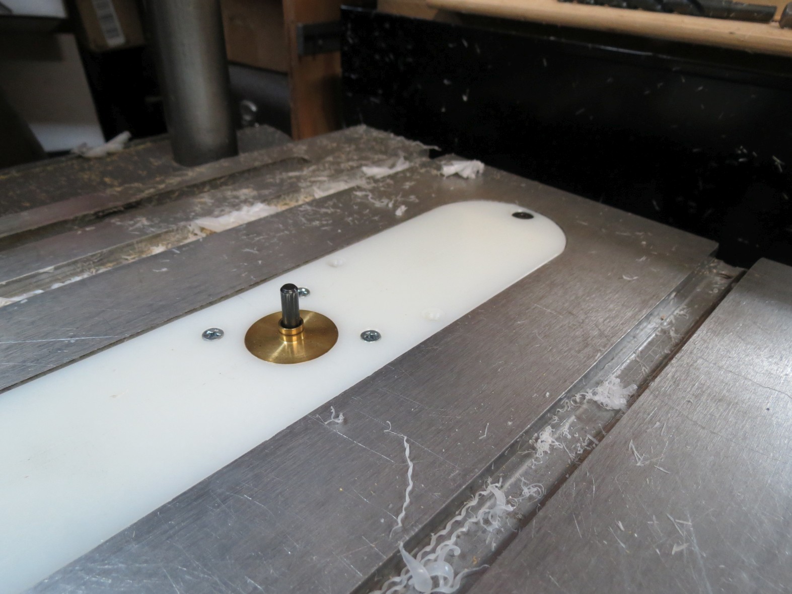

Dansmith wrote:Very cool. Is there any way to mount a router in the same manner as the rotozip? I also have the 500.
I don't think a full size router will work this way. I haven't tried it but gut feeling tells me you will not have enough room.

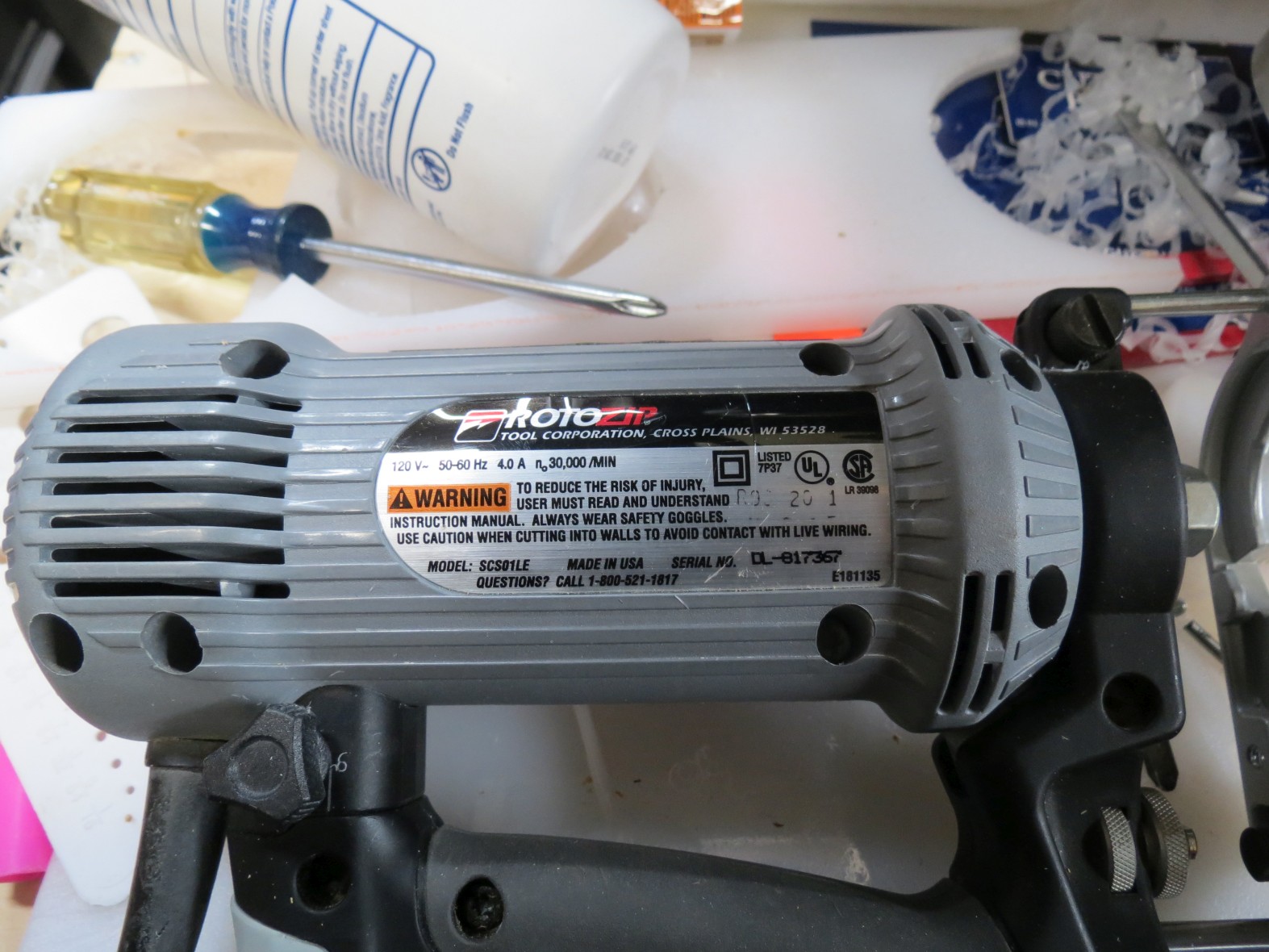

masonsailor2 wrote:That is very cool Ed. It might not have the power to tackle heavy stuff but it might be just the ticket for the smaller projects and might perform really well for box joints. How many amp motor is it ?
Paul
I would not buy a rotozip for this function, if you have one laying around then it does work but.....
Here is a picture of the label that has the model number and amp rating (4A). It is for reference only as you will see a bit later.

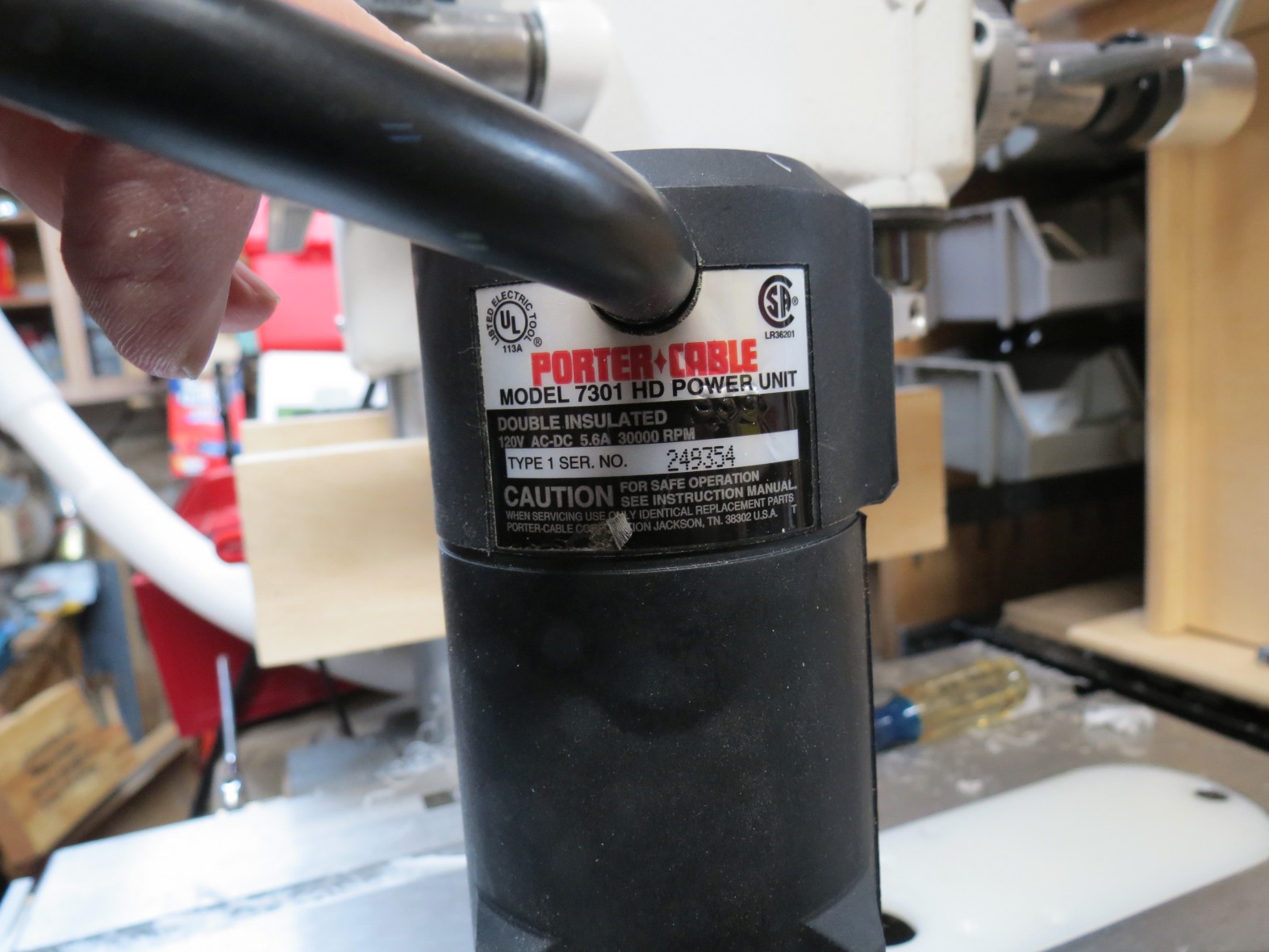

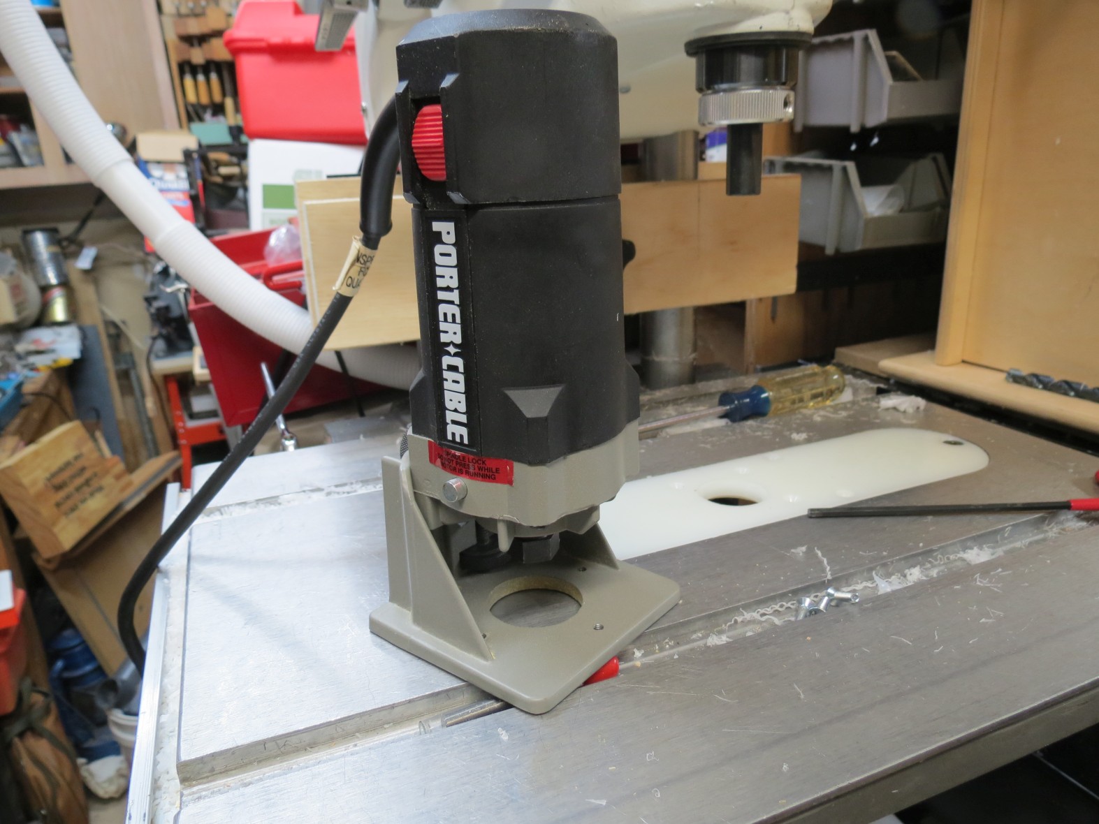

Version 2.0
I decided to mount my PC trim router this time. The sub-base has been removed for this mounting.
This is the data plate for it:

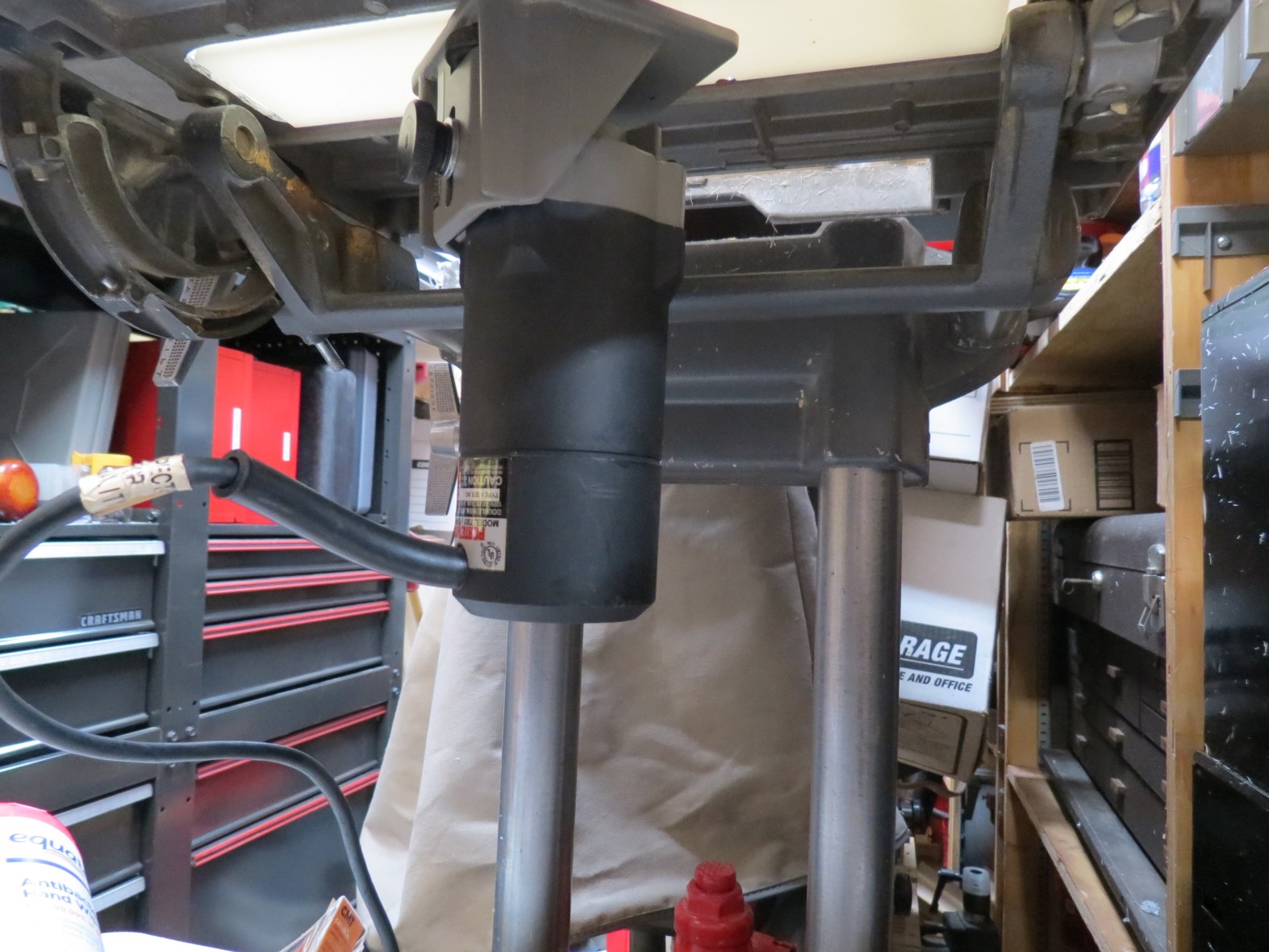

When mounted it looks like this from below:
From the top nothing looks different except for the three new holes.
This change has been a major improvement. So much so that I will now start a new thread to show another function of this adapter, so I'll link it later just in case they get lost from each other.
