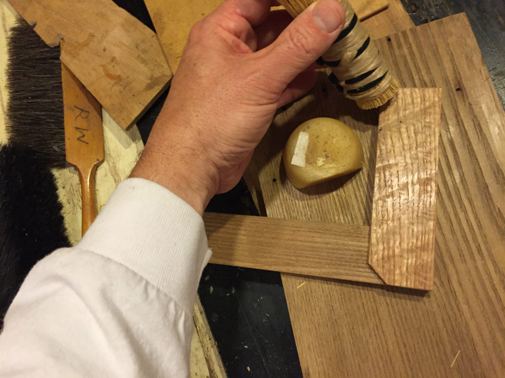

First up is a "polissoir" application of hard beeswax on wood. I'd mentioned it on another thread about a month ago. The broom-like polissoir, covered in some revived antique woodworking texts, applies enough burnishing friction heat to sort of "flow" the hard wax.
Small pieces for Squares.jpg (114.66 KiB) Viewed 23938 times
Beeswax burnished onto Square.jpg (134.06 KiB) Viewed 23938 times

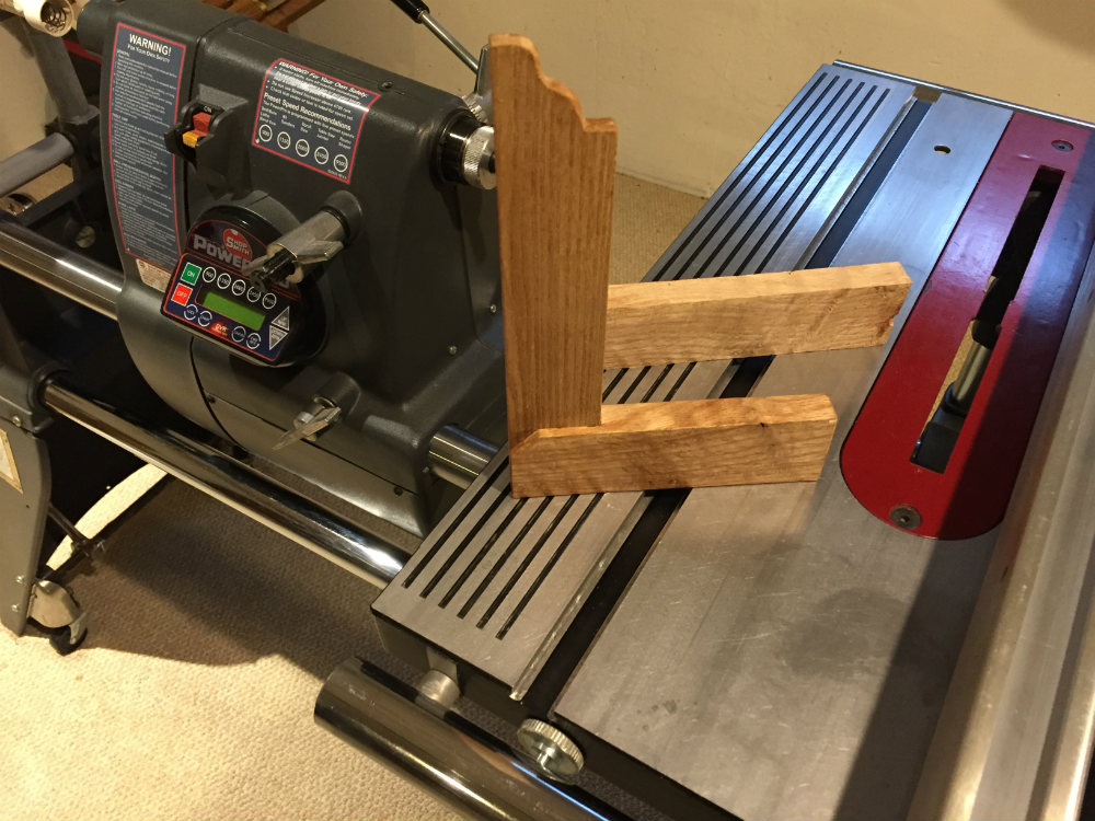

Next up is Microcrystalline wax... specifically with a low-VOC solvent. For this I think what I got would compete with Renaissance wax, but has much less smell. I used Paragon pipe wax. This is on all the Shopsmith tables and tubes now, and really has a nice sheen and smooth feel, and has a great resistance to fingerprints. It seems so nice and benign, I even put it on my control-buttons:

That 'polissoir' was some broom straw cut out of an old whisk broom, and lashed up. Some folks online are arguing that a softer hedge is more historically accurate than straw, maybe not as likely to scratch softer woods.

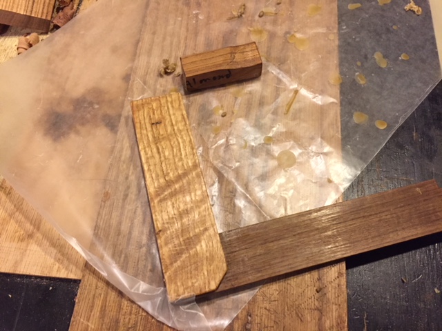

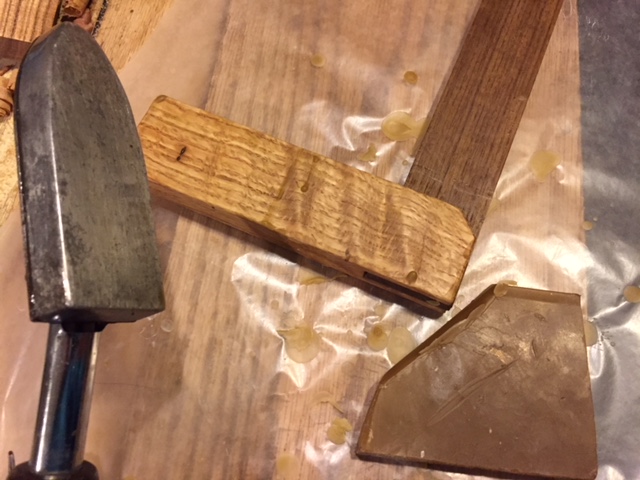

Here is another trial of a beeswax application, which I saw on donsbarn.com . (He was a Smithsonian conservator, etc.) This is a bit better than the cold-burnishing for filling grain.
Another little square I made is coated with melted beeswax, using a small tacking iron:
Hot Wax.JPG (111.2 KiB) Viewed 23483 times
The excess wax is scraped away gently with non-burred scrapers or small blocks of hardwood:
Scraping Wax.JPG (117.64 KiB) Viewed 23483 times

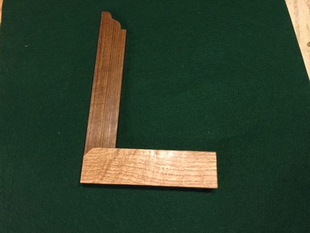

Then it is buffed out. A nice, hard, glassy, fun to hold finish; definitely more striking than a paste-wax result:
Buffed Out.JPG (81.41 KiB) Viewed 23483 times
