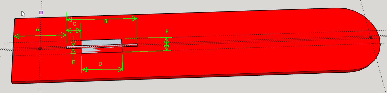

Anyone have the 555518 Blank Saw Insert
Item E found here:
http://www.shopsmith.com/ownersite/cata ... nserts.htm
I'd like some measurements off one if you could. See the image below for what I'm looking for.

I have used one as a pattern for making inserts for a while. The wider section is for the pawls to be lower than the table height. I do not always cut this section out if I am planning on using the insert with a riving knife.
A. 2 7/16"
B. 5 9/16"
C. 1 7/16"
D. 2 5/8"
E. 1/8"
F. 5/8"
Brenda
1998 bandsaw
2016 beltsander
jointer
overarm pin router
Re: Anyone have the 555518 Blank Saw Insert
Thank you! I'm doing a sketchup drawing of the part but I don't have one so this is a big help.
