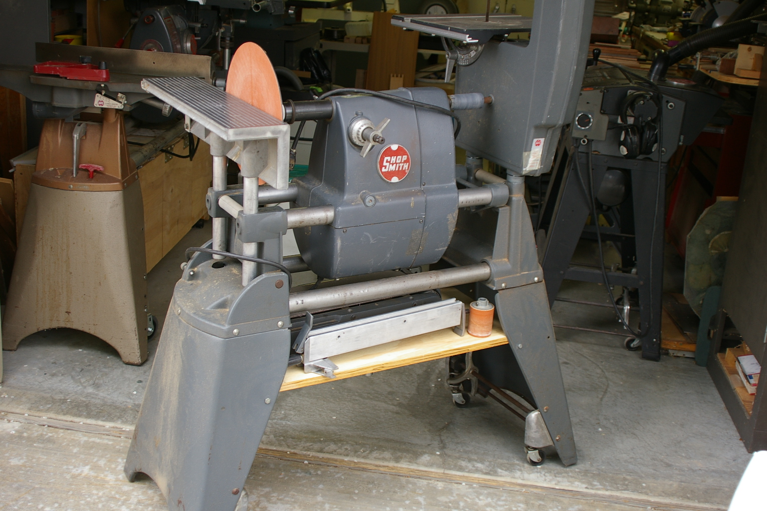

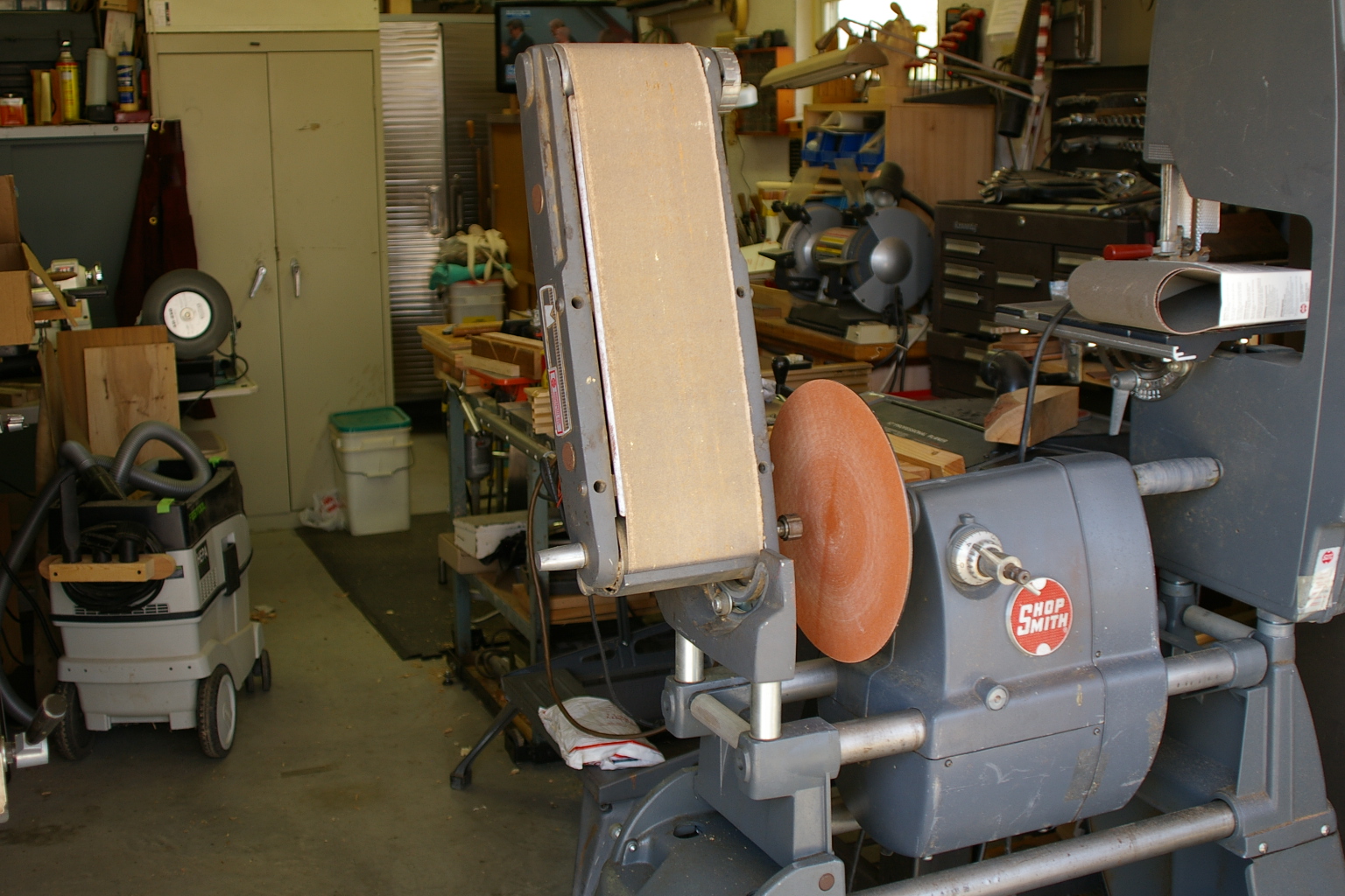

update: I think I have pretty well completed what I intended to accomplish today which was a band saw sanding station. I could also swap out the band saw with the jointer. I need to work on the shelf a little but other than that, pretty much done!
Don G
Don G
- IMGP0023.JPG (761.9 KiB) Viewed 10495 times
- IMGP0024.JPG (765.85 KiB) Viewed 10495 times
- IMGP0025.JPG (732.63 KiB) Viewed 10495 times
- IMGP0026.JPG (780.41 KiB) Viewed 10495 times
- IMGP0027.JPG (769 KiB) Viewed 10495 times

Band saw, jig saw, scroll saw - all would be usable.
Oh and a strip sander, air compressor - just about any thing else(doubt a planer would work).

Does the bandsaw and belt sander fit onto the 25 5/8" top tube length with factory couplers? I've got it mocked up and it looks a little tight or not fitting by ~1/2". Looking at your picture confirms my concern that it's tight.dgreen810 wrote:...band saw with the belt sander combined with the disc sander.
- shorty BS-BS.jpg (761.9 KiB) Viewed 9762 times
