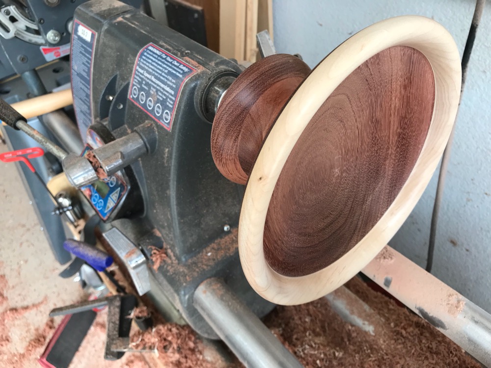

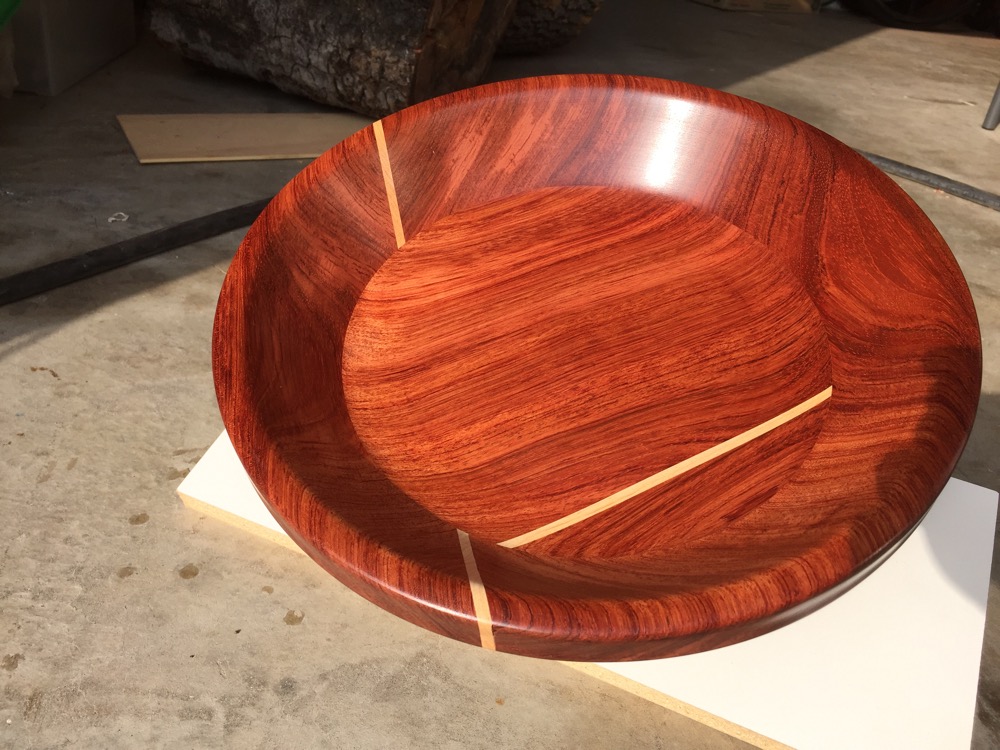

Yep. I had it up around 2000 rpm when it decided to take a cruise of the neighborhood. What I meant by going slow was the cutting angle/depth. The trouble with bubinga is that you get a nice shearing action on the long grain and then as the end grain comes around the situation changes and you can't keep up that depth of cut even with a razor sharp chisel. So you try to keep the cutting angle high so when it hits that end grain it allows the chisel to pass through it and not dig in. But then you make one little itty bitty mistake and pow. Very unforgiving wood. It is so hard it is brittle. The end grain is like concrete with a wood grain in it. I have turned it once before so I knew I was in for a treat. It's hard to even cheat and use abrasives because it doesn't sand real well on the end grain. Beautiful wood for furniture though. The next time I decide to turn bubinga I will make it a segmented bowl which makes life a lot more pleasant.

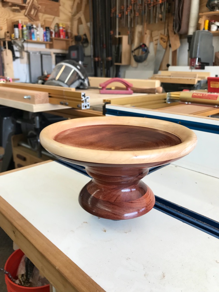

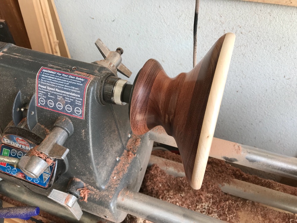

Well the roughed out bowl had sat around enough and I decided it was time to finish it. To prevent any more grabs I finished it with various size straight and round nosed skews. Interesting that the big grab I had on this bowl was back in Sept. It bent the SS arbor so bad it was not usable. I ordered another quill assembly back then and have still not received a new one. They have been on back order for 8 months now. Wow.

In normal situations you are correct Mike. Unfortunately bubinga is about the hardest wood I turn. Although technically harder even ebony is easier to turn. The entire bowl was done using a set of modified screws which gave me a happy medium between shaving and scraping. Bowl gouges are too difficult to deal with when turning wood this hard. Fortunately it is a very shallow vessel so they worked. Any deeper of a bowl would probably prevent the use of them on the inside. I have been resisting carbide tools but if I ever turn anything this hard again I think I will give them a try.

The trouble with bubinga is it is enticing due to the amazing color and grain but it’s like turning concrete with wood grain in it. It polishes to a metal like finish with that amazing red color. More like grinding than turning. I have only turned it once before and it was a large platter which was the same challenge. That bowl was the last of it so it will be a long while before I turn it again.
